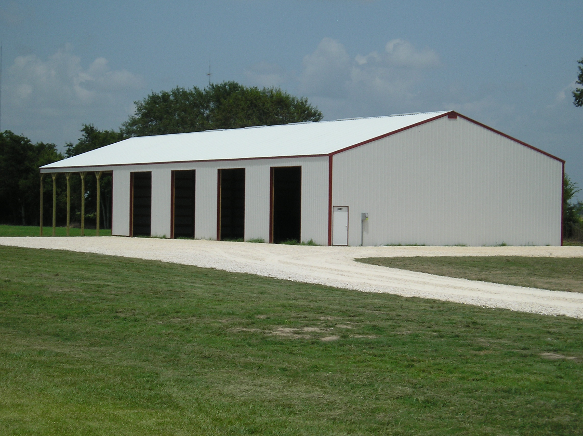

I can relate to several things mentioned in this thread. I just built a new hay barn as well. 50x150x16 with 100 of it closed in. For square bale Bale BandIt bundles inside and 4x5 rounds outside. I bought 250 plastic pallets (used) from a shipper near New Orleans and I put that under the bundles and rounds. Used wood pallets for years but they rot and break up fairly quick if you handle them alot. Besides they are getting real heavy in my old age, too. I am glad I use pallets because at the last minute before construction began I got spooked about being too close to a fence line and moved the barn over 20 feet. Dummy me, didn't realize that put me off my crown. After putting a gravel pad down, the floor on the door side of the barn is low and water comes in. I had to make a ditch in the barn to drain water out the end! Now after I sell down the inventory, I will be hauling dirt IN the barn to build up the floor. Down here, concrete is expensive and it sweats from humidity in the air even with a moisture barrier so you still have to put hay on pallets. If you use gravel and a horse customer finds a rock in the hay, it's all over.
As for tarps, I use old vinyl billboard tarps. There are several advertising companies that sell them around here. I can get a 28x56 for around $50 . They last a couple years so they are a bargain in my opinion compared to Tractor Supply and Farmtek tarps. They will sweat so it's important to leave about a 2 foot section of exposed hay all around the bottom to minimize mold, especially on the top bales. Regardless, some bales do get bad no matter what you do. I think that is just an occupational hazard of using tarps in my opinion. I will continue to use them when I have too only because there is a solution that is cheap and readily available for me.
