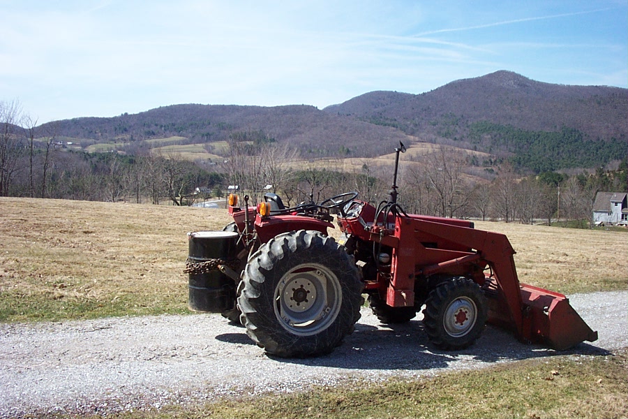

Try using the search feature, there have been a bunch of nice weight box ideas on TBN. Myself, I just used a steel drum, cut a couple of holes through it about a third of the way down the barrel, an got a steel rod that runs through the barrel, filled it with rocks and concrete. Its not really pretty but it does the job of adding weight when using the loader and durring the winter months...:)
