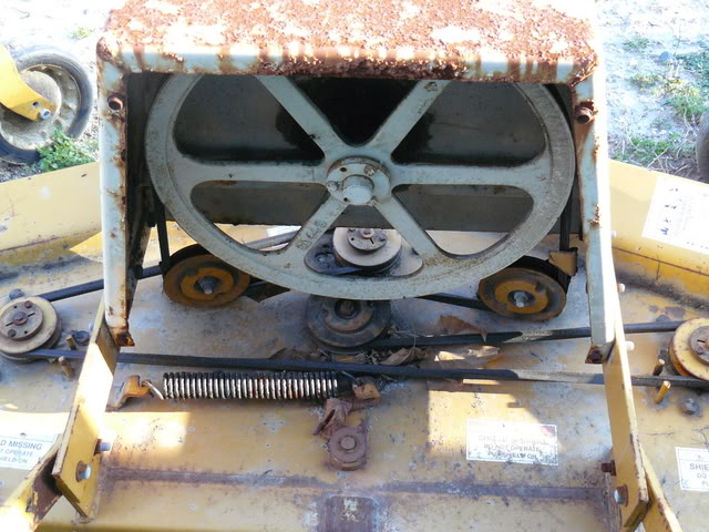

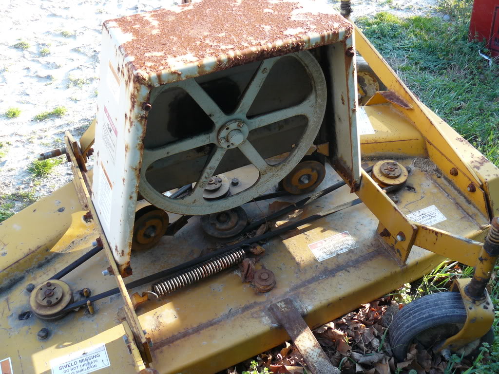

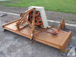

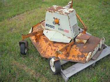

Back to your no-gearbox belt drive mower idea, there used to be many more of these around. They seem to be out of style now.
Bruce
