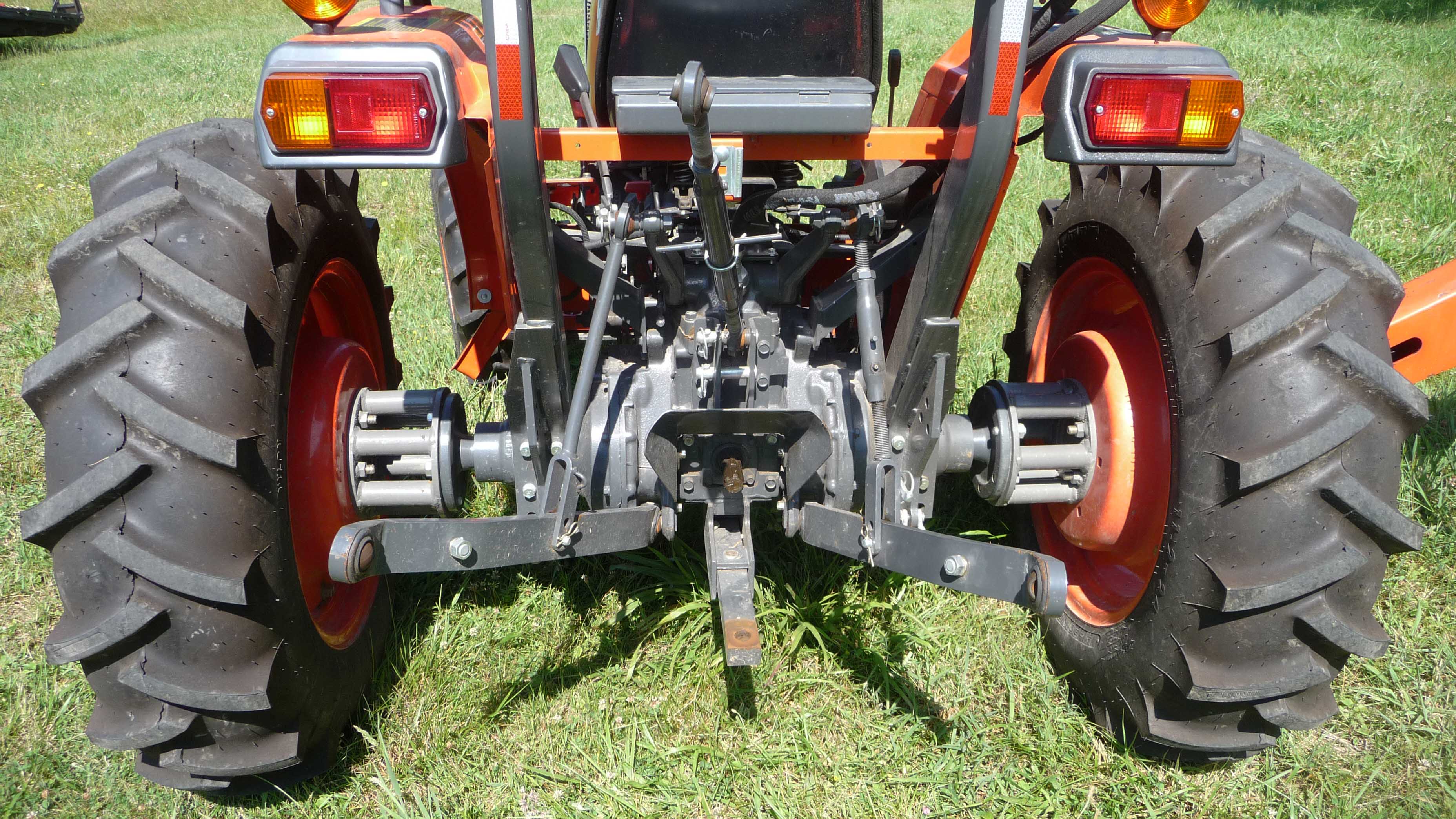

I have L3800, 2013 model. It wants to roll over, I have been on 2 wheels and almost on one wheel one time with it. Tires loaded, wheels set out. I WANT DUALS ON THE BACK, but have no idea where you get hardware like I see in the pics. Is that set of rims specially made to be dual with those clamps grabbing on that ring. Where in the world do I start? Craigslist?
Can it hurt the axles having duals on because of the leverage of the longer axel that is in effect created by the outermost wheel?!! Either way, I am brush hogging just north of WV and it's dangerous and I want to not be in fear the whole time. Should have bought a M series with widen-able axles or whatever, but money is tight, and I will have this tractor forever.

Hey there KGW, when you are between Waynesburg and Elkins using I-79 at exit 110 you are a stone's throw from my farm. My pasture renters have an L3400 for which they bought rear wheel spacers at a dealer. You could get a good machine shop to make you a set too. Neither is cheap. See photo below. I don't feel there is any really effective way to improve rollover resistance other than to get the rear wheels out wider. I don't care for duals either as that is expensive and makes the vehicle "awkward" from my view. My feeling is if I'm anywhere even close to tipping the thing it just is NOT worth my life. I stay off that slope. P1180900smaller.jpg
