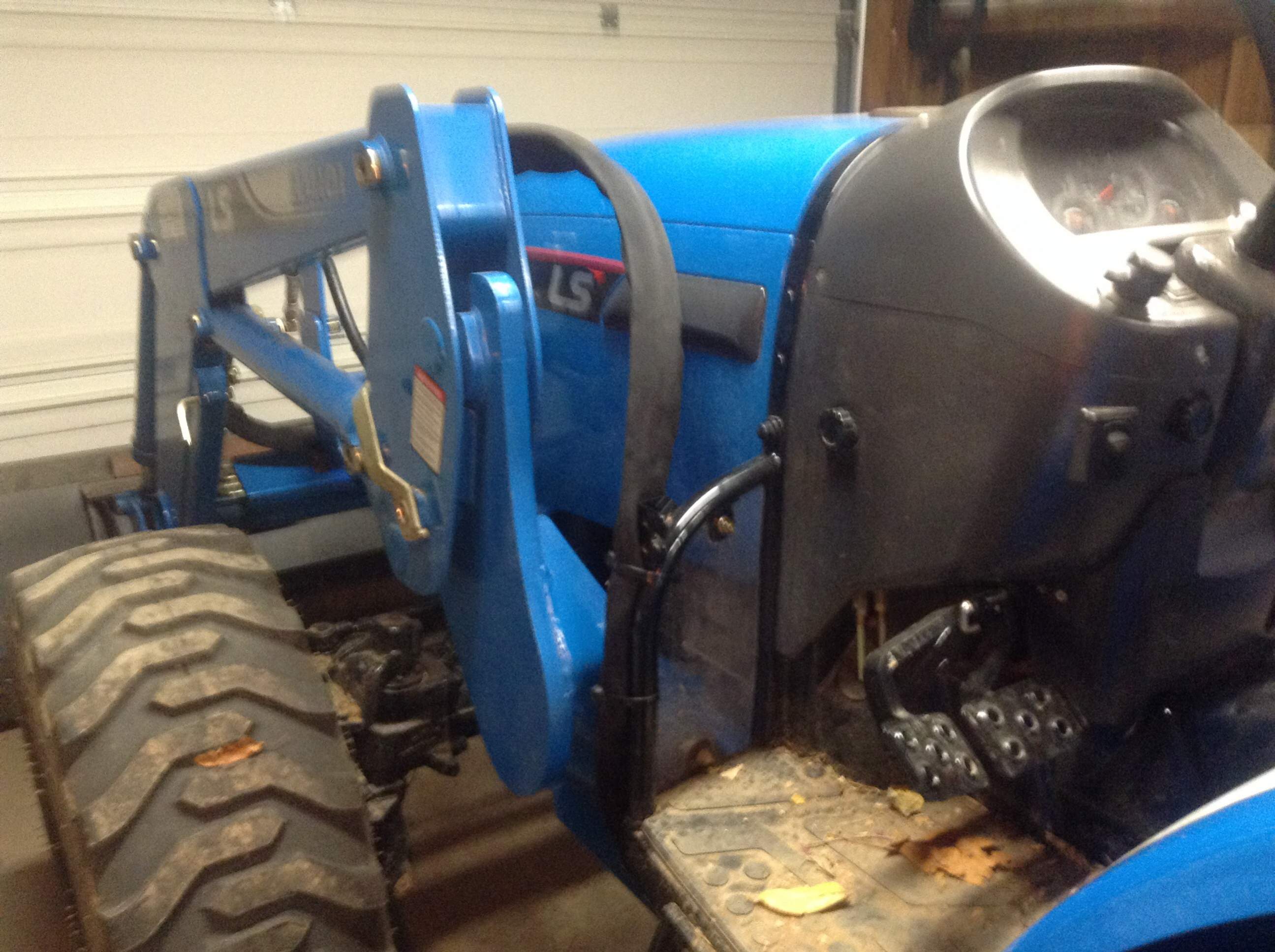

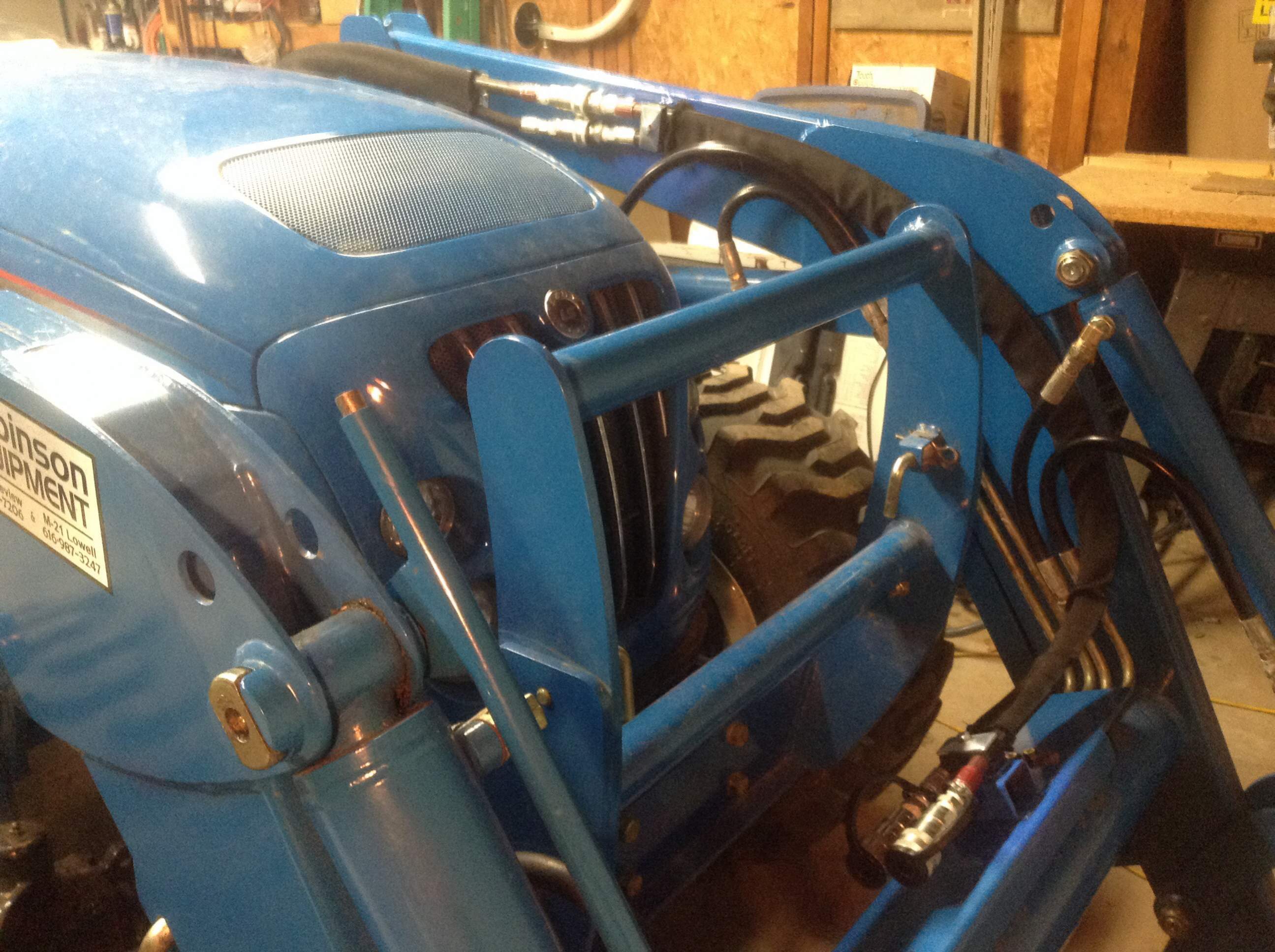

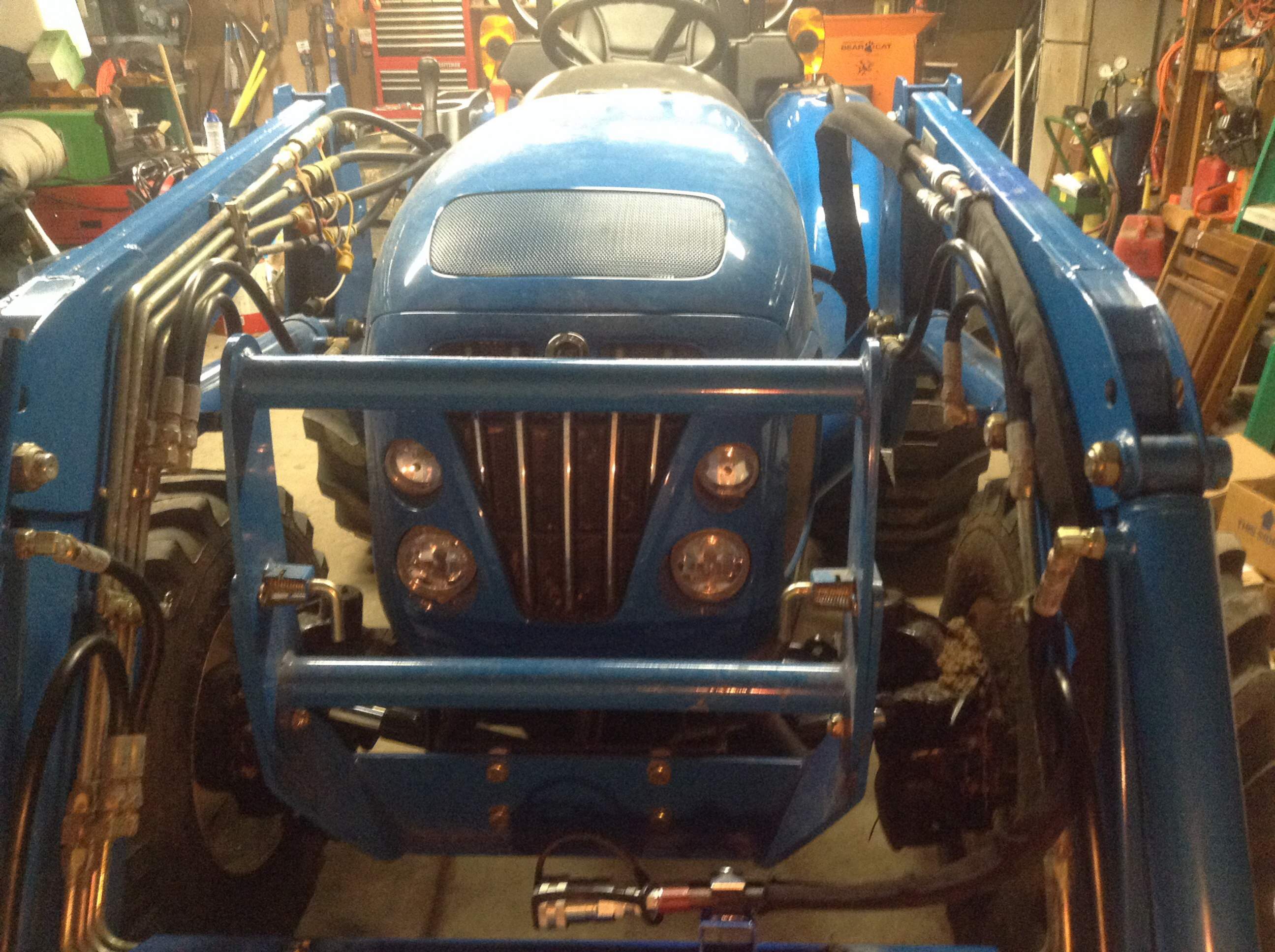

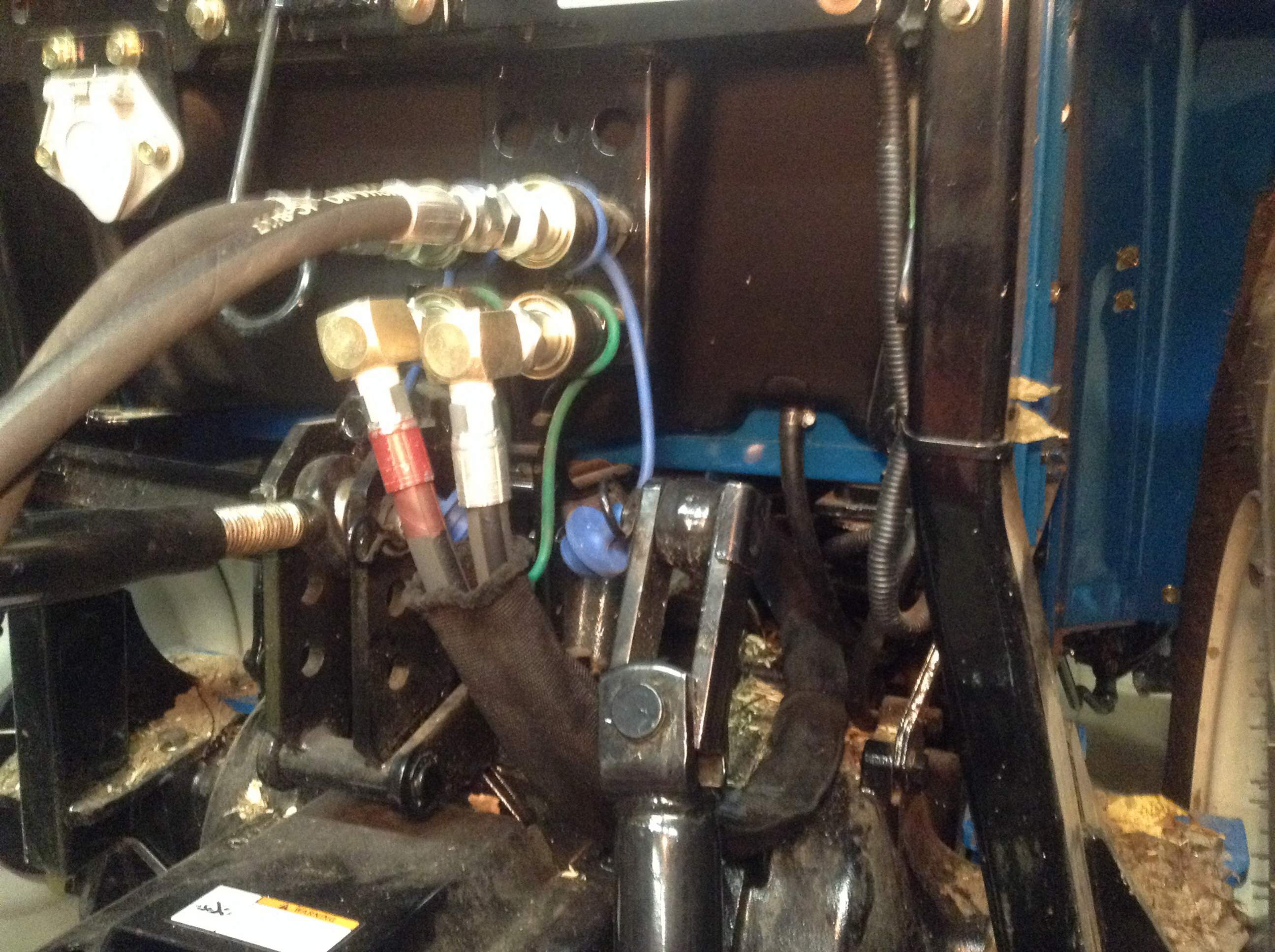

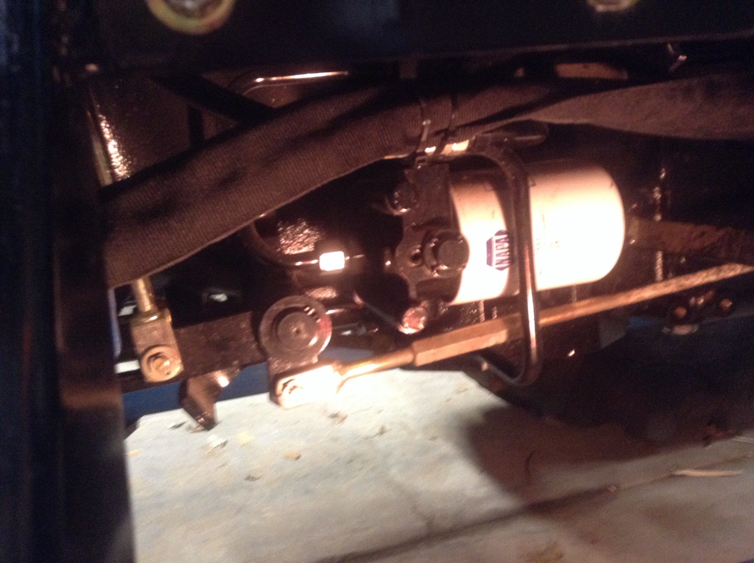

I routed hydraulic lines from the rear remotes to the front of loader over the top of the differential and up the left side of tractor. I had two 130" and two 48" L x 3/8" Hyd lines made and it fit perfect! There is a lot more room on the left side. I found 15' of hose protector sleeve at TSC for about $15 and sleeved the total length. I used 3/8" couplers in the middle on the loader arm and 1/2" on the two ends.
Just thought I'd show how I did it. :)

That's pretty much exactly what I did except I looped up and over my top link and then ran down the left side. I also sued 1/2" couplers in the middle connection to get all the flow I could to the front in case I ever needed it for an implement. Thinking hydraulic PHD in the back of my mind.

What is the coupler in the middle for

I need to do something similar with my P7010C. I don't really want to drop $1000 for a electro-hydraulic 3rd function kit. I played around on Discount Hydraulic Hose and for about $200-$250 I can build a similar setup like you did. Originally I did not want to tie a remote valve up permanently with this setup, but heck, I have 3 of them.

That is a great install. where did you get those mounts at the bucket where the lines terminate
   / Ideas for Hydraulic Line routing......LS R4041 H
I got most of the fittings at Hydraulics Direct.com. The hoses I had made by the mechanic where I work.
Whoops! I was wrong CT, I DID get my parts at Discount Hydraulic Hose ,including the support clamps, NOT at Hydraulics Direct. Sorry for the confusion. :(
