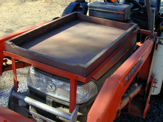

Here's my quick solution to hauling stuff around ... I can even get my 2kw Honda generator on it with room to spare.
Cheers!

Homebrew2
That is a great hood protector too, and has a tremendous capacity for hauling things.
At first I didn't like it, because it covered the hood which looks great (I like green best though /forums/images/graemlins/wink.gif ). But on second thought, it's a great idea. Especially for the woods trips where the biggest fear is the reality that something can come down on the hood to do some damage.
Great idea.

I like the hood storage. I considered something like that - looks like a great way to haul stuff.
