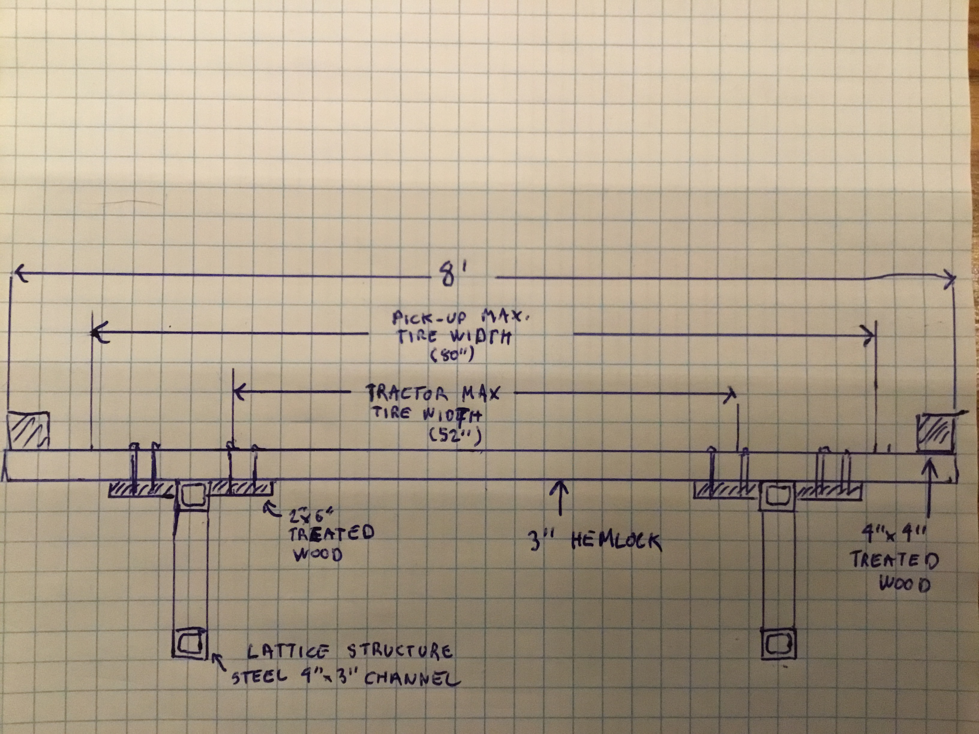

Thanks for idea, here (hand made) a view of the section of the bridge I have in mind. What do you think?
Piloon can you send me the contact info of the mills you have in mind?

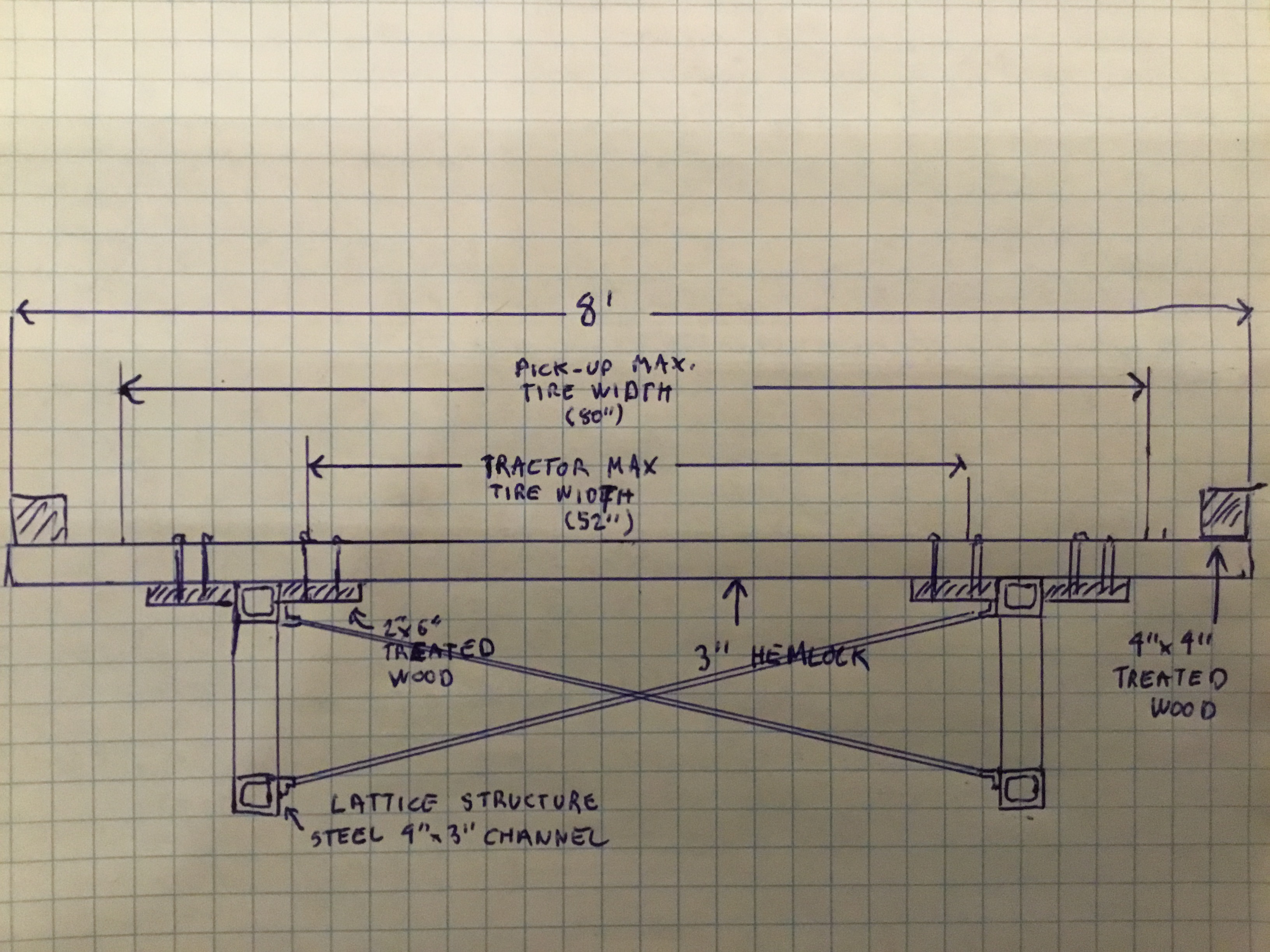

   / Idea for a Bridge deck?
Oups, forget one important structural detail!

How is the deck fastened to the frame?
