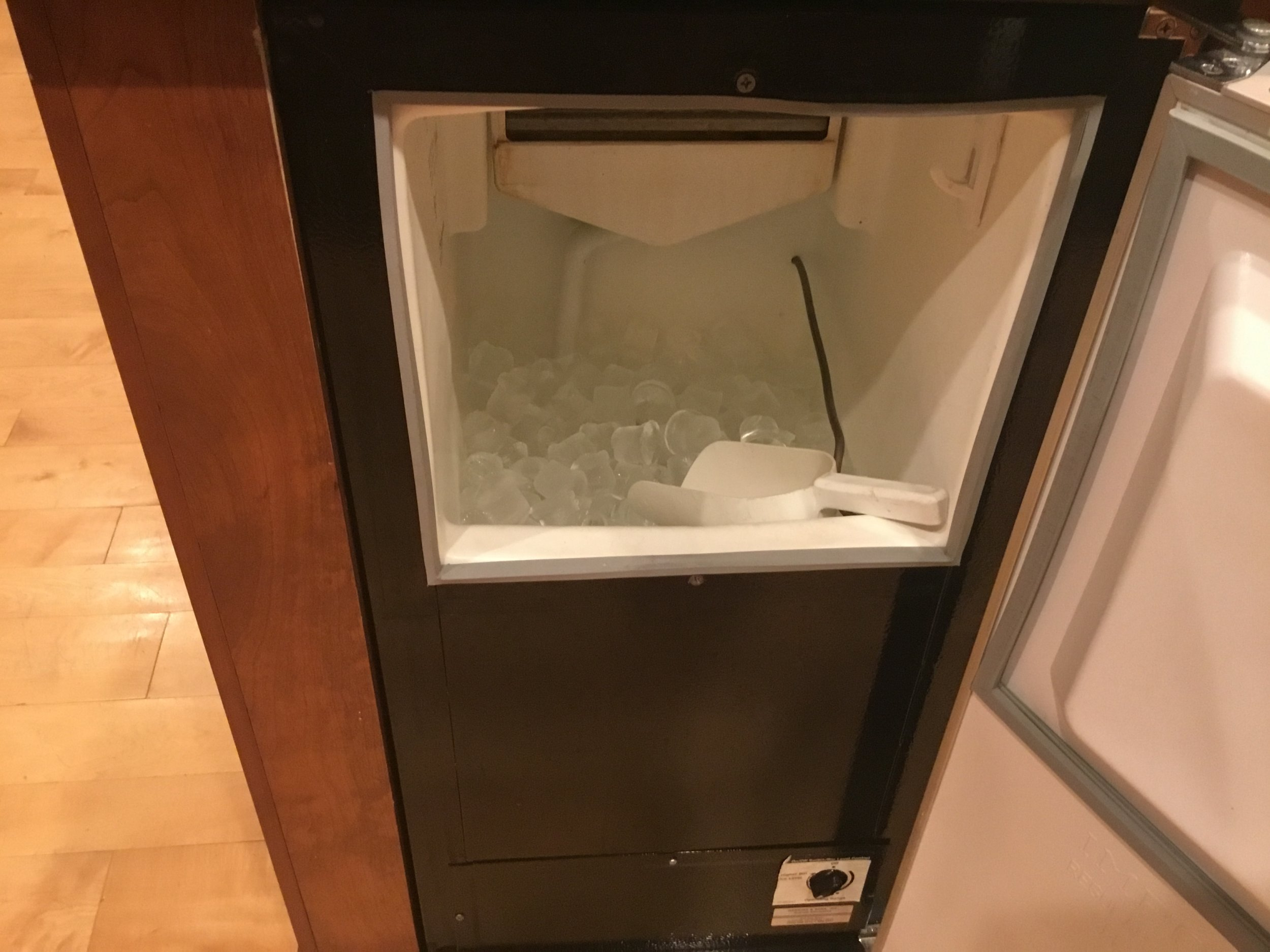

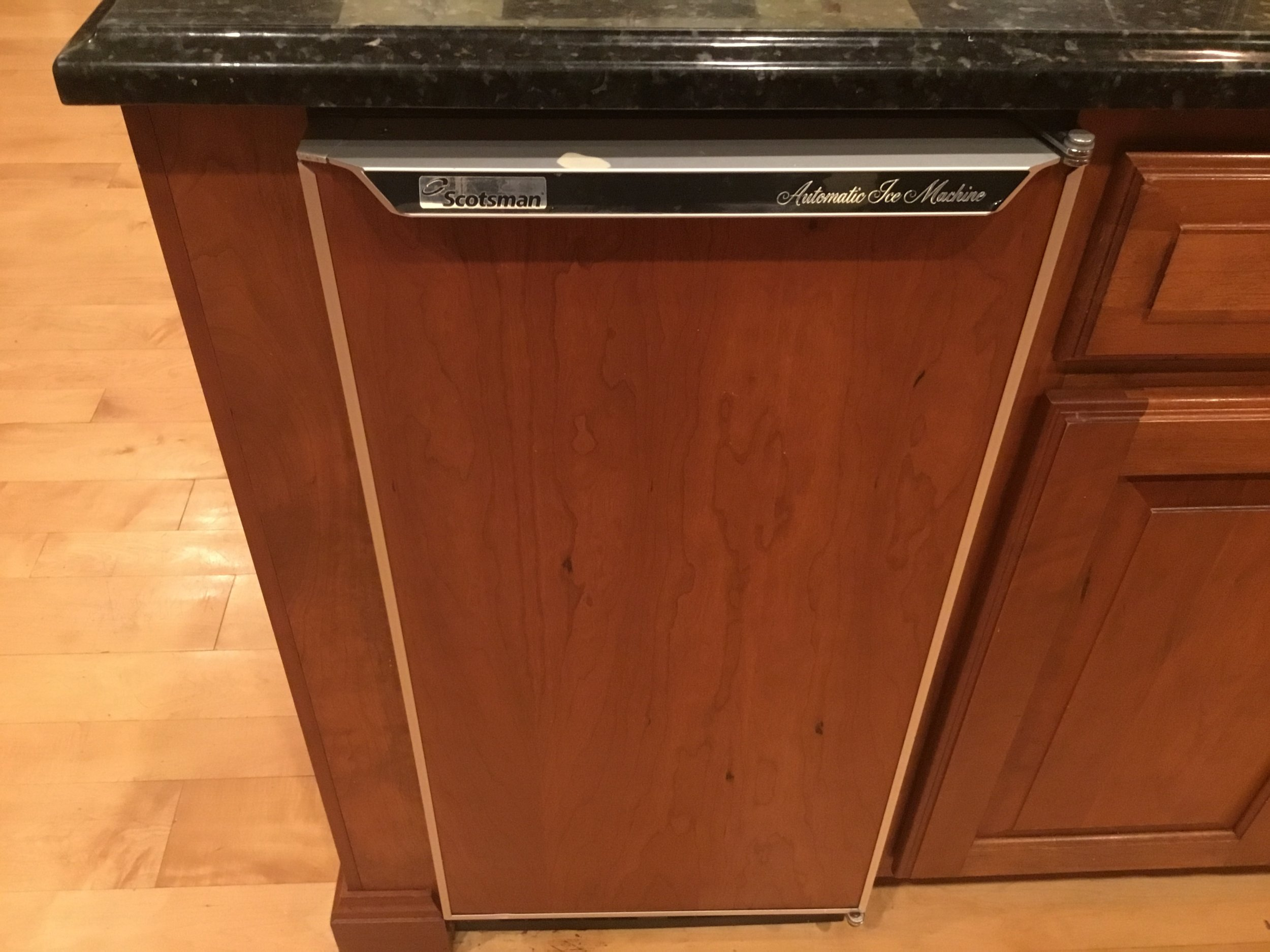

Have a Scotsman Ice maker in my kitchen. Love it. Makes perfect cubes for soft drinks, adult beverages or when one of the kids needs lots of ice for a bruise, or a cooler for sports drinks.
Generally, it works great. It happily harvests cubes.
However, once every few months, the cubes melt and it stops harvesting cubes. It won’t make enough cubes to keep the tub full to the point where it just runs and makes nothing.
I tried cleaning it and looking for anything, but there’s nothing obvious
Finally, I just began unplugging it for 2 days, then plugging it back in. It triggers something and it works again very well.
Any idea why it stops making cubes, then works again after 2 days of being turned off?

We didn’t have that brand, but had a large ice machine at the tennis club.
It started doing the same thing. Works well then starts to slow down and gets to a point where it doesn’t make ice.
Unplug - let sit a day - and it works again.
Turned out the mechanism where the ice discharges was getting blocked up due to a small leak when new water was pumped in to make ice. The leak caused a spray and over time that spray water iced up and blocked the discharge. The blocked discharge made the machine think it didn’t need to make ice.
Unplugging the machine caused the ice block to melt over time and all would be good until it slowly happened again.

Or the sensor or switch that tells machine ice bin is full?
/ Ice makers-anyone know them?

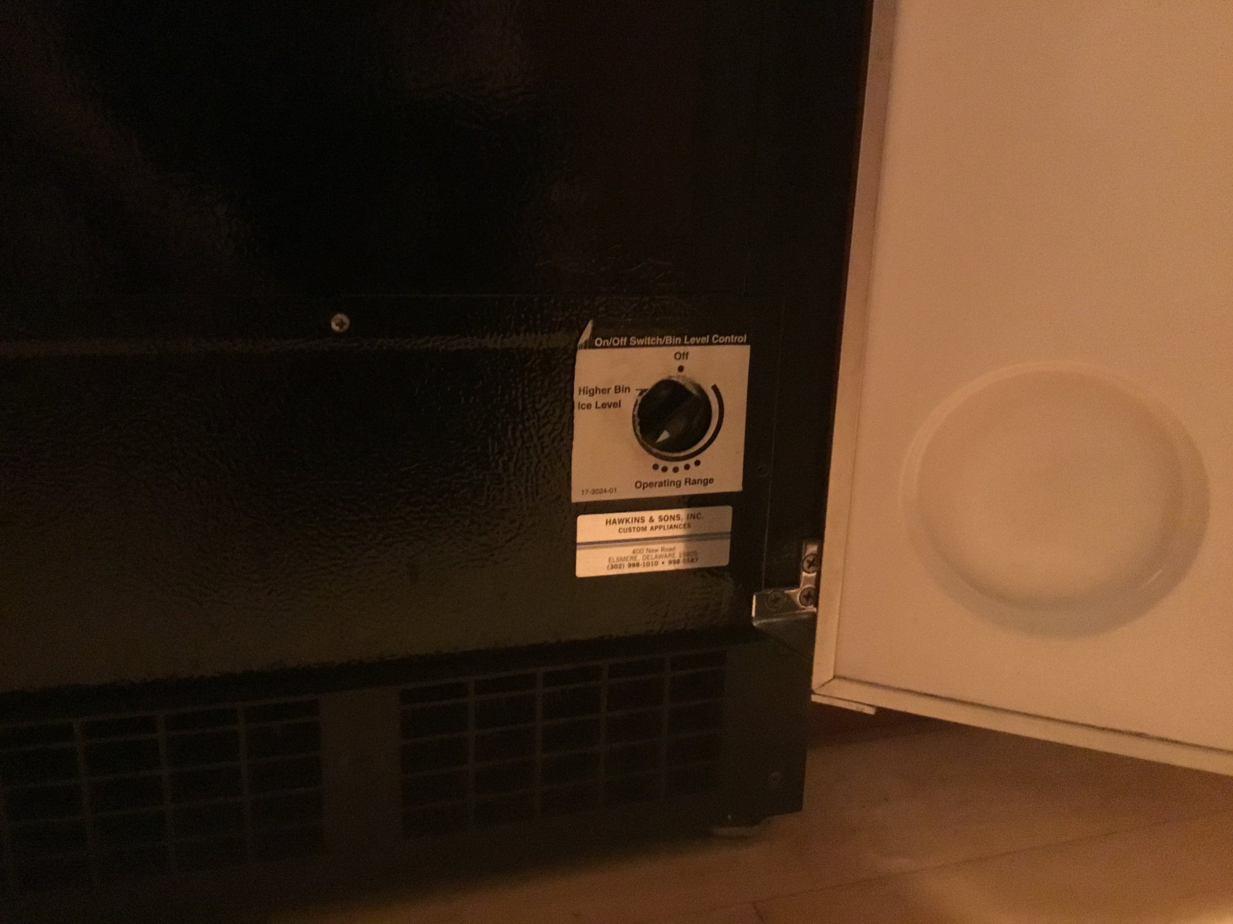

I don’t *think* there is one. The funny thing about this ice make is the cabinet is insulated, but only refrigerated by the ice and the ice making equipment itself. There’s no “duct” blowing cold air into the ice cube cabinet. The bottom cubes melt off and the water runs out in a tube into a drain.
There IS an ice cube level control knob
