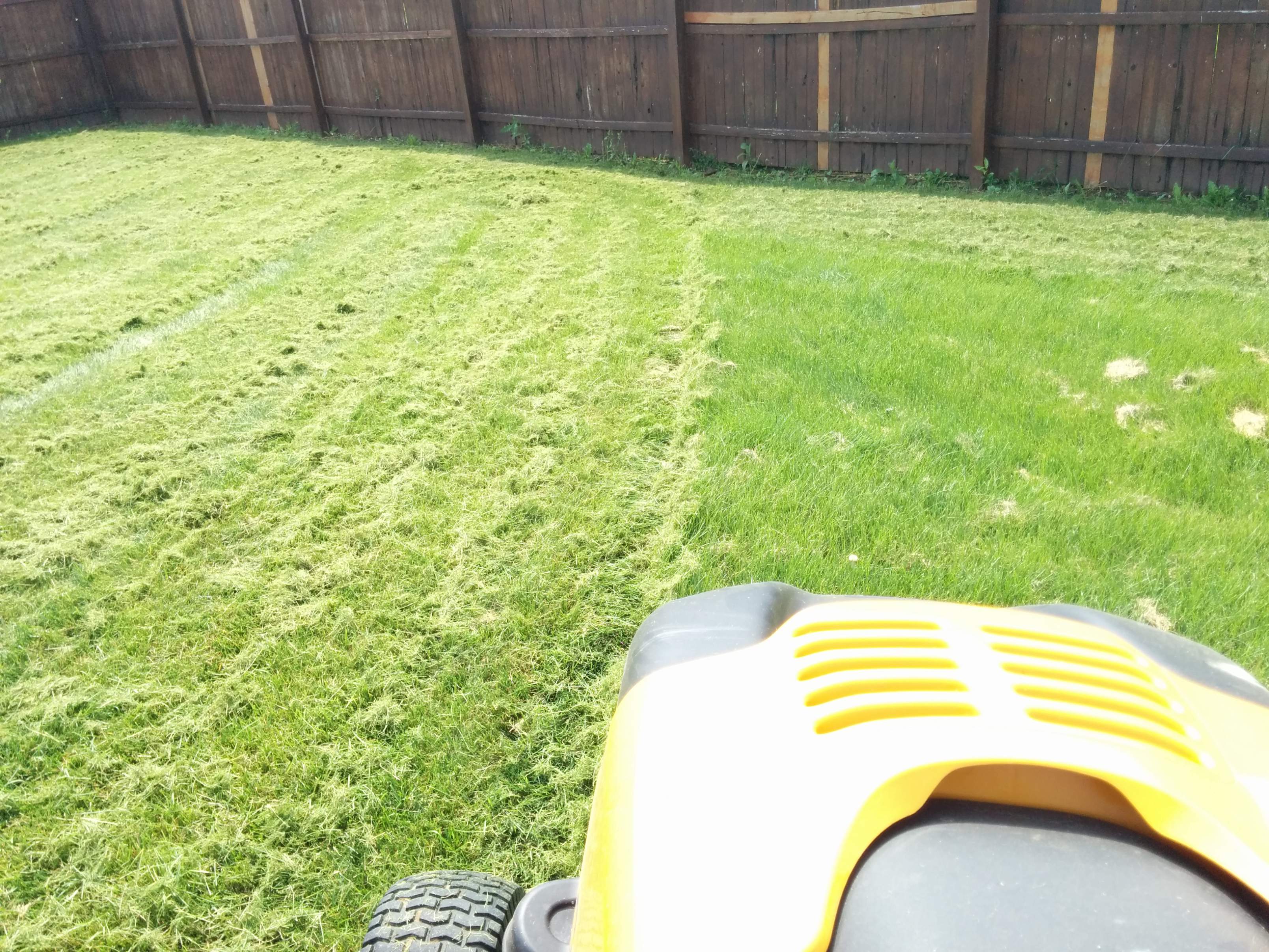

Im no expert, but i think my cub is mulching poorly...after 4 or 5 days between cuts, my lawn is too thick and the clippings just pile up. Im no expert, but i think my cub is mulching poorly...after 4 or 5 days between cuts, my lawn is too thick and the clippings just pile up. Is there something I can adjust or replace on the mower? Am I doing something wrong? Should I just buy a bagger?
I'm using an i1046 zero turn tractor. Is there something I can adjust or replace on the mower? Am I doing something wrong? Should I just buy a bagger? Just look at the clumpy mess in the photo.

some of these things you may already be doing... Full throttle. Only cut 1/3 height of the grass in a given pass. Cut only when grass dry (no moisture showing on fr tires). Slower ground speed (mulching speed is always slower than side discharge in heavy/damp grass). Blades/Deck sharp and clean (easy to clog if damp. Set of riser stands are very handy for quick underside chk). Properly leveled deck per manual.

One of the things I've learned is recognizing the type of grass you have makes a big difference in mulching efforts. A Kentucky Bluegrass as an example is much more dense than a Fescue or a Ryegrass . . For the same height. Mulching vitally depends on speed of cutting blades and spacing of grass blades and lack of water. So mulching a less dense grass doesn't hold moisture as much or slow the cutting blades down as much. Moisture and density slow blades.
What I'd look for or do is:
1. Look under your deck for buildup on the deck. If you have it . . take the deck off and clean the buildup off. Soak the buildup if needed. You want to see yellow paint everywhere.
2. Just like a car or truck . . Washing and waxing keeps dust and dirt from collecting . . so after cleaning the bottom of your deck . . Spray it with a Teflon type product like No Mow spray or other brands (available at TSC, Fleet Farm, etc. etc.) . The key just like waxing is 2 light coats not 1 heavy coat and let it dry well. This should last for most of the full season depending how clean you got it to start with. Incidentally . . spray your mulching plug too and the area around the blade spindles. Also while deck is off is a great chance to grease the zerks under the deck. Every way to reduce resistance and keep blade speed up makes for better mulching.
3. If you have a dense grass . . then dry grass needs to be DRY grass to get a best result. And if your goal is a grass cut at 2.5 inches . . and your grass is 5 inches when you start . . either slow your forward speed or double cut . . because proper mulching takes power. If the grass is higher than 5 inches . . you'll need to double cut at different heights.
4. I had one lawn that had a lot of weeds in it. Weeds hold more moisture than grass.
5. I have an I1050 and it does a good job mulching . . however make your judgement after 24 hours . . because mulching requires the "mulch" to drop into the dirt. Normal discharge cutting wipes the grass away so it looks clean . . mulching depends on absorbing it away . . So it won't immediately look as clean but 24 or so hours later it should be much better.
Of course the above assumes your throttle is set to full . . Your blades are mulching blades . . and sharp . . and your engine is running smoothly and you are using "water free" gas . . either non ethanol or using a gas treatment and plugs and carb are clean.
Hope this helps.

I'd make sure the front of the deck is lower then the rear by about a 1/4" and otherwise you are cutting quite a bit more then 1/3rd the height. I know I'm on a 3/4 day rotation for mowing and by the 5th day mine is also bunching.
