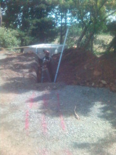

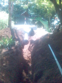

2 more for your viewing pleasure. The house feed with a pipe being lowered in place, and the barn feed with the child unit digging out a chunk of steel from the dirt bank. House is 60 ft the barn feed is the rest. Next is building the vaults then finishing the genshed. following that is the conduits and pipes being installed in the culverts.
If the culverts were heavier, I would have to use the FEL. But that would take at least another person. From the BH seat, I can see into the hole enough to position the pipes myself.
The good pix are still in film format for inclusion in the record book I am putting together for future owners (and myself... now where did I bury???)

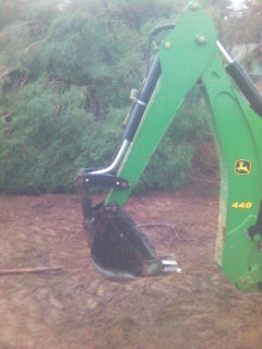

Interesting turn the thread has taken. I will give my reasons for my purchase of the 448. I want one power plant to maintain. There is no doubt that with todays market you can latch onto a construction hoe reasonably. If I was using the hoe once a week I probably would have gone that route. But why take up that much more yard space, have another engine to maintain and the issues surrounding a used machine.
I still think that the 4x20 could carry a larger hoe than the 448.
You can't get much simpler than the mounting arangement JD has with the rock shaft mounting. I'm down to under 5 minutes for either mount or dismount including the 3 pt arms. I've operated 3pt mounted hoes. No matter how much I tried to tighten them up, the linkage moved way too much and shock loads the whole tractor.
Have I had issues?
