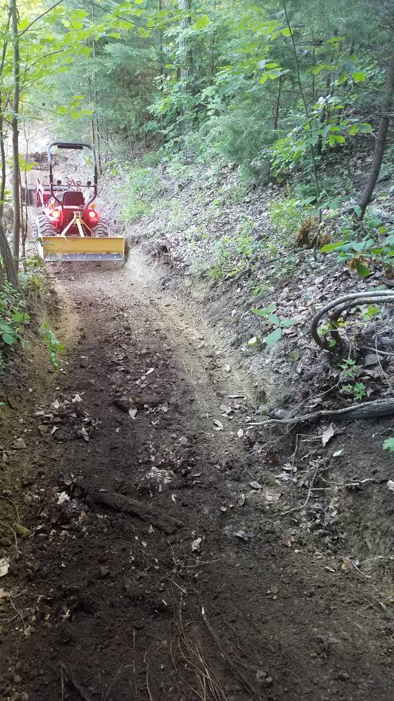

Good news, it's beautiful outside and my trail is shaded.
Bad news, ticks and sticks!!!
My trail entrance/exit has 2 dumping spots depending on if I'm dragging dirt out with the box blade or if I'm carrying out a load in the loader.
The farther in I go....the longer the haul
Not too big of a deal, I'm patient in my minimal progress. However, cleaning up the dump spots to their final destination, that my niece has named 'The CLIFFOFF!', is about 100 yards away across gravel. This is not fun. Mind you, I have a TYM. Only Hi and Low gear hydro. High, I lose my load bouncing all around. Low, I lose daylight and time.
I have an old truck bed liner the previous owner so kindly left me in a gully. I've hauled it up to my barns. I was thinking of using it at my loader dump site. Fill it up, chain it to my box and drag it, then push it off 'The CLIFFOFF!'. Hopefully I'm left with an empty liner and it doesn't drag me down.
Thoughts...???

Hate to harp on runoff...but that looks like an aqueduct...

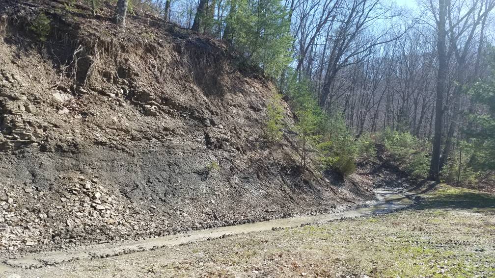

Lol..yes. this is actually the main gully that will wreck everything if I can't figure out drainage. Right now any heavy rain will rut it out. One swipe with the box will get it back in shape. Long term .... I still haven't figured it out.
   / I was told it is a bad idea...hold my beer!
#64
All the other gullies end here. I carved a ditch to run out the south side of my property. When my trail reaches one of these gullies I will have to use culverts or bridges....???...if that makes sense20180226_121435.jpeg

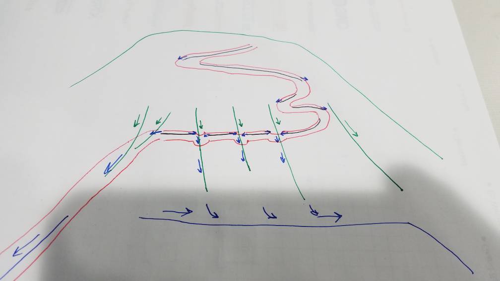

Just to clear up one thing, if the rainwater stays in the same ditch ALL the way down, by the time you get to the bottom it will be a huge volume of water. If you can't avoid this, you may have to put in a few culverts to divert some of the water under the road to the downhill woods side.
Steep sections seem to do better slightly crowned to shed water in as many directions as possible and avoid the water creating a gulley down the middle of your road.... More bends and turns help, keeping each section short helps. Diverting water in as many different directions as possible helps.
#68
I understand ya.... crude drawing ....green is existing gullies. Red my trail. Blue current and future water flow. Black ditches.
