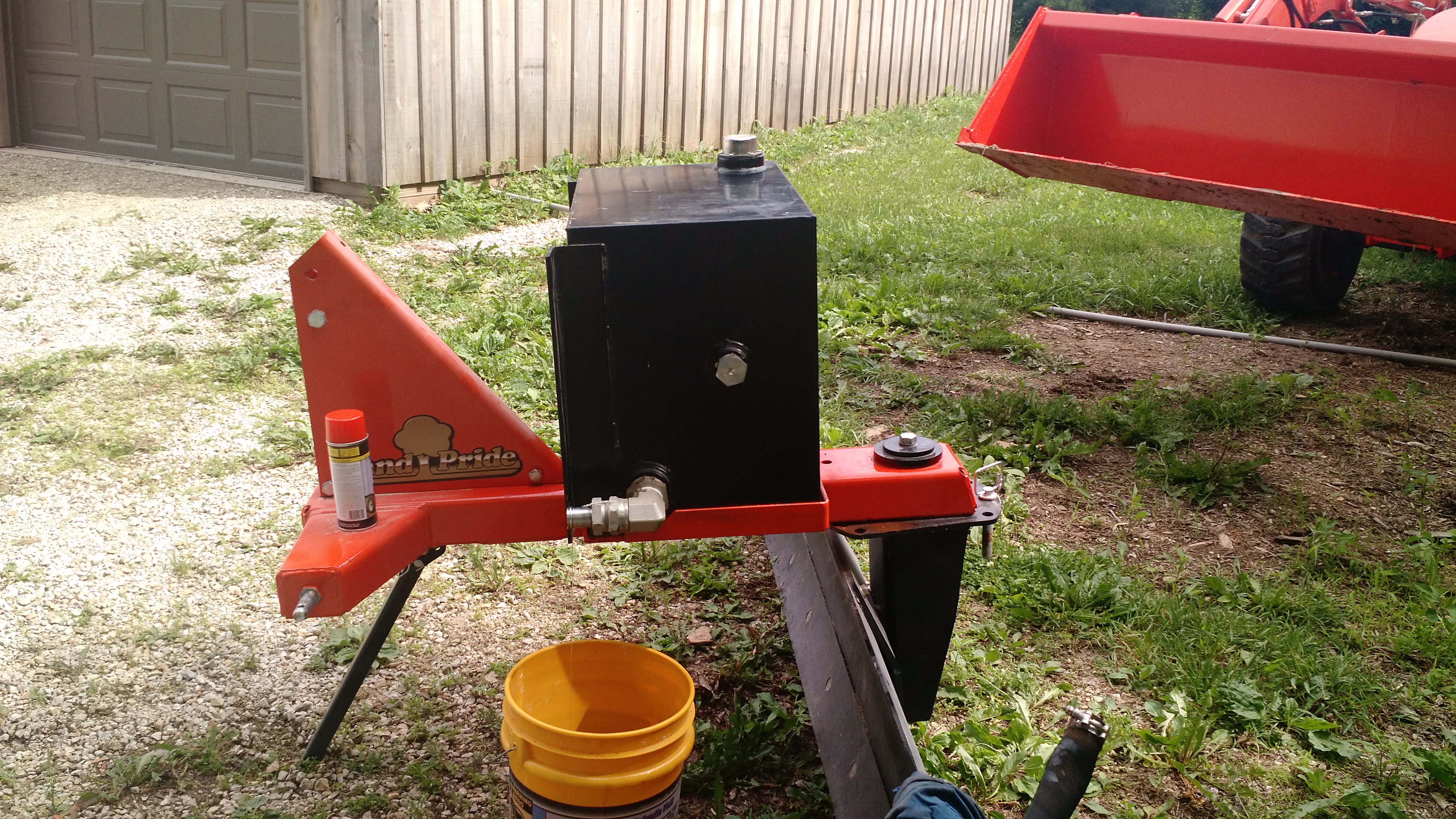

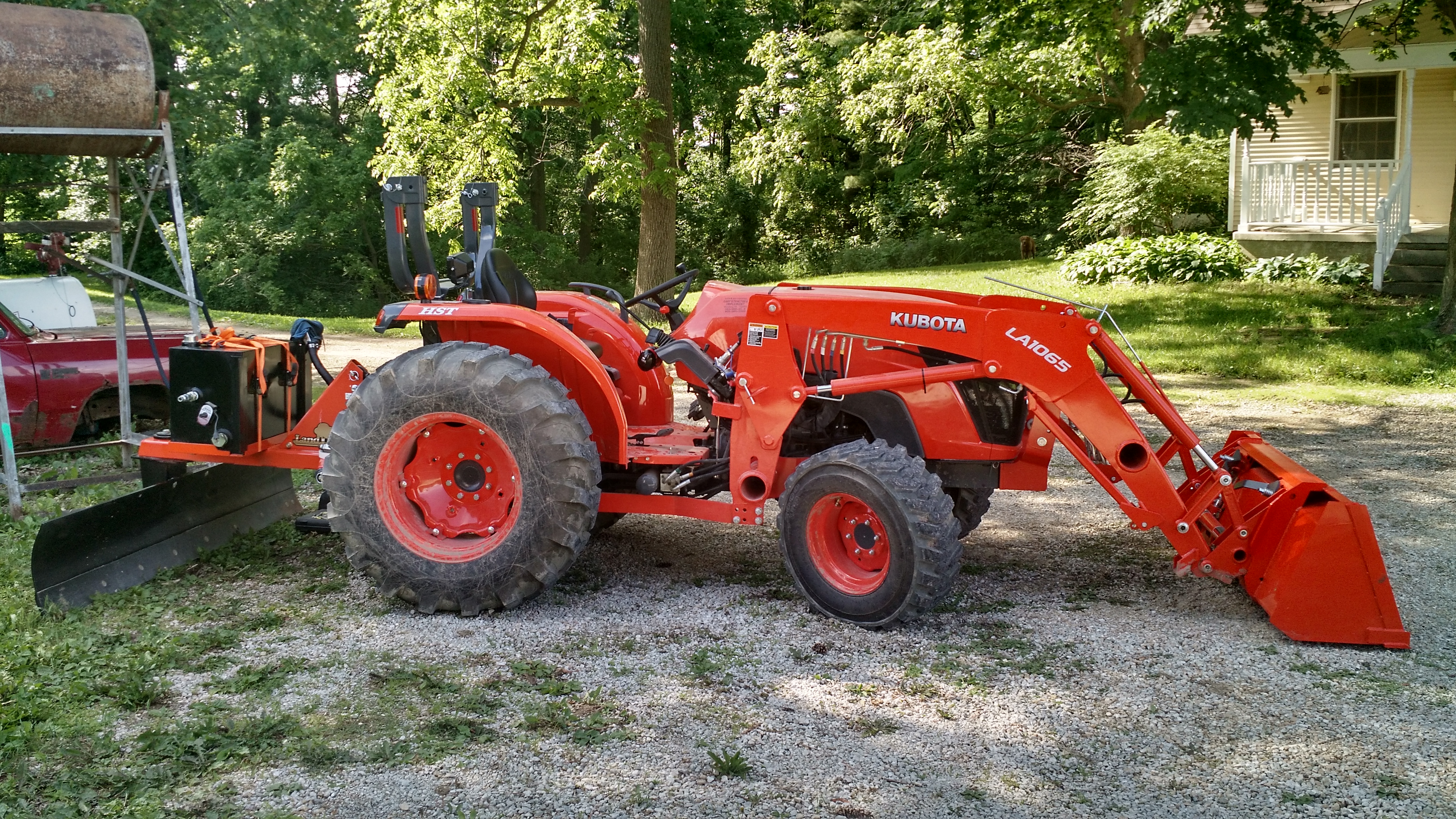

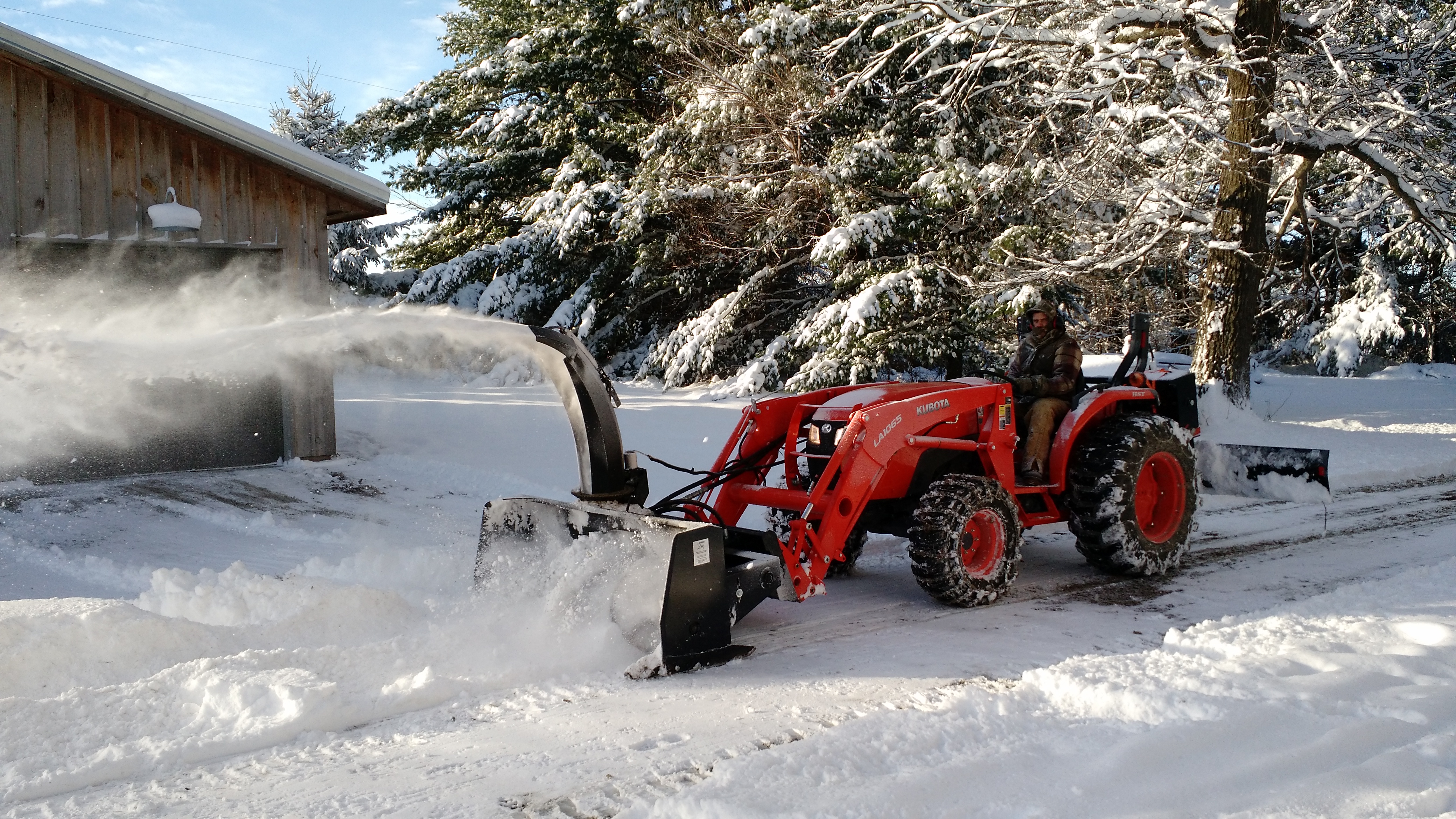

I run a 74" Quick Attach skid steer snow blower on my MX4800. I have a 22 gpm Prince PTO pump and a 30 gal reservoir mounted on my blade. It works great. I have used this since 2015. I use my FEL in the winter to move firewood to the house.

so, even with the higher flow of the "M" series tractor, you still needed the PTO HPU? Interesting.
Really nice setup!

A M4072 only has 16gpm, a M7132 only has 21gpm picking random Ms off Tractordata.com. those are probably pretty representative of the class though. 21gpm @2,500psi is only 30hp. Well under half, maybe a third of the avalible engine HP. Hydraulics are also less efficient (wastes a lot more energy to heat, friction, leakdown, etc) than direct mechanical drive.
A skidsteer is made to be all hydraulic for control & because there isnt really a way to run PTO up to the boom effectively. Tractors are designed for efficency putting power to the ground or the PTO. More efficient machines for what they were designed for, but they have different tradeoffs.

My MX4800 only shows a auxiliary gpm of 9.8 gal per Kubota. The blower is a 15-25 gpm if memory serves. I think I paid $450 for the PTO pump. Maybe $250 for the aux tank. All in all, no more than an additional Rear Remote, even if the tractor had the GPM to run the blower.

You definitely need a relief valve in there. Hoses aren't cheap either. You really should have a filter in there as well.
Control valves can probably skipped for this use case as you dont need reverse & can just start or stop things with your PTO. May be needed if you want to use it to power anything else.
A cooling radiator & fans are generally needed for that type of power pack. But extra cooling beyond the tank itself can likely be omitted if you are only using it in the winter.
