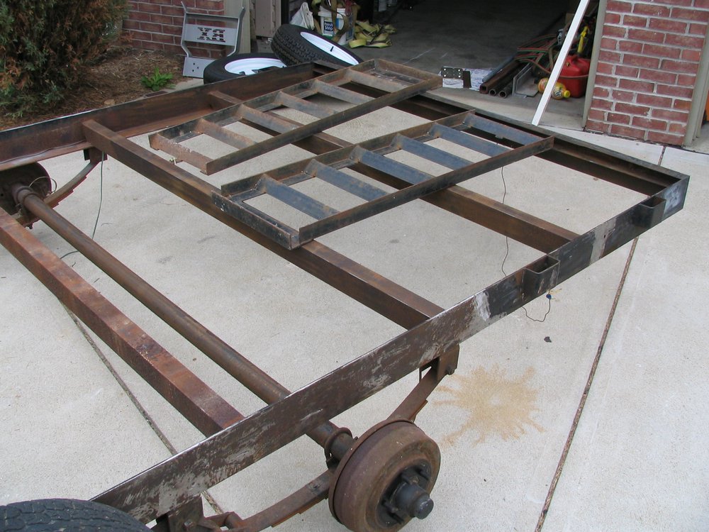

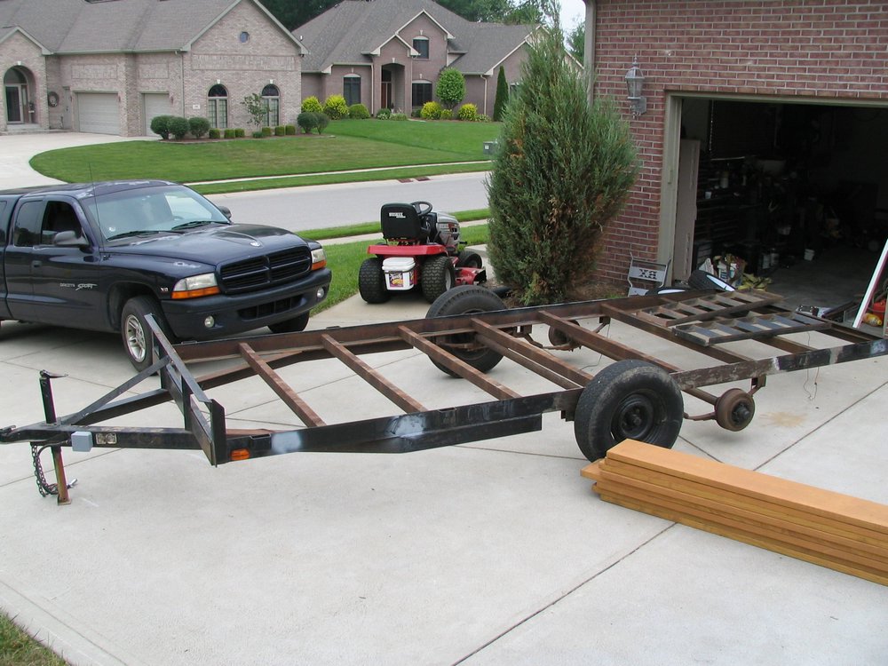

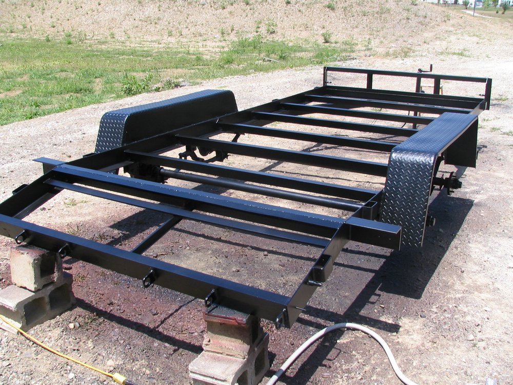

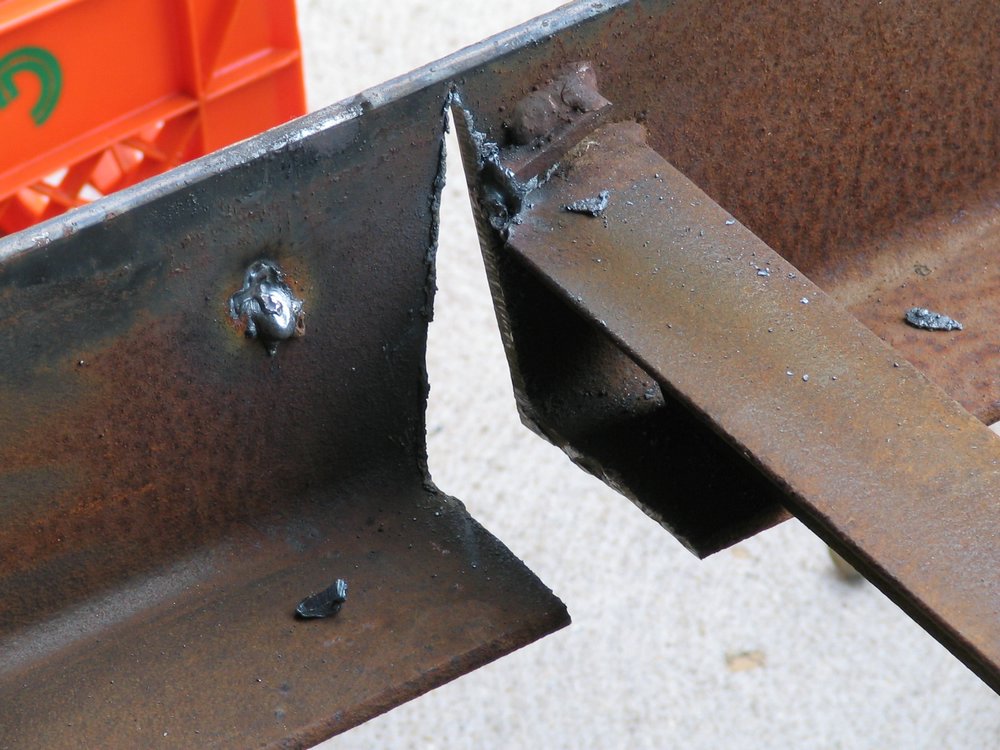

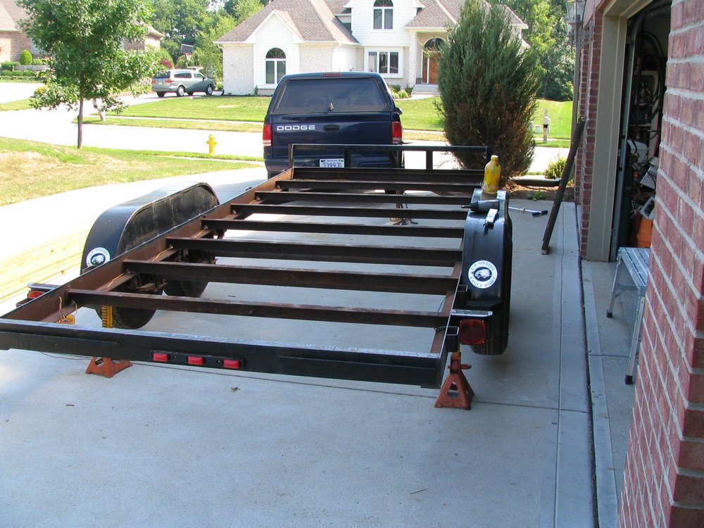

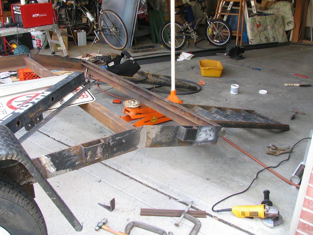

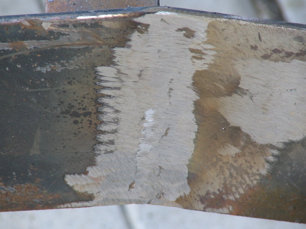

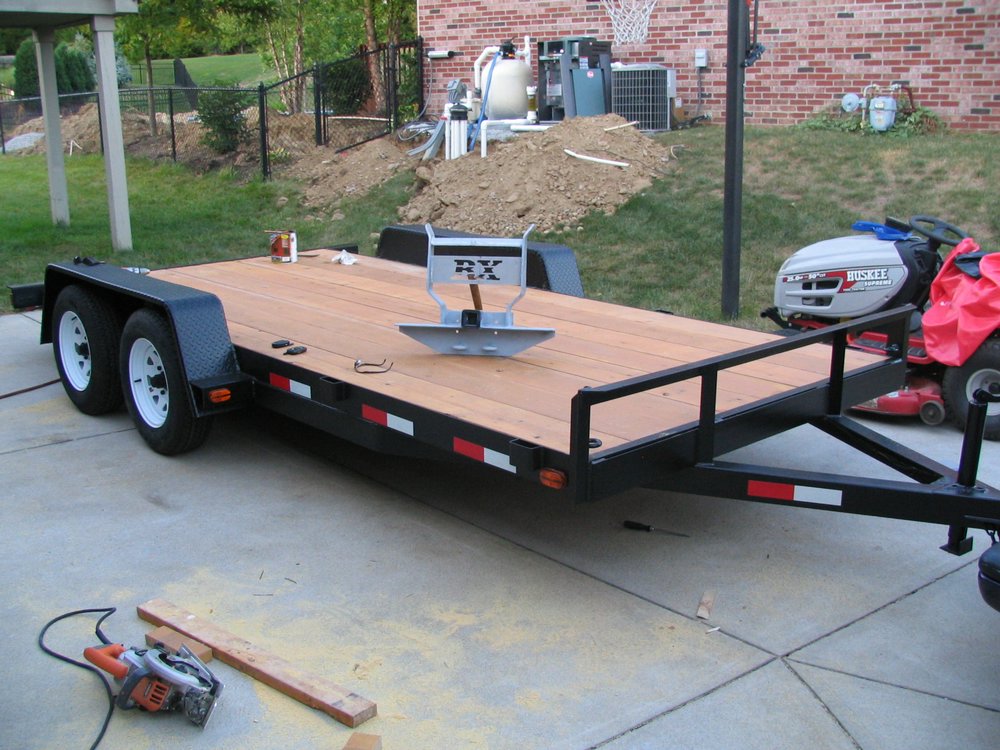

I did this to my 16' trailer ... see the attached pics. I had the same issue as far as the ramps that came with it being too short and therefore too steep to load the machine so I cut the back

bx24, that's a nice job. Thanks for posting the pictures.
   / i want to add a dove tail to my 14 ft trailer #19
BX24
Very Fine! Looks like a fun project...... and with excellent results. Craftsmanship and pride is obvious.
I take it that you had to modify (shorten the chairs) on the ramps for the lower Dovetail.
BD
   / i want to add a dove tail to my 14 ft trailer #20
bx 24 ...thats a really nice looking job you did ......
