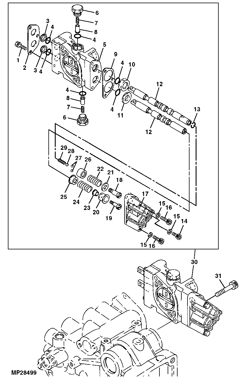

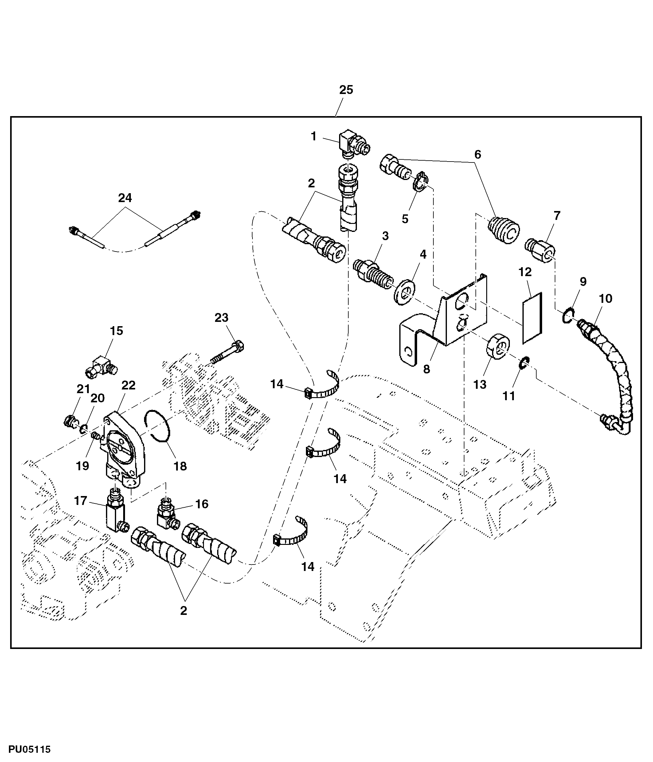

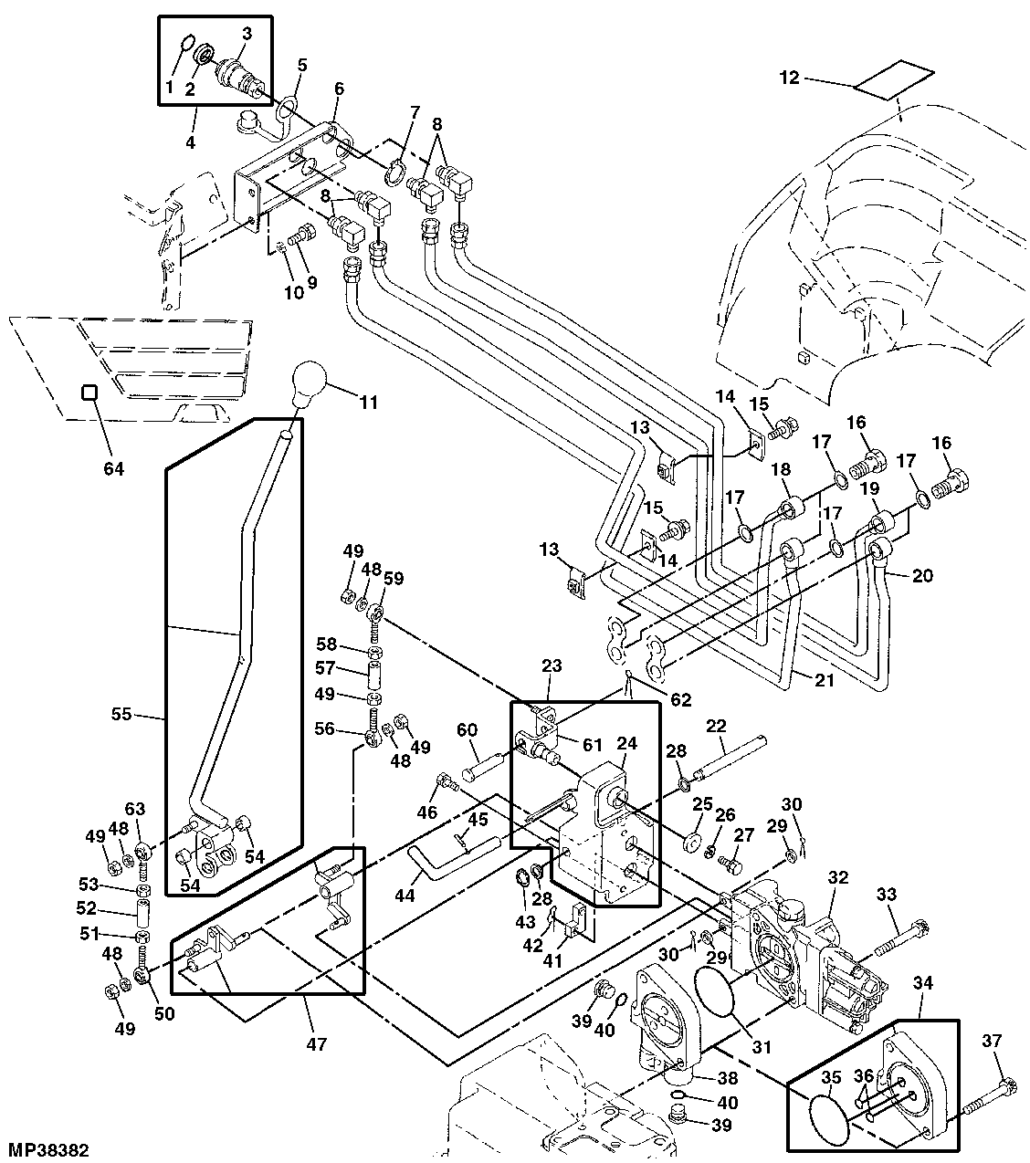

You need have the aux hydraulic BLOCK between your valve and the rockshaft housing like the 4100 uses for rear remotes. JD doesn't list that block part for a 4010 but they both use the same part number for the valve so I don't know why it wouldn't work except for clearance issue with the fender maybe
Picture#1 is 4010 valve/ Picture #2 4100 valve and shows block (#38) /Picture#3 is aux block plumbing for rear hydraulics /pic#4 is the 4010 valve breakdown

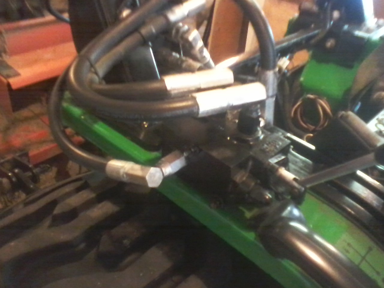

That valve doesn't adapt very easy to a simple hosed PB plumbing set up to another valve so I would think you are somewhat limited with that. The block allows for outflow and return whether it there is another control valve (I have that setup for a hyd toplink and also controlled a dump trailer that way too) or just a full flow/return line out to something like log splitter with it own control valve. Just remember it cant dead head you always need an open loop flow back to tank. The JD PB kit does just that, the large hose shown in the kit loops the flow back when not in use with an open center valve.

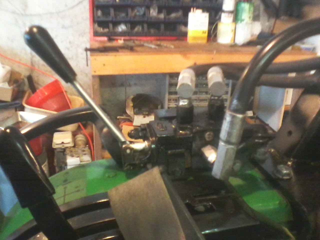

These are some quick pics I just took of my xtra control valve setup with PB kit

It's an open Center hydraulic system. Just plumb the new valve block in series into any high pressure line of your choice.do no run the return line for the new valve block back to sump as if it was closed center. A relief valve must be in the circuit and set properly. Possible a line for the relief function only back to sump.
