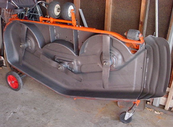

Maybe you guys here have some advice. I have a Z-Force 50 with the washer system. It seems to work just fine, but I choose not to use it. I mow 5 acres that is in a really sandy area and want the build up to protect the underside of my deck. Anyone else dealig with sandy loam? About 1 acre of it has nice st. augustine but all the rest is just wild grass and wild flowers...and lots of sand...
/ I want a Clean Mower Deck!
#26
I have sand, but the green gunk won't protect your deck.
There will be areas of bare metal and the sand will concentrate it's abrasion in those areas. Plus the gunk will mess up the air flow so the grass doesn't stand up leading to poor cut quality.
If you really are worried, you may want to have it coated with the stuff they spray on truck beds. (?) that may help (?)

Has anyone sprayed their deck with the bedliner stuff? It seems to be really tough, but it also seems to be a pain to clean. I have heard complaints about cleaning out truck beds - mulch, etc - that everything sticks.

There are at least two kinds of spray on bedliners. Most of the new stuff is not shiny and pretty gritty., but I remember a few years ago seeing some that were pretty smooth and shiny. Sounds like a GREAT idea though! I'd love to hear from someone who's done this.

I applied two spray coats of Slip Plate to the underside of my deck at the beginning of the season. I just cleaned it and noted that the area's where the Slip Plate still remained the grass came off easily - but there was still some grass there. However there were large area's where the sand/grass/debris had just blasted the Slip Plate right off the deck. So it seems like the areas where you need it most are the areas where it isn't durable enough.
I all fairness, I just got done renovating my lawn so I had some areas where I'm sure a lot of sand/soil was getting sucked up and blasting the deck. In addition to my "yard" I also mow my 2 acre orchard so there are a lot of twigs and apples and stuff on the ground.
I would love to hear from someone who sprayed a slick Rhino liner under their deck.
