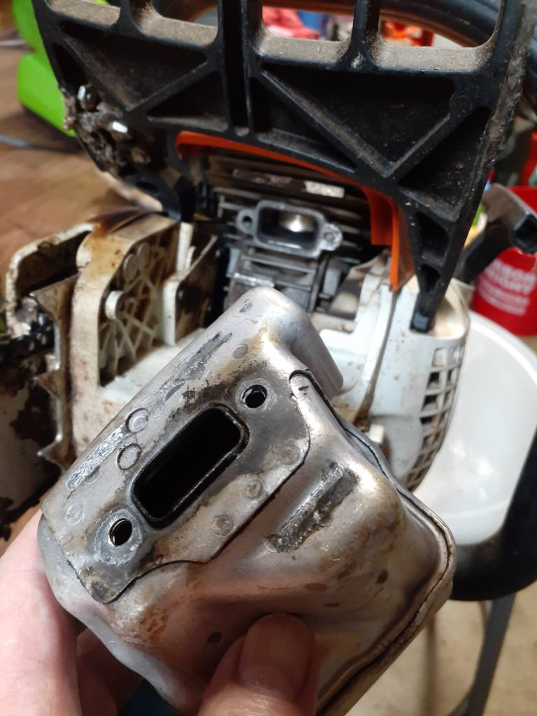

I don't want to read all 6 pages of advice, so if this is a repeat, sorry. The gent that recommended Snap-On easy outs was correct, in my opinion. The cheap ones are usually tapered, which to my way of thinking, would tend to expand the broken bolt, making it harder to get out. The S-O,s are straight and splined, not expanding it. Yes, they are pricey, but it will be a lifetime purchase and the individual parts may be bought separately. What I would do before any of these methods, though, would be to use a sharp, slender center punch, angled off center, at the periphery of the broken bolt, gently tapping in removal direction. If broken piece is not seized, this will often allow you to "walk" bolt out slowly, obviating use of an easy out. If broken piece is even slightly seized, though, this will not work. You'll know in a few seconds if this doesn't work, so you can then go on to other methods.

I had the same thing happen to me with my 15y/o Echo trimmer. A muffler bolt sheared off, the other was gone. I drilled a small hole in the center first, then a little bigger bit. Then I used an ease out And I did get it out. Then I drilled out both holes and tapped them for 1/4 inch threads and used two 1/4 inch bolts with lock washers. Been working fine now.

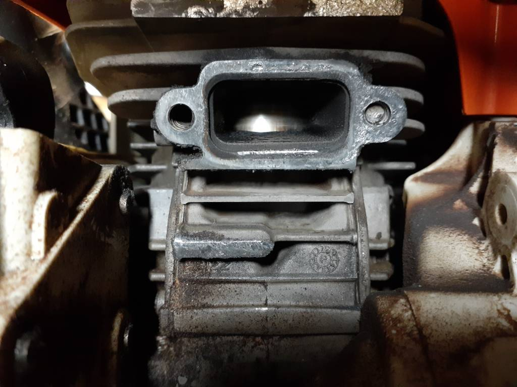

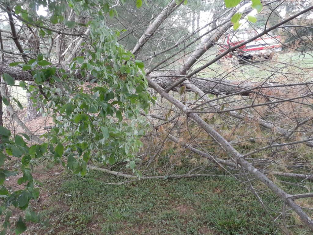

I just cut a fairly good sized dying white pine down, was limbing it when the muffler fell off my MS291. Can't figure out why. Soon as I got it in garage it's raining like crazy, so had to quit anyway.
Getting the one bolt recessed will be fun. Any ideas...thanks in advance. View attachment 701069View attachment 701070View attachment 701071
I bought my 026 in July 1990 and it still goes very good. My muffler fell off a few times and that bolt finally would not keep on. I had to tap the threads to the next size and it worked out better. Best saw I ever bought. I use it alot around the house and on my 59 acres of woods. I used to cut all my firewood - but being an old fart now I have a heat pump and solar power to supplement a pellet stove.
Good luck getting that bolt end out of there.
