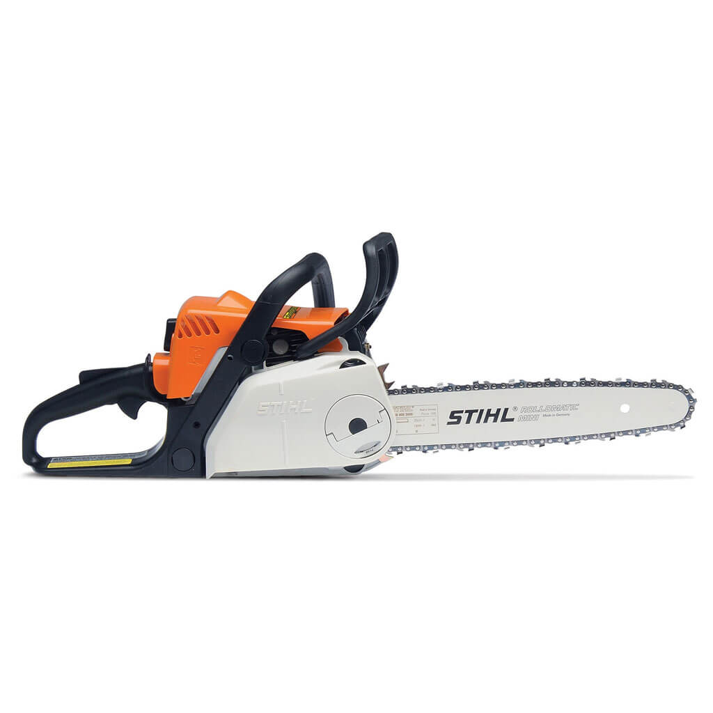

I have one of these, tiny but tough machines. Not for heavy work --- I have friends for that, with "real" chainsaws. It is light enough for me to use to limb fallen / downed trees, reasonably safely. Good little unit, and it is on hand if someone decides to give me a hand with yardwork.
STIHL MS180C-BE 32cc 16 in. Lightweight Easy2Start Gasoline-Powered Compact Chainsaw​
