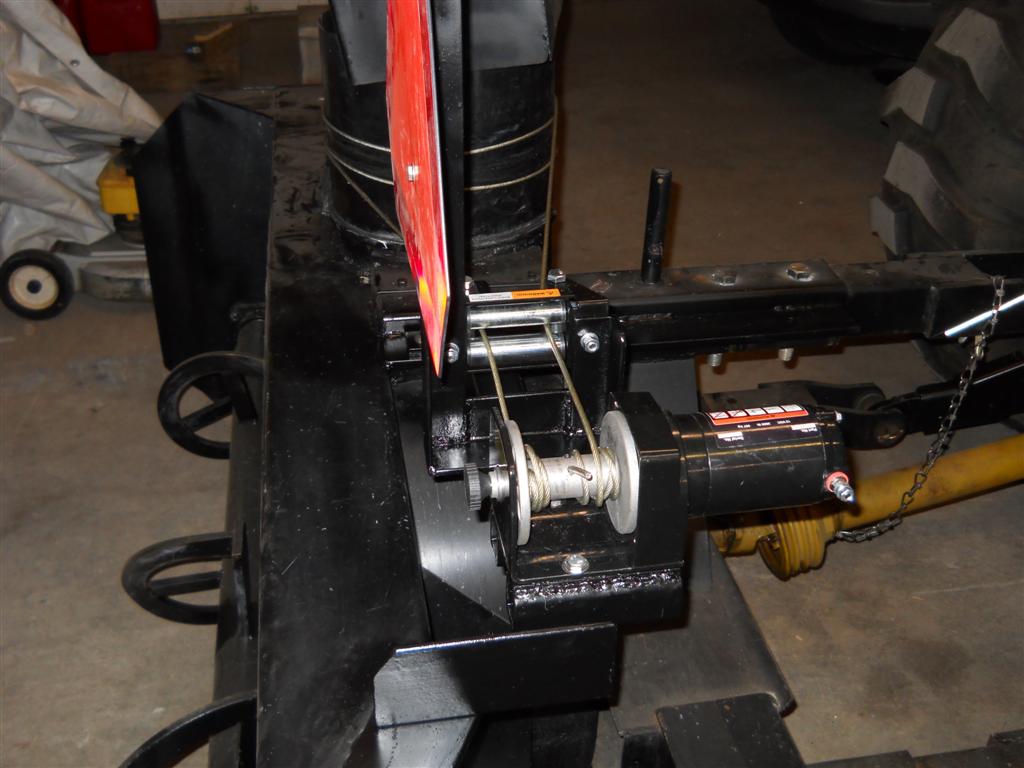

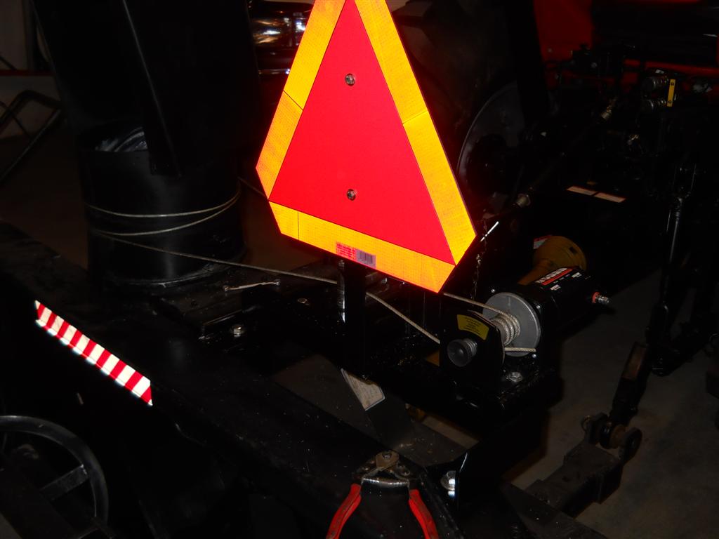

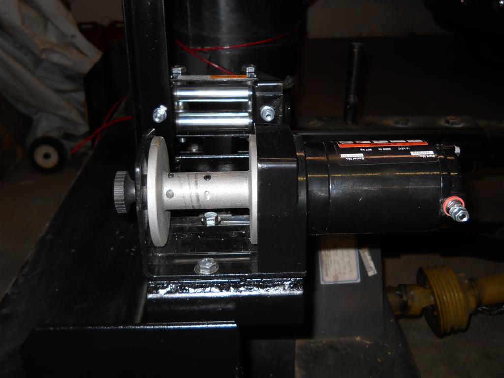

That chute rotater is well laid out.
\Nice installation.
They are ideal due to torque, speed and cost for that chore and I have posted this suggestion a few times
Don't know what you used for control switch, but a standard spring loaded DPDT switch (center off)can handle that job nicely.
/ I Shrunk my Snowblower #22
\Nice installation.
I have several switches at various spots on the tractor. The one I use the most is mounted on the back of the seat several inches below my arm pit. When I sit sidesaddle, it's right below where my right hand is most of the time. Has a big bat handle.

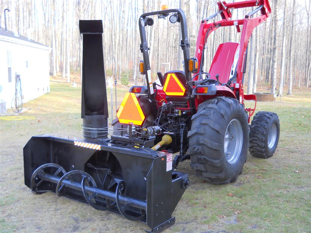

/ I Shrunk my Snowblower #27
..........Danged if that little tractor didn't handle the big blower like a champ! The only problem was that the blower is 20 in. wider than my FEL bucket, I use both for snow removal, and I've had a few close calls nearly side-swiping things with the blower when using the FEL.........
Your workmanship is very nice but I think I would have taken the easy route and made a couple of bolt-on extensions for the bucket instead! :D
#29
I considered that and it may still be in the works (eventually) to match the narrowed blower. If I widened the bucket to the full 74", I would have to get rid of some stuff in my garage to make it fit, and I just can't make myself get rid of stuff. Or I could build a bigger garage...hmmm. Actually, the narrowed blower lets me get into some tighter spots much easier than before. I like it.
