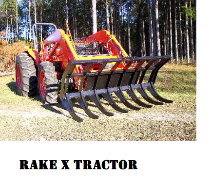

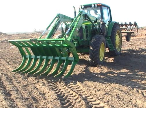

I recommend a tractor rake to collect and remove roots and stones from the ground

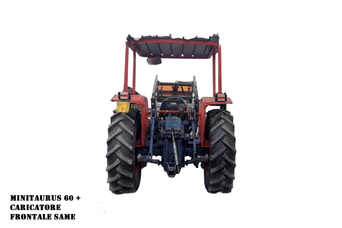

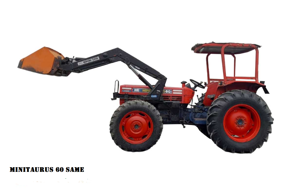

hello, I should reclaim a land that has been uncultivated for years, I should eradicate the weeds, the invasive vegetation of the small shrubs such as ailantos that have created a grove and free the uncultivated and invaded area from vegetation to create a clearing. I would like to attach to my tractor a sort of large and sturdy rake to eradicate and pile up in sheaves these waste materials. some ideas perhaps by building a tool similar to a large rake or a pitchfork with sturdy teeth and prongs that by sinking into the ground and making the tractor advance, tear out the weeds, roots and emerging stones thanks
.the land is on a non-flat hill with the presence of alluvial sediments, river stones and clay. it is material brought back from earthmoving works such as an abandoned landfill where time has created a sort of jungle thanks to

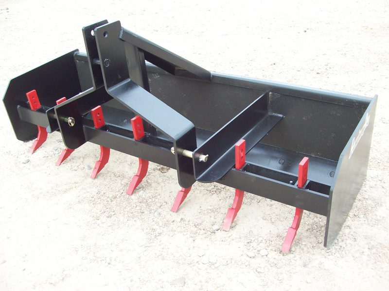

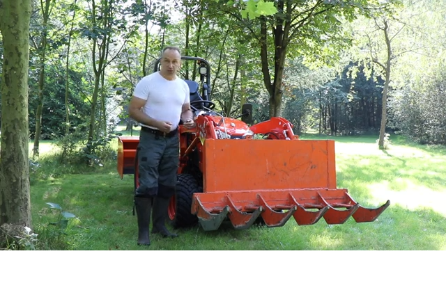

If you have a box blade they generally have some pretty sturdy rippers to dig into the earth.

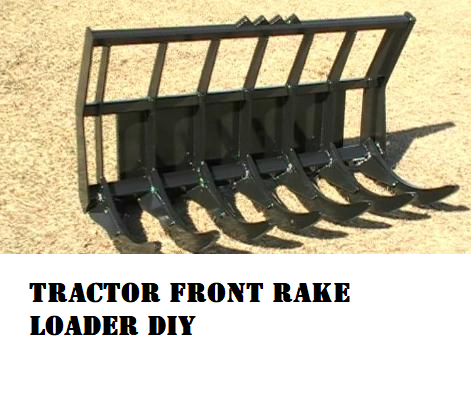

Rastrello Tactor fai da te
Vorrei realizzare una forca rastrello per rastrellare il terreno in questo modo. Puoi aiutarmi? Grazie.

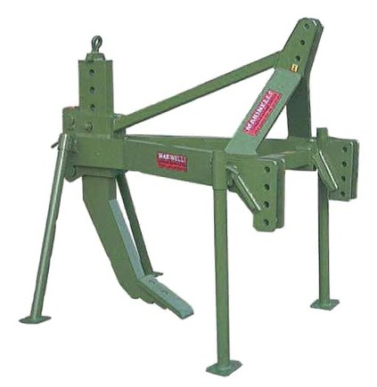

squartatore?
   / I recommend a tractor rake to collect and remove roots and stones from the ground #7
squartatore?
[traduttore Google]
Questo accessorio serve per scavare in profondità senza rivoltare il terreno: serve a migliorare il drenaggio e ad allentare il terreno profondamente compatto.
Hai già pesi extra per il trattore e eventuali accessori?

Looks like he's got a "SAME Minitaurus 60" tractor -- 80's 59hp, possibly 4wd, ~5000# bare weight.

yes the land has been abandoned for years, there are bushes, canes, ailantos, spontaneous trees. I have done the cutting work, now I have to free the ground from stones and roots, the ground was sunken and they filled it with soil resulting from excavation and earthmoving work. clearly it is a landfill, maybe I should rent a large earthmoving machine to level and compact the earth and break up the surface layer with the teeth, so it can trace the paths and the access ramp. maybe an excavator or a large mechanical shovel right? then I will do the finishing work with my old same thanks
