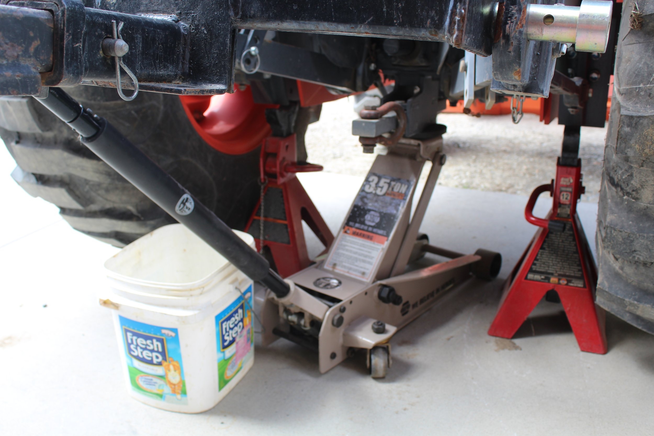

What I did was like others said here, rotated the valve stem to the 11 or 1 O'clock position, used floor jack to take some pressure off of the tire, and used a plastic funnel with a tubing attached at the bottom of the funnel to feed into empty 1/2 gallon juice containers.

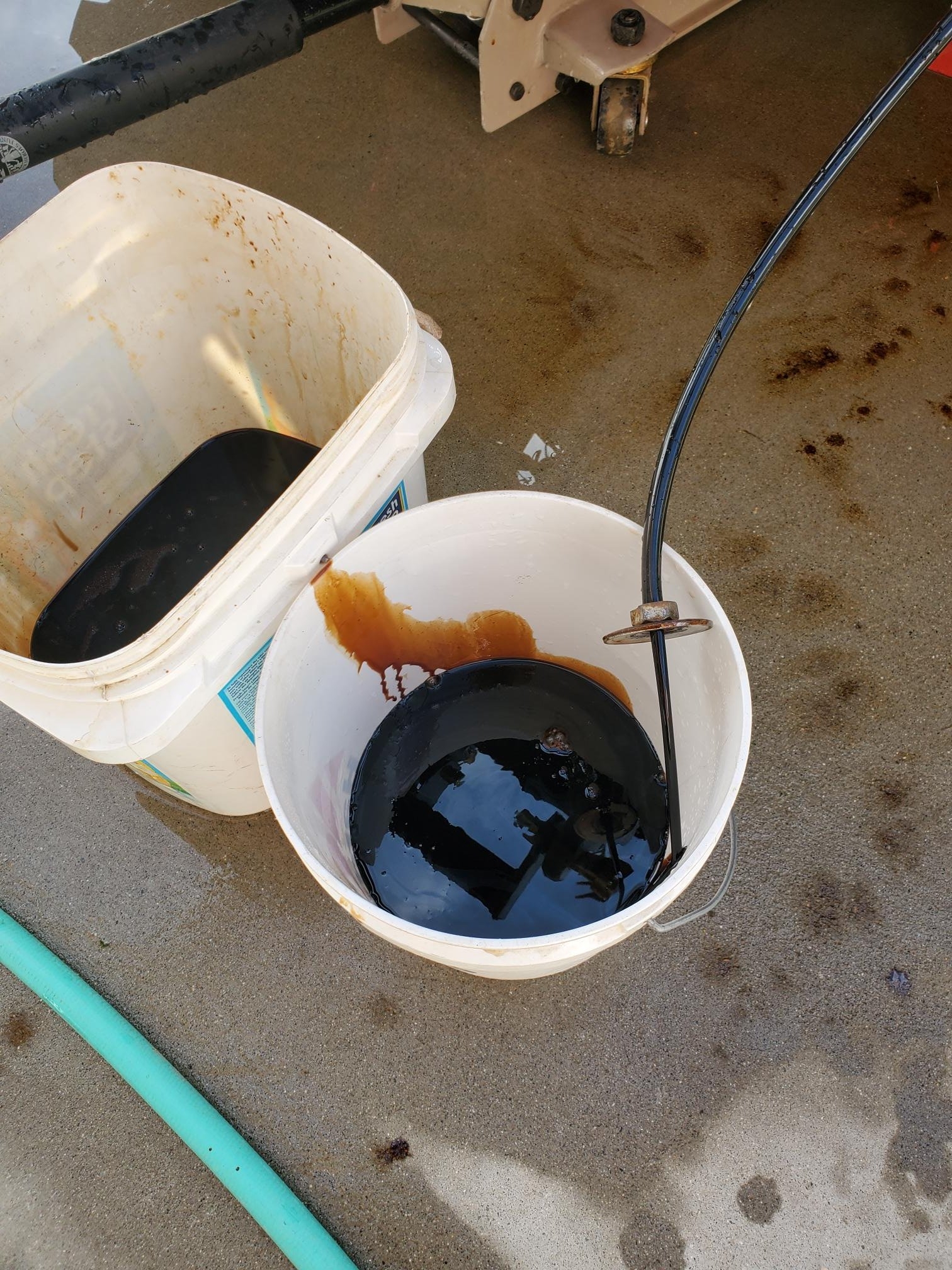

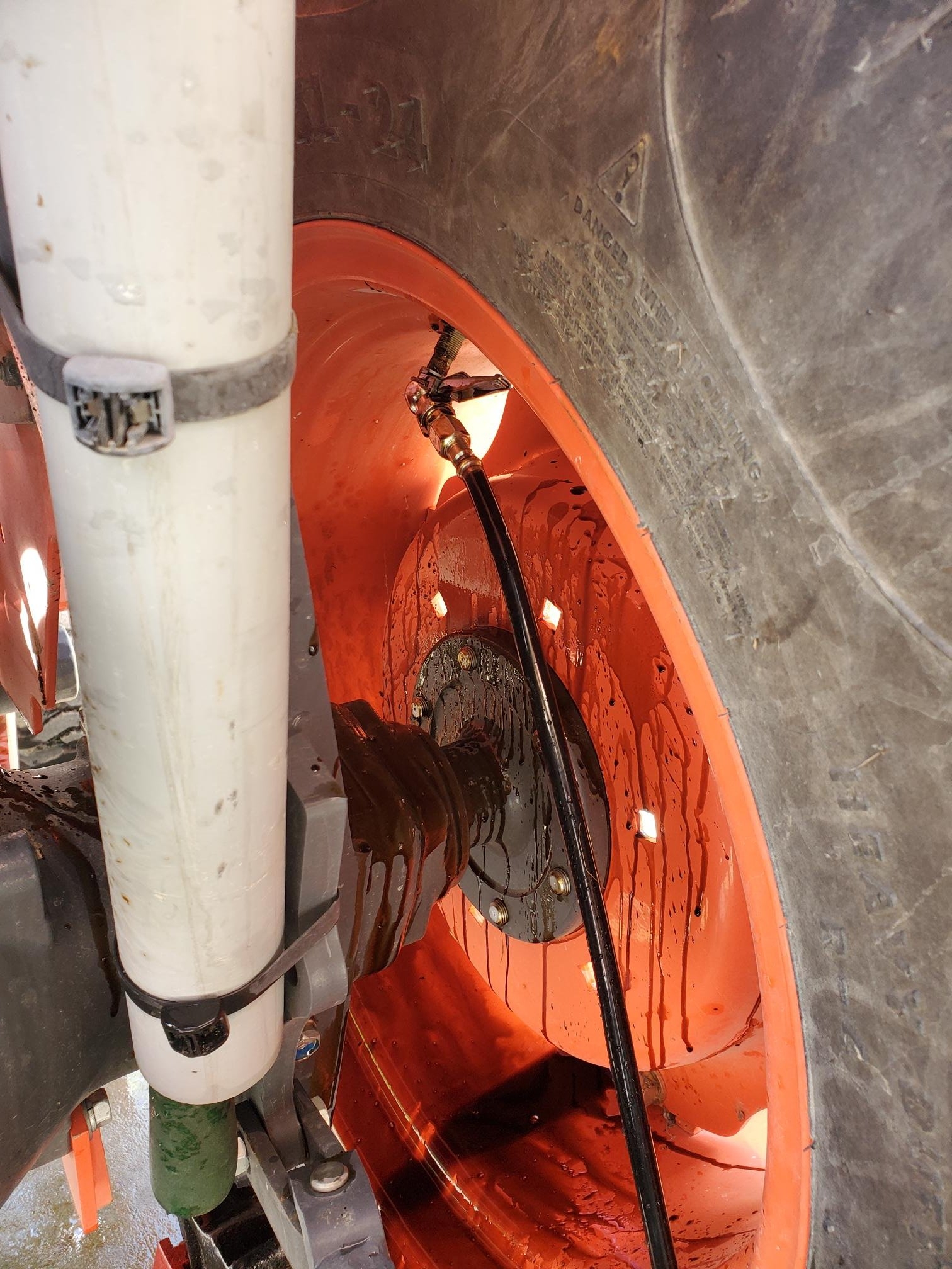

I drained the Rim Guard today and Boy that took a while. Sorry @gstrom99 no video. On the second tire it wasn't bad, but the first one didn't work as planned. I finely got them drained enough that I could let air out, 10 gallons of Rim Guard later. It took up most of the afternoon. I did manage to do a few other things in the shop while the Rin Guard was draining.

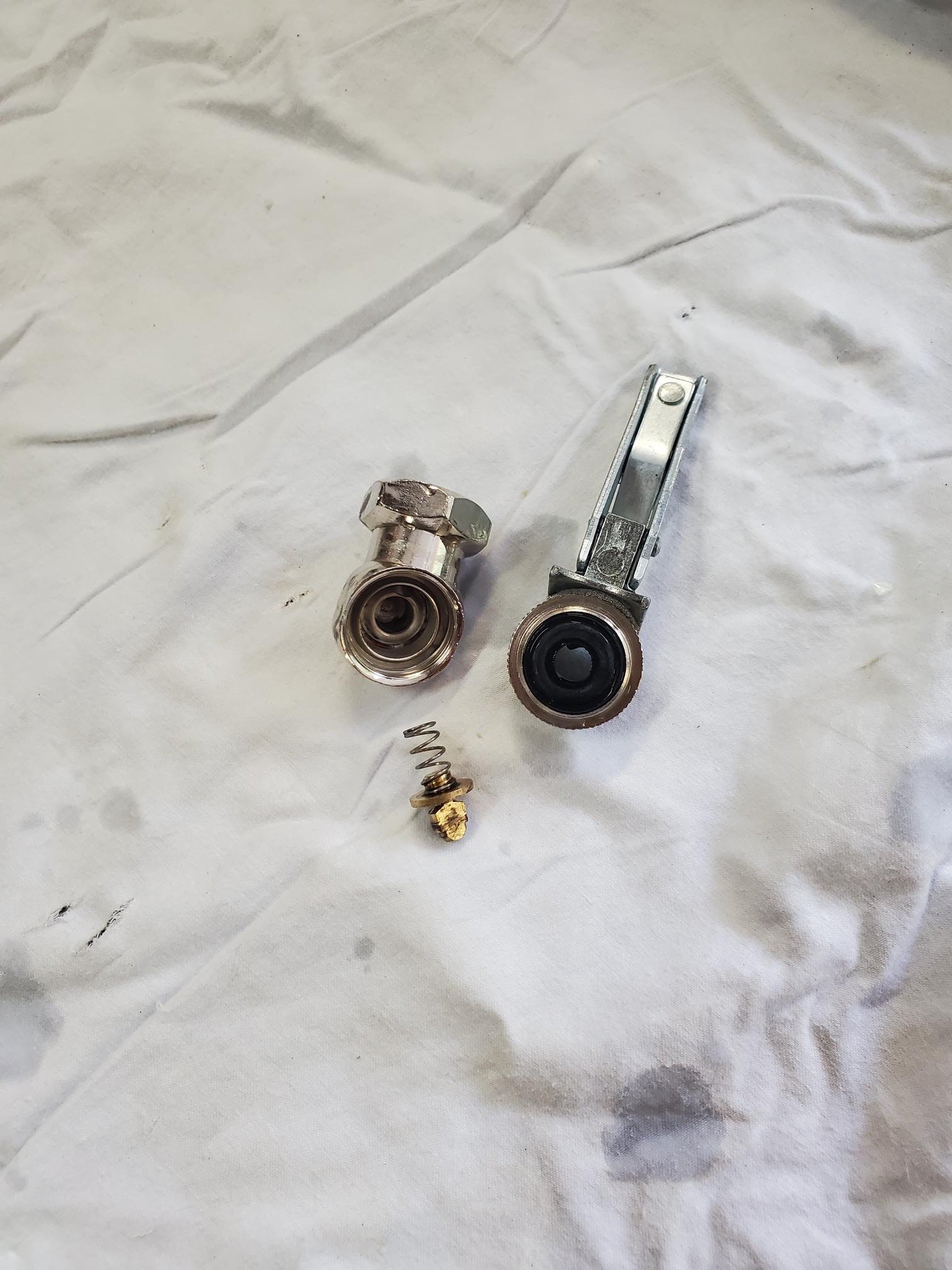

So, at first, I thought I would just snap on an inflator and let it drain. It would only drain 1/2 cup to 1 cup and plug up. I found I could just move the chuck around a bit and it would continue to drain, but time consuming. I finely removed the inside of the chuck then removed the valve core and quickly snaped on the chuck. But that would only work for a while also before something would plug it up. It looked like maybe the rim guard had coagulated, and the valve stem needed to be cleaned out a few times.
I got it done and I am now setting at 15 psi. in each rear tire. And now I have 10 gallons of Rim Guard to deal with.
Here are some photos.
