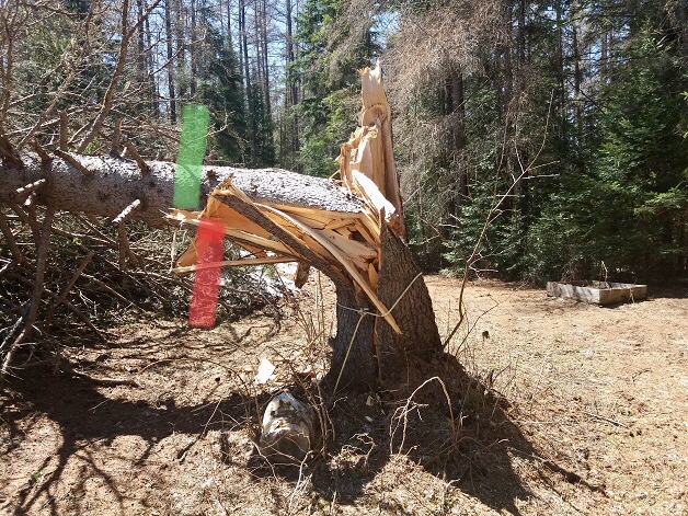

The tree is on the ground, supported by the branches, maybe. Can't tell if it is in compression or tension at the trunk near the stump.
I'd (that's me not telling you what to do, but what I'd do) make a cut 1/4 of the way through from the bottom at the red marked area. Then I'd start cutting from the top, about 3" up the stump at the green marked area. Watching the kerf carefully for movement. If it starts to open, I'd finish the cut from the top. If it starts to close, I'd finish the cut from the bottom. I'd also watch for rolling, as who knows where it will want to go if it's just resting on branches.
Clear the area of all debris on the ground and trim off all those sticker branches and splintered wood before beginning to lessen the chance of snags and tripping in my escape routes.
Or, if you're not comfortable doing it, hire a tree service. They'd probably only charge a few hundred bucks to get it on the ground if you're going to saw it up and remove the branches yourself.
