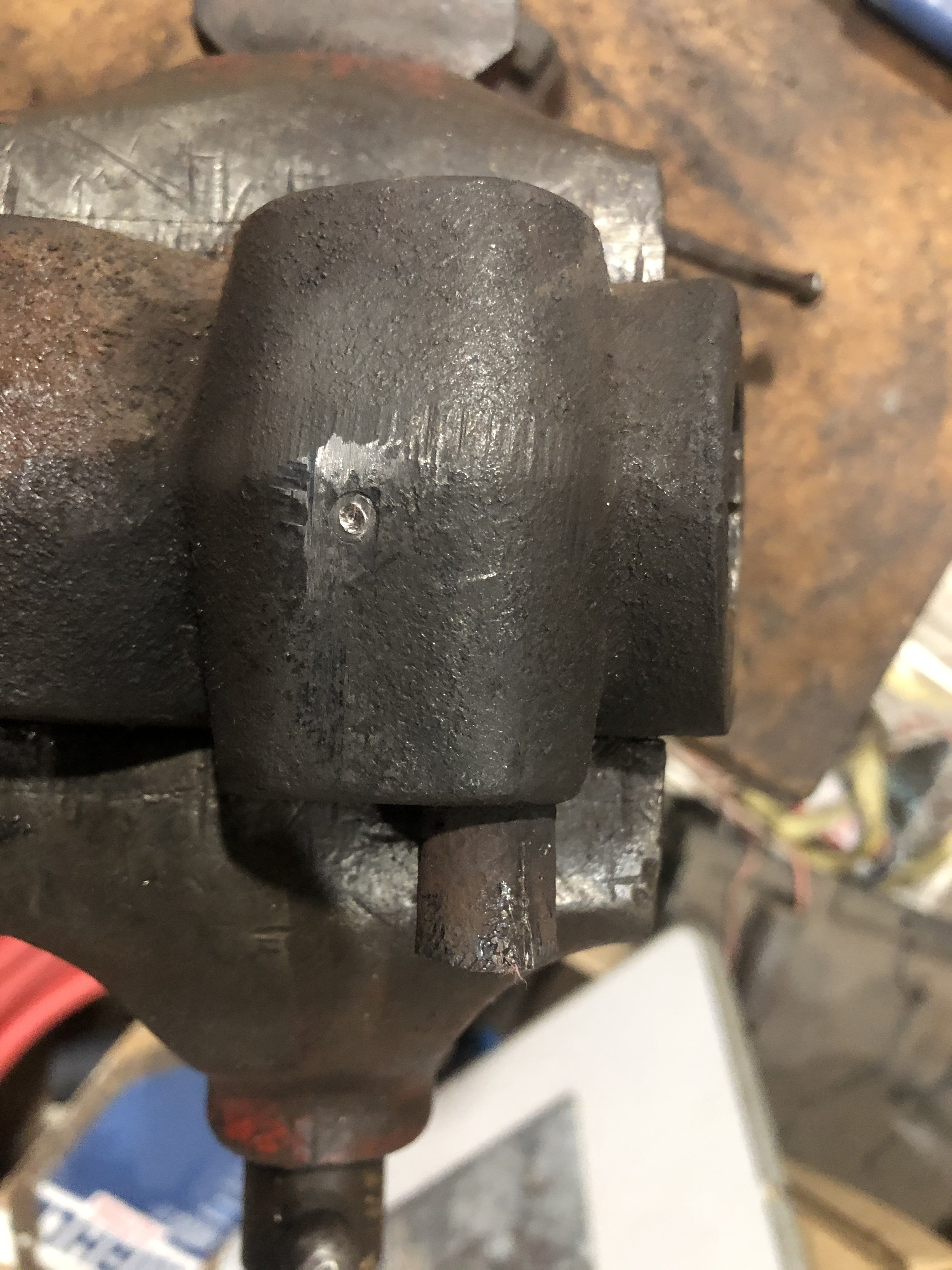

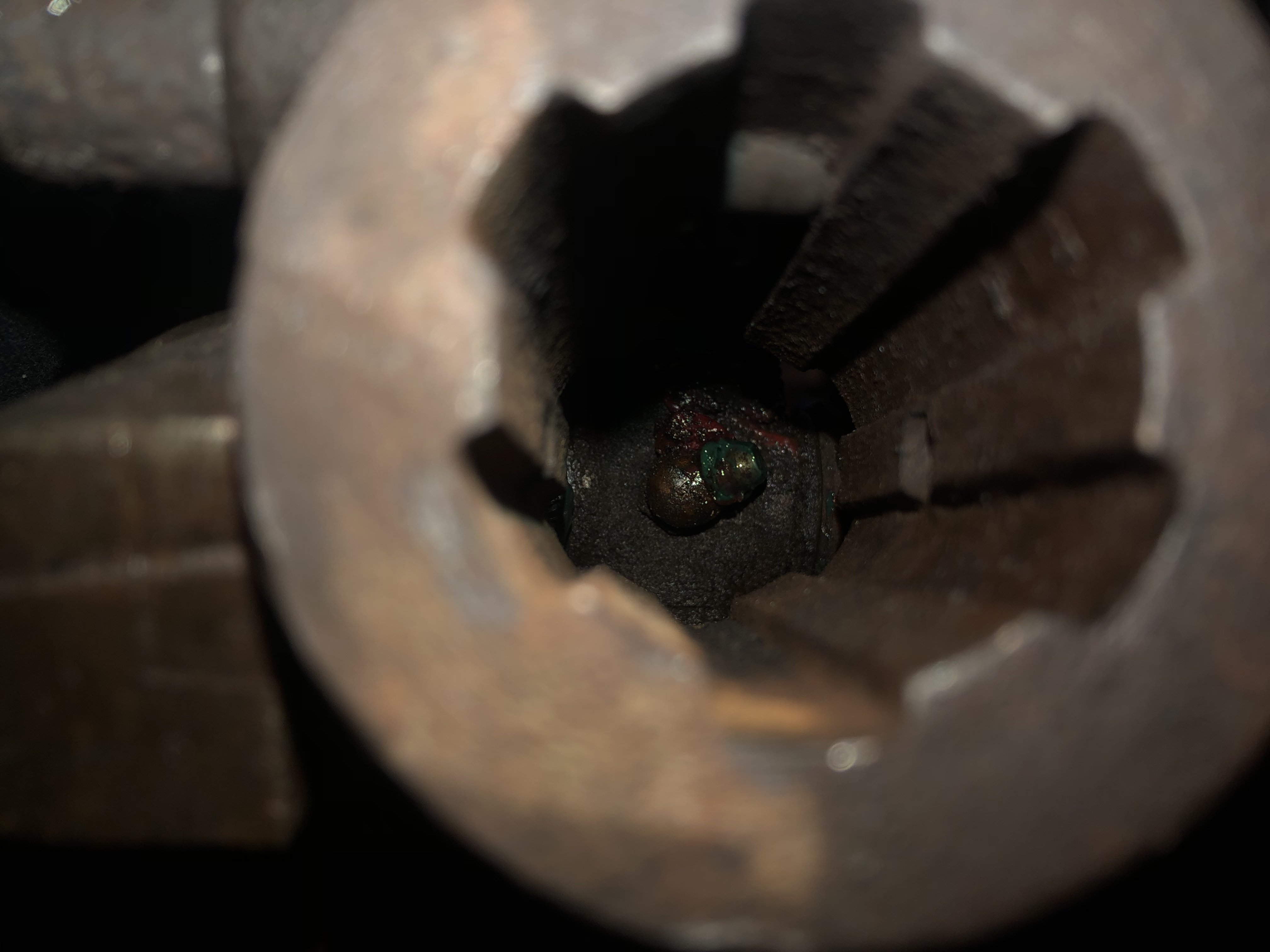

Hi,
I bought a used Howse bush hog. The button on the PTO was stuck in, so the shaft would just slide off the splines. I freed it up last night with a lot of heat. I believe there is a pin holding it in, but it almost looks like part of the casting. I cleaned it up with a file, but I was only able to deform it a bit with a punch. Used a lot of heat abad penetrant to shock it and nothing.
spring and pin are shot. Never used a PTO that didn’t have the locking ring before. I believe the pin is the one that looks like an hour glass, it’s a 1/2” diameter. There is NO opening on the opposite side.
I found exactly one thread, on here, that mentioned an older Howse oem pto shaft having a brass pin that was almost invisible.
Tried hitting the locking shaft in and hitting it out. Just nothing. Really put a beating on that pin too.
Thank You! Austin

Still can’t get it out. If that is a pin, it’s not moving at all. Should I just buy a new shaft? The safety shield crumbled as well. It’s in good shape otherwise.

Do a web search for ‘PTO yoke pin repair’ , part kits are out there, how to videos too.
   / I need help replacing an “old style” PTO button #5
I think I have seen those pin repair kits at Tractor Supply.
Course that assumes you can get the old pin out.

Thank you very much for the input. I have never had a pin just not give before, after heat cycling and beating it with a punch.
