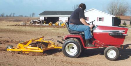

If this one could do it, surely a CUT can do it. See the attached picture.
