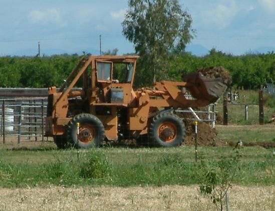

My neighbor has an old Allis Chalmers 545 that sits around most of the time but fires up OK when he needs to move stuff around his place. It would handle loads like yours no problem. You could chain your pipe to the bucket or replace the bucket with forks. YOu could pick up something like this pretty cheap.
