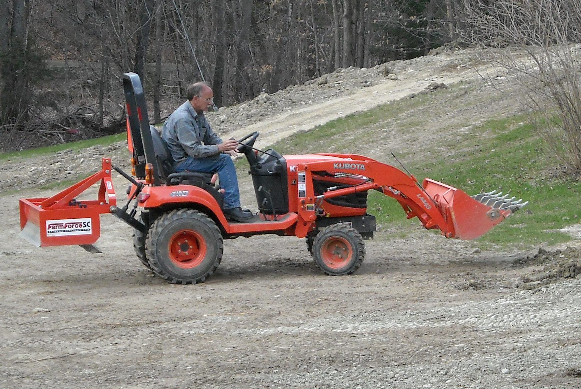

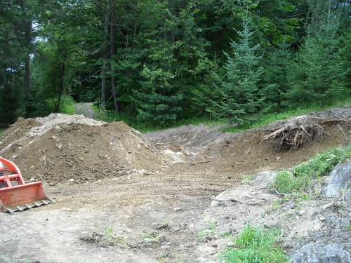

I was in similar shoes. No tractor and I had zero experience with tractors before I bought in 2008. I talked to my local Kubota salesman and told him what I wanted to accomplish. Play in the dirt, move snow, and mow the lawn. I believe he treated me right and sold me the perfect machine. (I told him I did not need a backhoe.)
I have put in close to 400 tractor metered hours on my Kubota BX2660 of fun digging and leveling in my back yard. The entire area in the first photo is now lawn and almost level.
16 plus thousand dollars for the tractor and attachments compared to the cost of hiring 2 days work of a large dozer. Cost effective? NO WAY! Worth the fun of peking at it myself? YES!
As stated from others, I recommend you don't buy bigger than you will want for lawn mowing and maintenance later.
