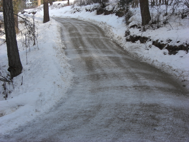

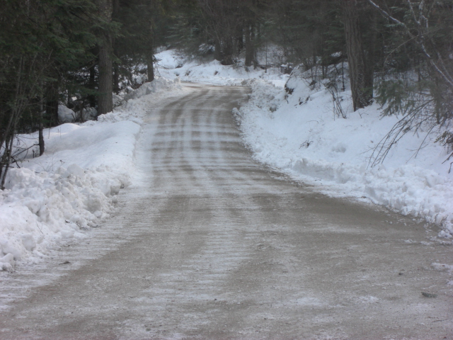

Here are a couple of photos of part of my driveway after I sanded it using a cone seed spreader. It works for me and my driveway is steep, long, and icy.
Craig
