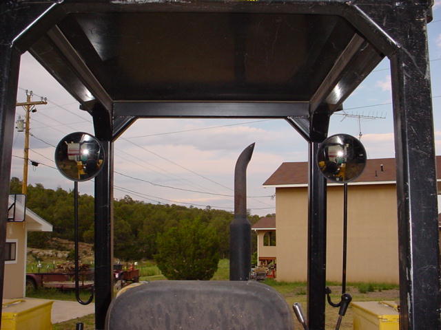

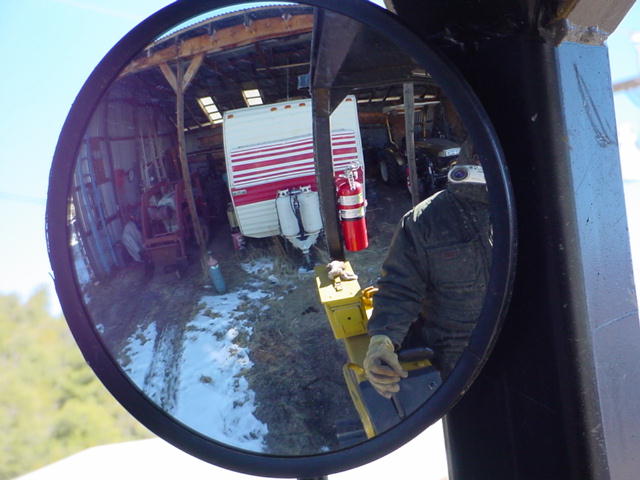

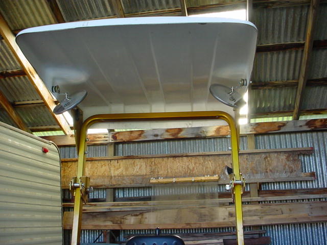

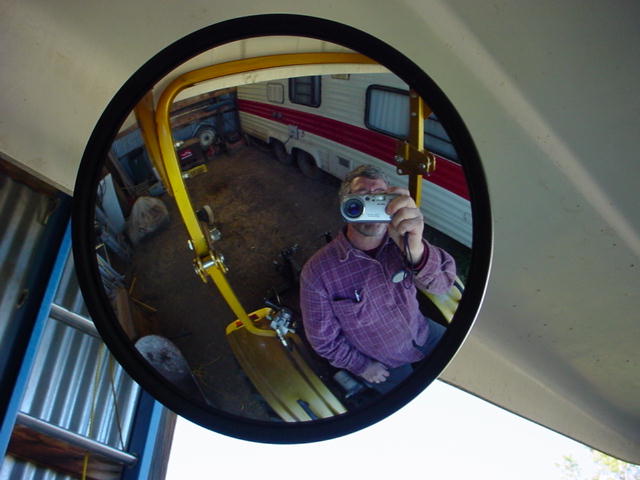

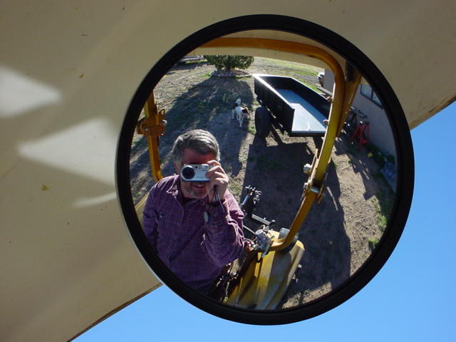

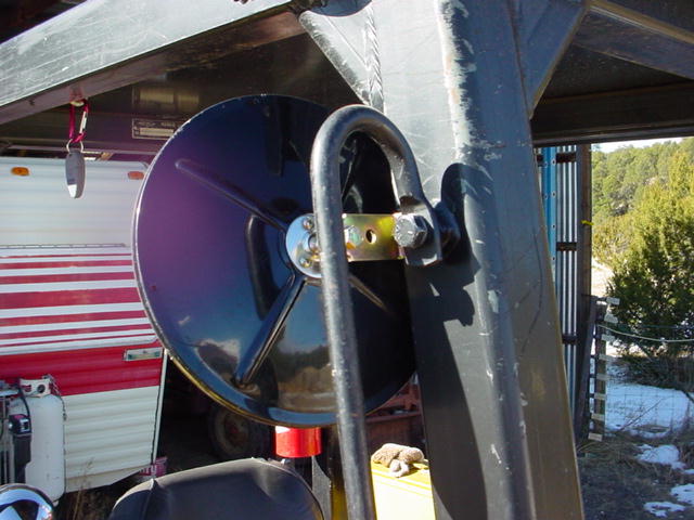

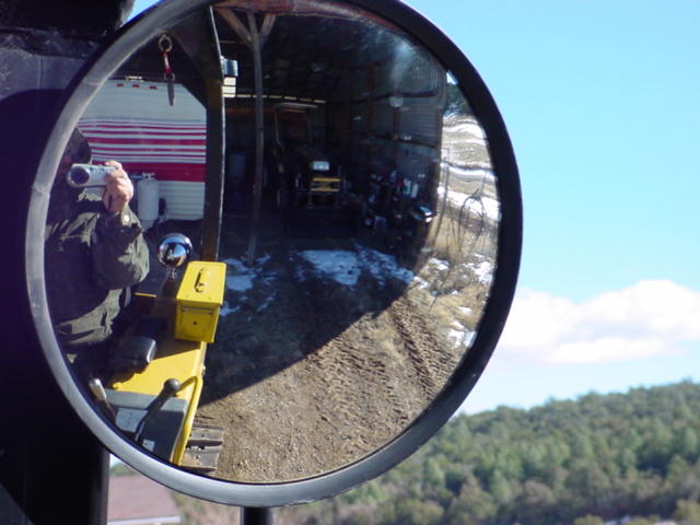

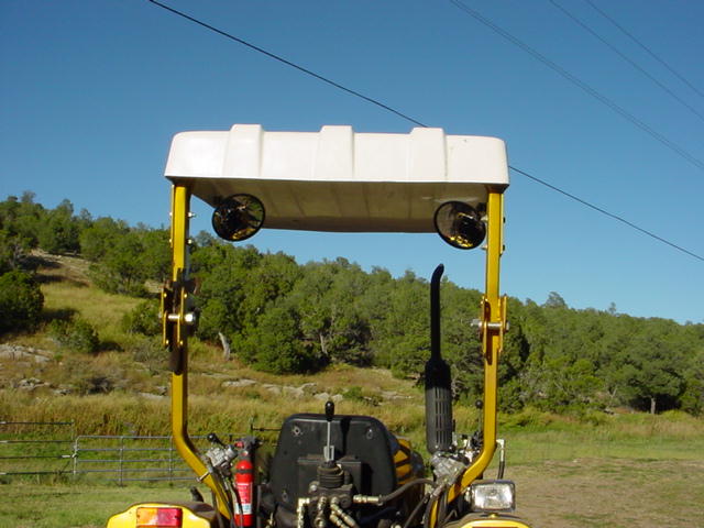

Personally I think the 6" to 8" convex mirrors found in most truck stops like TA (Travel America) for example are the ticket. Seems the convex mirrors don't amplify the vibration as much as a flat mirror. Attached are some picks of my Mirrors attached to the fiberglass canopy of my Jinma 354.
Larry

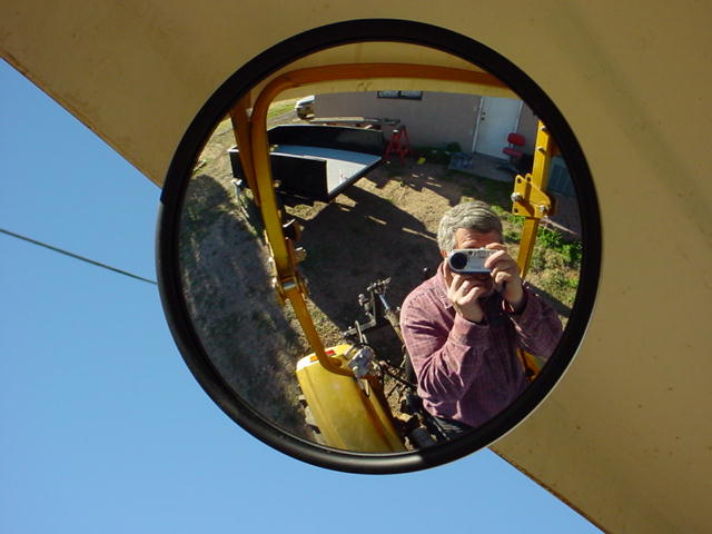

I like them so much I later added a set to my Dozer.....
The closer you put them to you, the less you see yourself in the reflection.

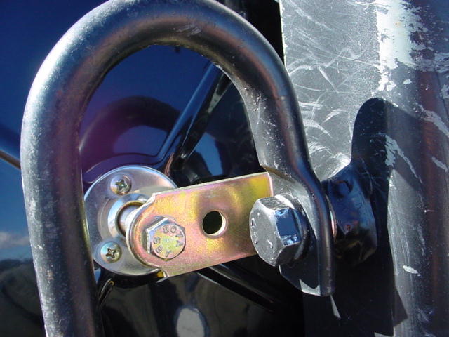

Did that mount come with your mirror or did you fashion that yourself? Application looks very good to me.
/ I need a rear view mirror. #15
The mirrors came with those "L" brackets you might have noticed. I added rubber grommets between both sides of the "L" bracket for vibration dampening and to absorb the "occasional" scraping up against tree branches. I haven't had any issues with vibration, the image is very steady even on my dozer where I did not use the rubber grommets.
