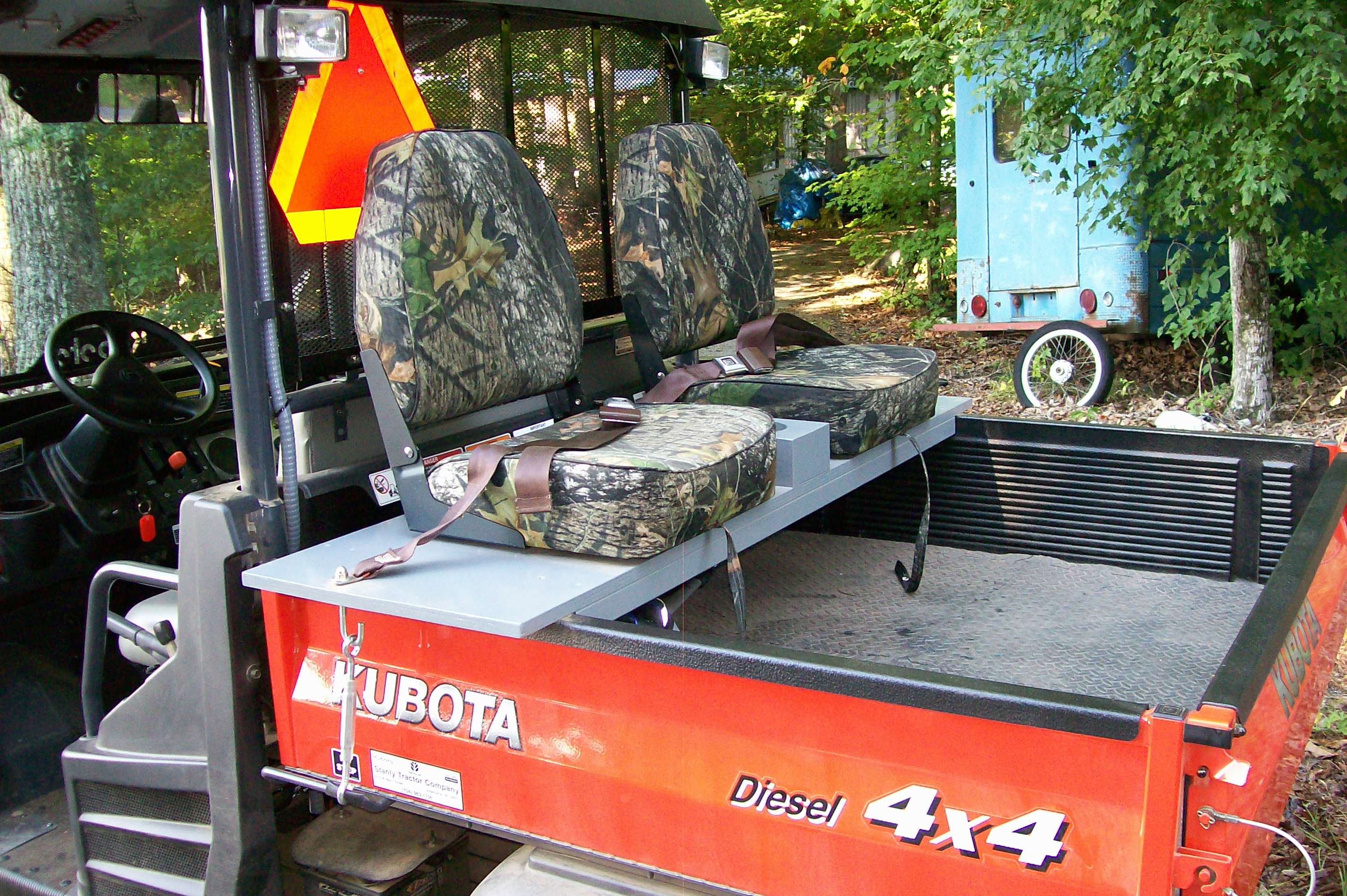

Can anybody recommend a rear seat for an RTV900? I don't want to break the bank, but I want something nice that at least two people can ride on.

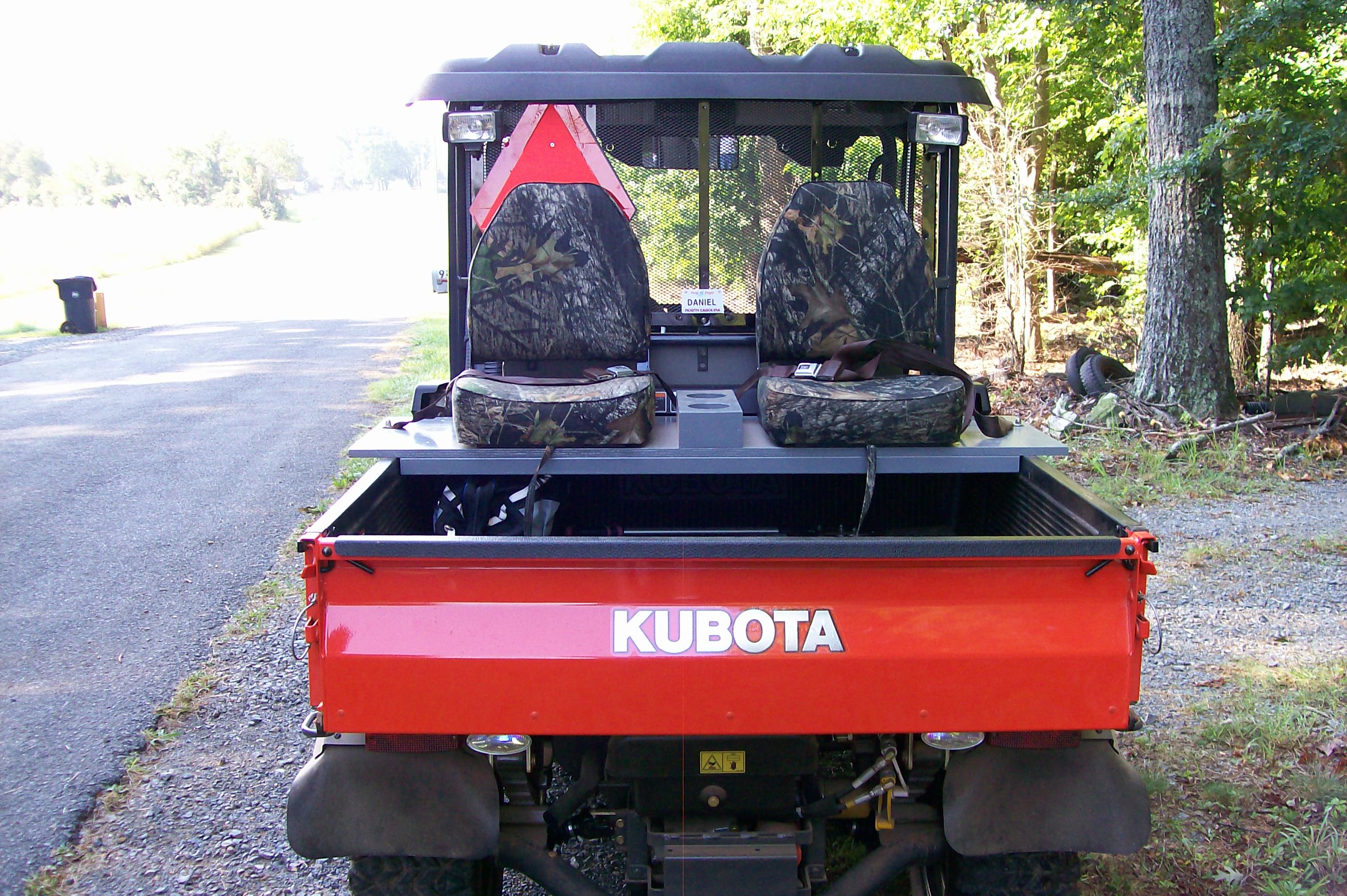

I built one using plywood with 2x4s to strenghten it and added a cupholder in the middle of it.I used some boat seats from basspro.I got the seatbelts out of an old car.Then used some j bolts and turnbuckles to attach it.I did this so i wouldnt have any brackets bolted in the bed it also gives some storage space underneath and its easy in easy out.cost around $120. Hope this helps

I like it. Simple, safe, easy to build, easy to remove, functional and comfortable.
