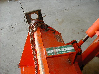

I'm sure that much depends upon how much stress you can put on the hooks, bucket, etc. I used these U-bolts so the hooks can lay back out of the way when I mount the front forks, did no re-enforcing at all other than nuts and washers, and I've even tried lifting or pulling things that the loader could not pick up (put all the stress on them the tractor is capable of) and have never broken or bent anything yet.

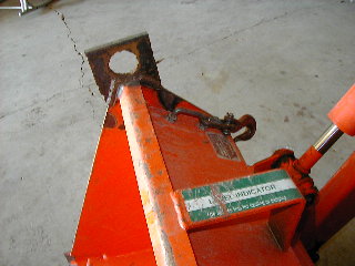

The hooks just swing forward and lay on the top lip of the bucket when I'm using a chain.

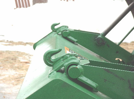

Here's a pic of the hooks on my JD. Gives me chance to try out the new camera. Clevis style. Made in U.S.A. too.

   / I need a hook up #16
That's a good looking arrangement even if it is the wrong color. And the camera works OK, too./w3tcompact/icons/smile.gif
Bird
   / I need a hook up #17
Bird, very cool idea and nice installation. Is that your own idea? If it is you ought to package and sell it. I like how it keeps the hooks out of the way until needed. Been having this whole discussion with my neighbor about putting a couple of hooks on his JD 4100's bucket. You might have just solved the whole thing for him. He was leaning toward bolt-on's, so your hook-ups would be just the ticket.

   / I need a hook up #18
Bob, I guess it was a combination of wanting to keep the hooks out of the way until needed, and wanting to use material I had on hand at the time./w3tcompact/icons/laugh.gif
