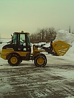

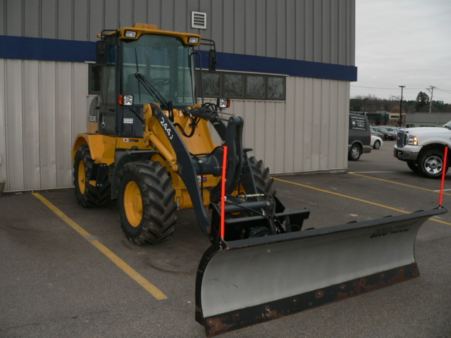

   / I need a better way to move snow... #17
With snow like that you need a blower plain and simple...realistically a bigger tractor too, with possibly a cab.
If you want to move snow with a front end loader then here is what you need...or at least here is what I use to move big amounts of snow.
Good luck on whatever you choose but it obvious you need more for that kind of snow.
Cheers
Dave
