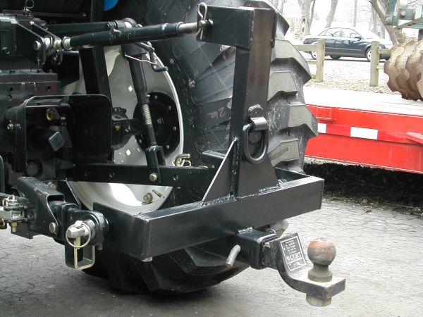

Please, no one laugh at my welds, but this is my first real welding project. I needed something other than a truck to move my trailers around, so I built my own 3 point trailer mover out of 3" channel, and found the square tubing at TSC already predrilled for the ballmount. I also welded the D ring on to loop my chains thru to drag logs and whatever. I can only get better at the welding. /forums/images/graemlins/smirk.gif

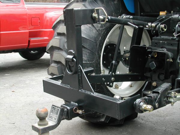

And another! /forums/images/graemlins/smirk.gif

Is there some kind of provision to keep it from raising the 3PT up if the tongue weight gets a little light? Maybe a chain down to the drawbar?

Man, you guys are really pumping my ego! /forums/images/graemlins/grin.gif Thanks for the comments.
Fire344; Thanks, and welcome to TBN. There are alot of talented, thinking people here, thats where I get my ideas for tractor trinkets
Freds; Never thought out that end of it. I don't think it would be a big deal to run a chain from the drawbar to the hitch if needed. All three of my tandems have axles behind the centerpoint of trailer, so at this time it's not much of a factor, but definetly something to keep in mind if any of them might wind up being improperly loaded.
Ron; I got the steel for free from the scrap bin at the plant except for the square tubing. I welded everything except the tubing and gussets in the shop at work. I used my new to me Idealarc 250 to finish at home this morning before it started raining. I really like my $150 welder! /forums/images/graemlins/grin.gif

That looks real nice and I'll tell you what, making something sure beats running beads on scrap for the sake of practice! Don't ask how I know... /forums/images/graemlins/blush.gif ... answer is I really got sick of practice for the sake of it. Much better to build something like you did.
