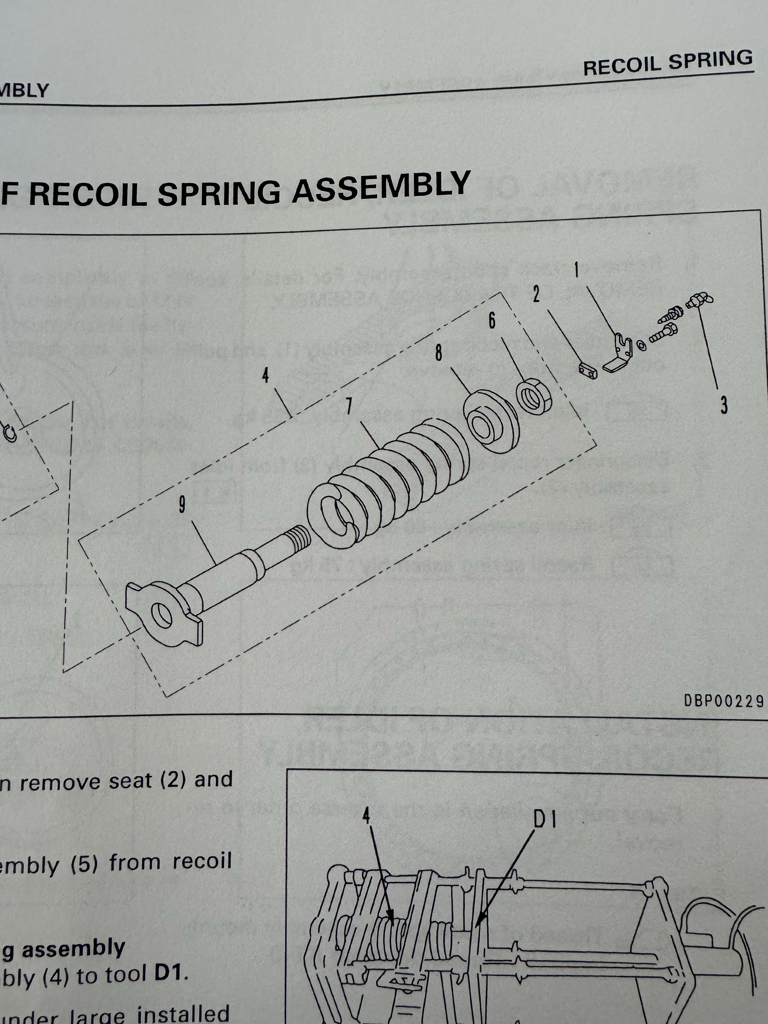

Recoil spring assembly. I found it in the disassembly and assembly section. I definitely don’t want to remove that 27 mm nut. It is the nut on the cylinder. Every page seems to have a warning that the adjustment ccylinder is under extremely high preasure “never loosen the lubricator more than one turn. If grease does not come out, move the machine back and forth. I guess I need to tighten that 27 mm nut back up and find a way to put some better pressure against the track and idler. The bucket is adjusted to just barely reach it. I think I will get a good solid log and use the bucket and thumb to push against it like “letsdig” does in this video. I’m tempted to try propping the excavator up like he does. I dont have the skill to roll the link up onto the idler like he does.

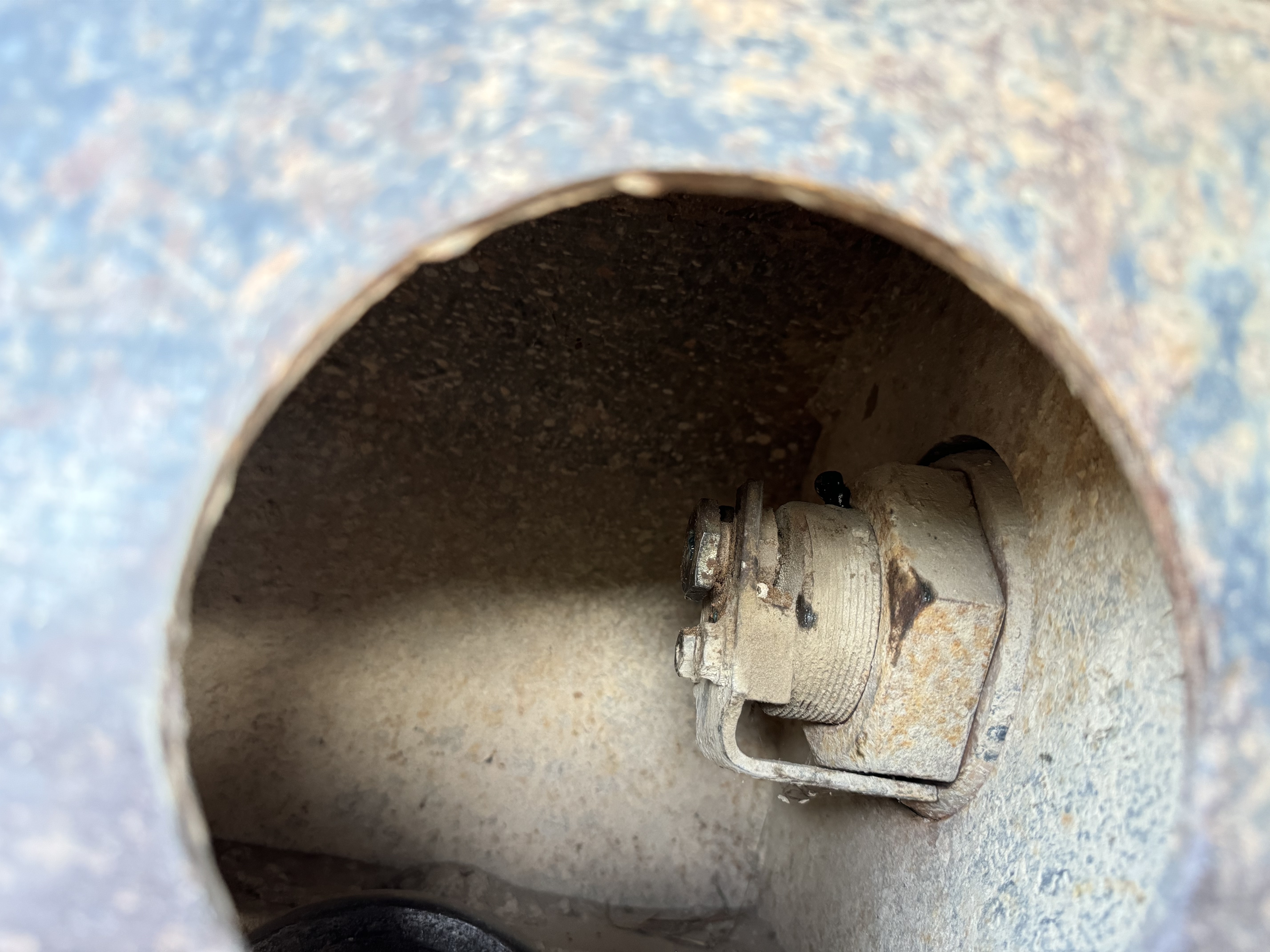

I am reviewing my photos and I think I was incorrect about the bolt. I also see some grease coming out in a later picture.
This is the assembly diagram
I dont think the 27 mm nut that I was turning is represented well in the diagram. #6 is the massive nut on the right in the following picture and that is probably75-100mm.
If you look carefully you can see some grease at the top of that picture on top of the threads. I need to go back out there and check. There may be a relief hole there and turning that 27 mm nut may have opened it. The fact that there is no old grease on this tells me it is a result of something that was done yesterday.

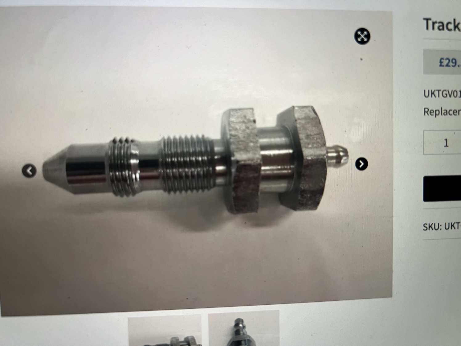

The number 6 nut is the really big one that goes around the whole thing. You definitely don’t want to loosen that one. The correct bolt is possible labeled #3 but it looks more like the pointed one that lays between #1 and #3 that’s not labeled. The one that has the grease fittings in the end is the one that needs loosened. It looks like it already has been loosened some and lost a little grease. Maybe remove the bracket that’s encasing it and remove it completely if the tensioner still won’t go back. You shouldn’t have to remove the bracket though. If it’s backed up as far as the bracket will allow it should let the tensioner go back. This is a picture of the bolt that holds the grease in.
