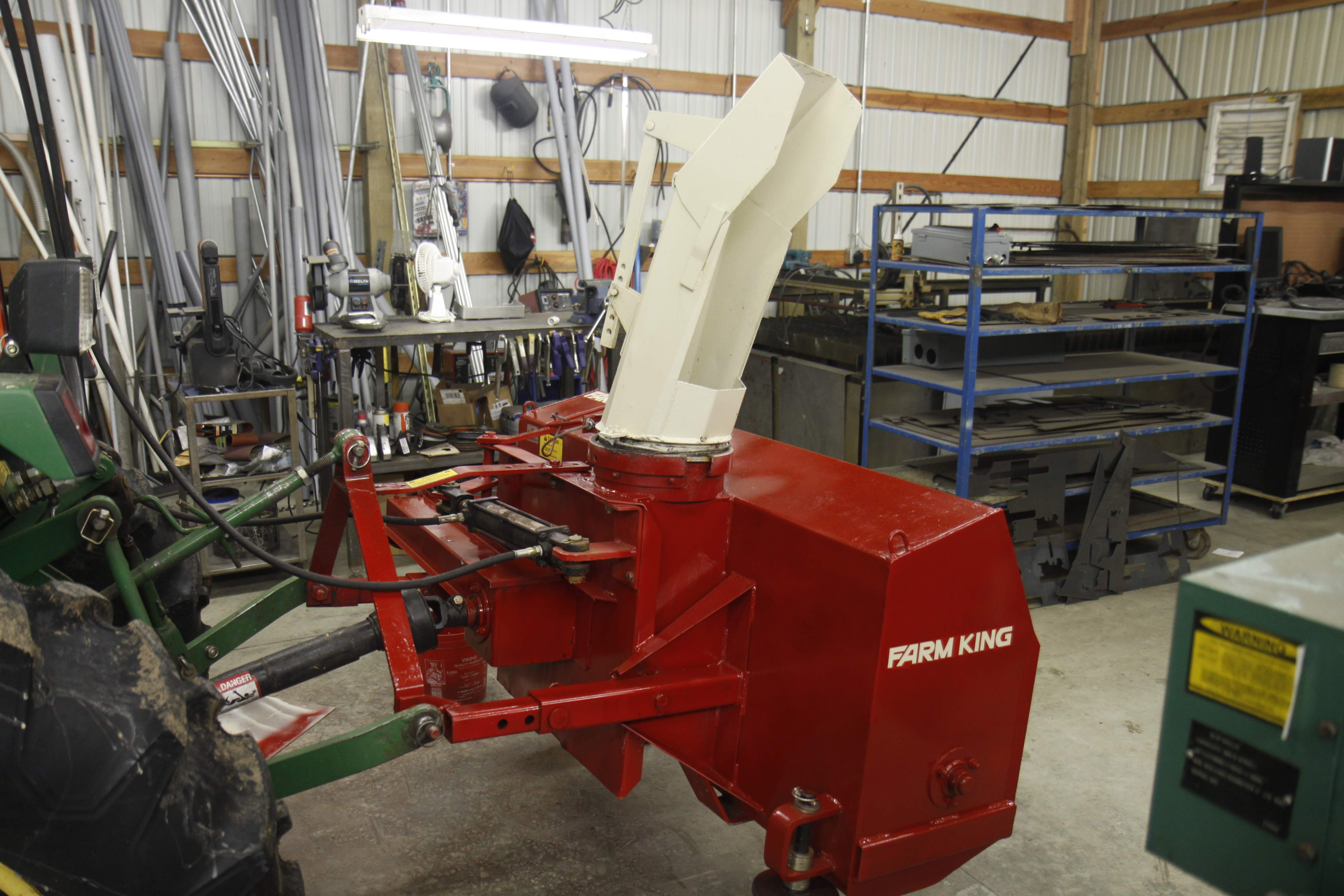

I had a 60" farm king blower for my old JD870. It didn't have any skid shoes either, and i have a gravel driveway. I used it for many years without any skids and had no problems. i just had to wait till the ground froze enough to hold the gravel in place. I finally broke down and got a set of weldable skid shoes from my JD dealer (about $40/side if i remember right) . Easy to install and it stopped me from shooting gravel when the ground got softer. The shoes really helped.

I had one of those for quite a few years and I think you will find the skid shoes are integral. Look at the bottom of the housing and you should see two skid plates welded on that taper to the leading edge. If you want to clean right to the surface, like clearing snow off ice for skating, extend your top link until the leading edge is on the surface. If you are clearing snow off the gravel driveway then shorten the top link to rock the blower up on the skid shoes. Worked for me. I used to clear a huge area off for skating when the ice was good and had a crushed rock driveway. A hydraulic top link is great for that setup but even the screw type top link isn't bad.
