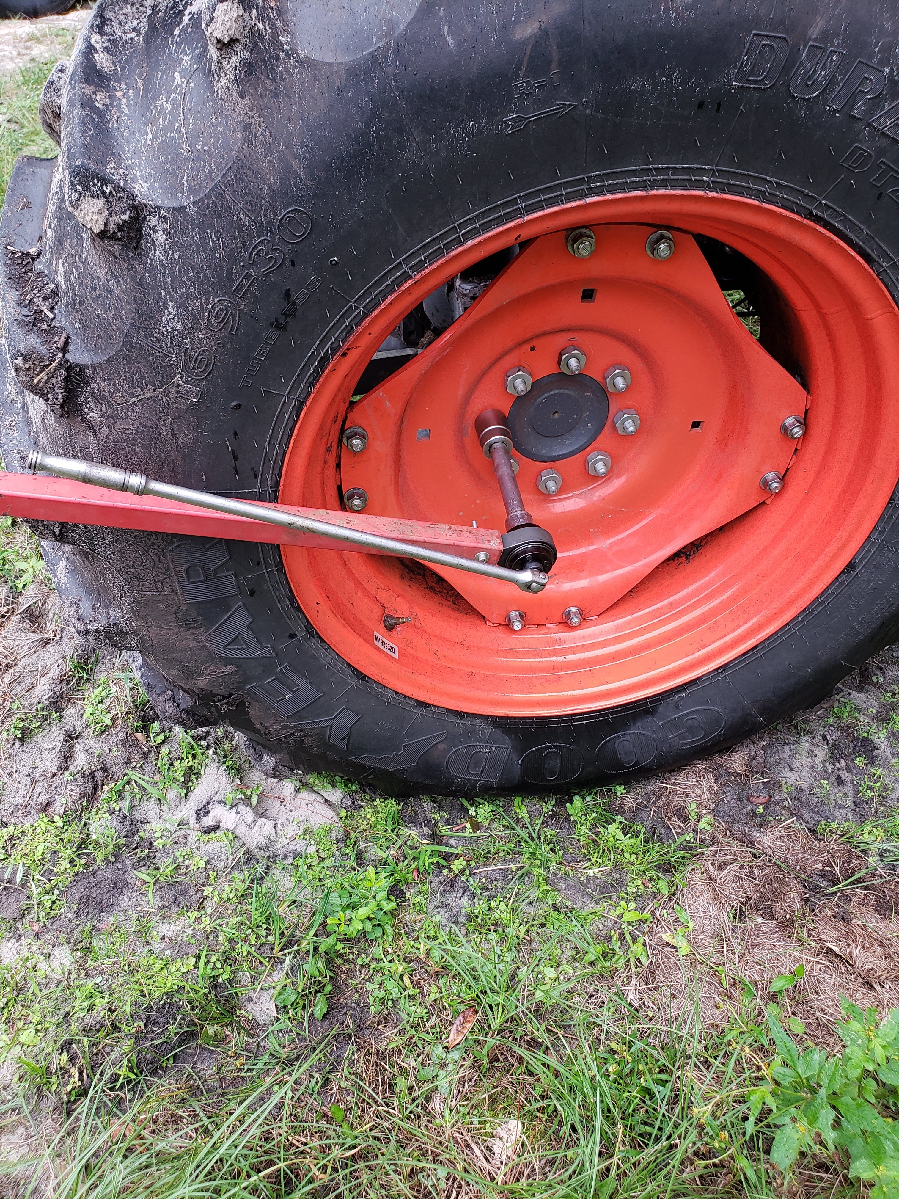

I keep breaking 1/2 ratchets on my lug nuts.

A good 1/2" ratchet should easily handle 90 - 140 ft-lb. of torque, the specified range for most lug nuts, but that's not your problem. With a 6 foot lever on the damn thing, you're very likely exeeding those numbers, several times over.
If you really need so much torque (600 ft-lb?) that you're putting 6 feet of pipe on the handle, then yes... a 1/2" ratchet is not the right tool. But what lug nuts are you facing that require this sort of torque?
They are 24mm and that is how tight the dealer had them, i'll get a breaker bar! i was always under the impression that the larger ratchets could handle more but breaker bars are cheap.

I sometimes use a short cheater bar, not necessarily to exceed the torque but to make it easier on this old man's arm.
After you have twisted enough bolts, you know how far to push the tool, and the bolt.
Ratchet is not to break loose hard bolts. It's to make removable easier after using the breaker bar.
I learned from breaking more than my share of ratchets.
You are right it's just the only tool i have at the moment. I ended up trying the impact and it could not get them loose. Just need a bigger one :)

I looked into this years ago, and the break-out force on most of the better 1/2" ratchets seemed to be around 500 ft-lb. I don't know what 1/2" breaker bars are rated to handle, but spent much of my late teens and early 20's bouncing and jumping on the end of a 4' pipe extension slipped over the handle of mine, and it never broke (back then... it has since).

harbor freight and craftsman have broken on me getting lug nuts loose. I am rough with them using a 6 ft pipe.
I do have a impact driver maybe that will work better.
Those Lugnuts may have been overtghtened with an impact therefore breaking ratchet.
I have had Lugnuts extremely over tightened at the tire shop. Some of those guys use the impact without ever checking torque. They also often too lazy to hand start Lugnuts, they jam the Nut in the socket shoot them on and cross thread studs making life very difficult for you down the road.
I try to always use six-point sockets on Lugnuts.
Sometimes the blue tool can save your butt with heating up overtightened nuts. ( gas welder

I bought 3/4” and 1” sets for that. But even with those, you need to be using a breaker bar.

Good cordless impact or pneumatic impact saves a lot of work.
Nice spinning out 3/4" bolts with no effort. If the impact won't move them, the 3/4 drive breaker bar and cheater piper comes out.

I broke two crapsman half inch breaker bars getting the nuts loose on my loader tractor, used a Proto half inch to get the job done.
I turned them in to Sears and got two more new crapsmans in trade, twisting them off next time I was working on those same nuts. SO, I bought a new Proto 3/4 drive socket the right size and have used my 3/4" breaker bar with that socket ever since, with NO breakage.
BTW, using the 3/4" breaker bar with a reducer to 1/2", just twisted off the half inch end of the reducer (two of them) and NO ONE would warr. them!
