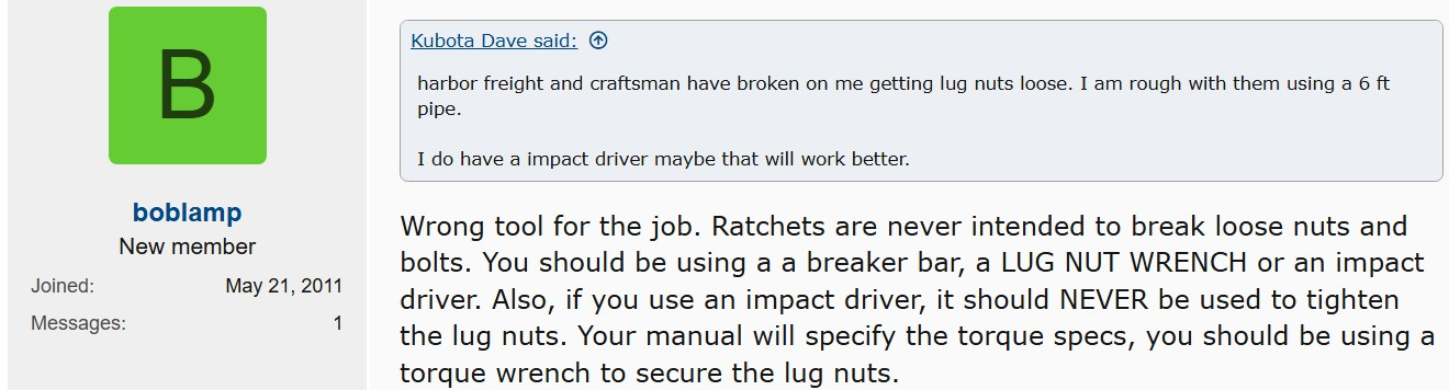

I keep breaking 1/2 ratchets on my lug nuts.

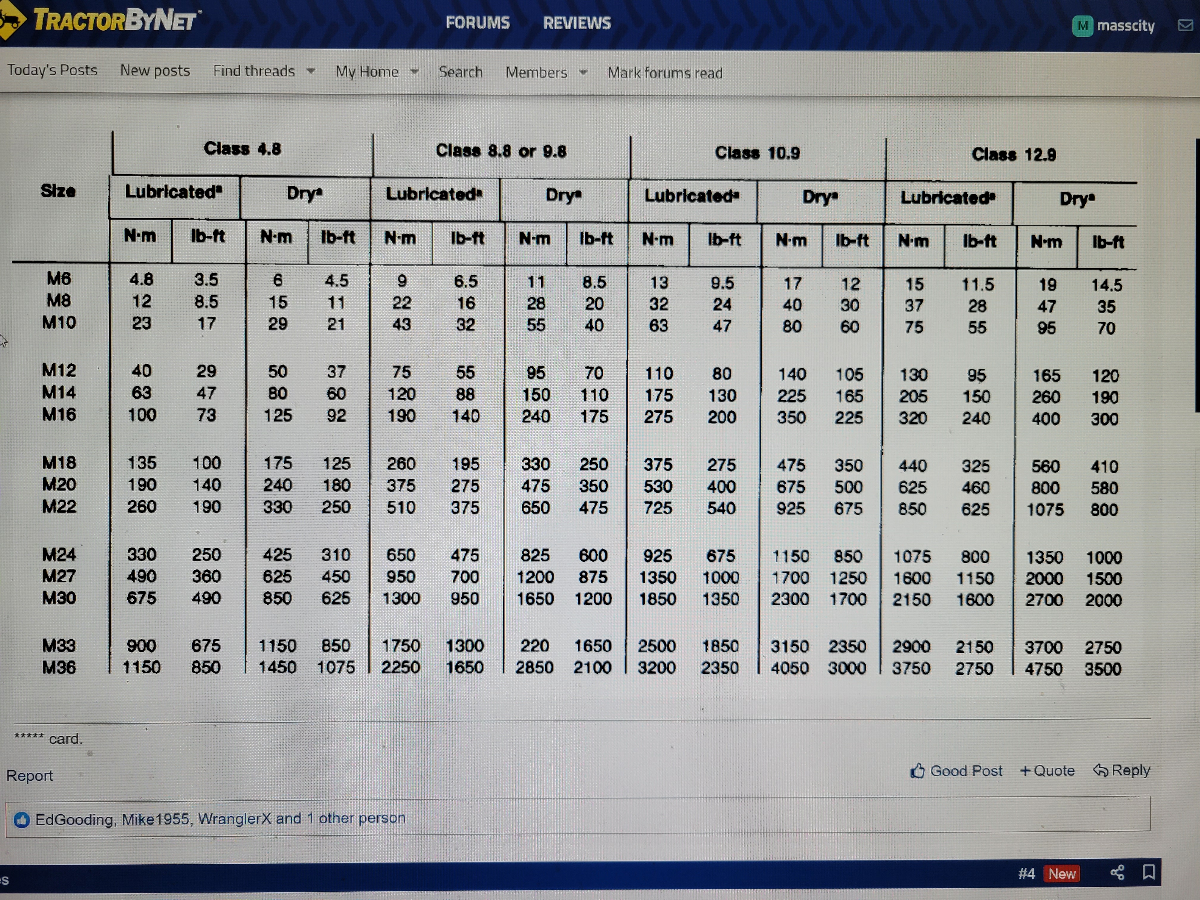

Always keep in mind that with steel wheels, the lug nut holes are 'coined' or stamped in the wheel and overtightening them will distort the coined in flange and the deformed flange (from over torquing the lug nuts) will prevent the lug nuts from achieving a secure contact with the raised portion. Why it's imperative to only tighten the lug nuts to the specified (in your owners manual torque value) and that also applies to a motor vehicle as well, in fact any stamped wheel on anything. That really applies to alloy wheels. Lug nuts on any wheel are always torqued DRY and not WET torque and by wet torque I mean no never seize on them. When torquing any wheel, always do the final to torque setting in a staggered manner.

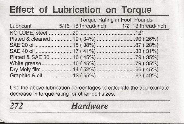

Actually some wheel manufacturers specify lubricants on the lugs.

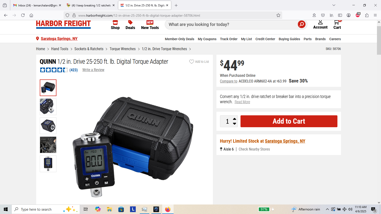

HF Earthquake works for this 74 .
Works for me! One of those tools where you say "I should have bought this years ago!" I had to go to 3/8 air couplers to get the claimed performance. Used only for dis-asssembly. Effortless compared to a breaker bar! And HF's black impact sockets.
For re-assembly: hand-start, then cordless screwdriver on the socket then finish with torque wrench.
a deflecting beam type torque is the most accurate of torque wrenches.
I have two beam type torque wrenches, a (American) Craftsman I bought new decades ago and a vintage Proto.
I use them to verify my $11.99 Harbor Freight click torque wrench a couple of times per project.
So far, all three match. Yes I release the tension on the clicker between uses!
This is something that really should be required from all manufacturers. My inner engineering nerd smiles whenever I see a torque table that includes both "dry" and "lubricated" values for an assembly. Engine assembly manuals usually include this, but very little other things in the consumer market do.

Dry rusty fasteners can be very difficult to install & remove. A dry fastener will often not torque up smoothly often resisting torque then snapping loose as more torque is applied which can be painful and break tools.
I always clean & lubricate my lug nuts or screws before assembly.
I always use a torque wrench when installing wheels.
Torque specs are generally for clean dry fasteners so I reduce the torque setting to avoid over torquing.

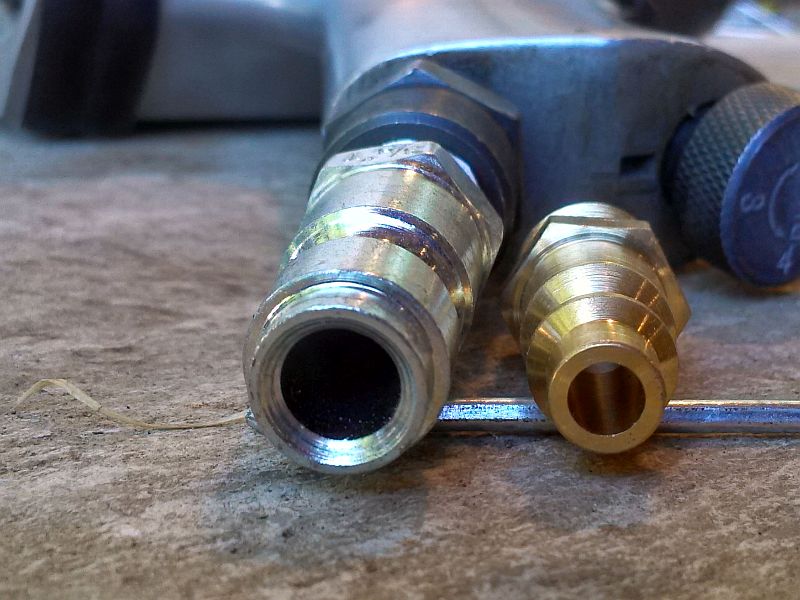

Pro tip: Do not run a 3/4" or larger impact, on a 3/8" air hose. You lose much of it's power if you do. You need a 1/2" hose, and high volume couplers.

You need adequate CFM as well and no 'wenie' air compressor will be capable of delivering adequate CFM to run any air hog tool like a 3/4 or 1" drive impact. Why we have a minimum 35 CFM @ 135 psi air delivery in the shop and contrary to most opinions about compressed air delivery, 135 psi is more than adequate to run any air tool, so long as the delivered CFM is available. Your compressors as well as your entrained moisture will be a whole lot less at 135 psi as well and I run an IR Refrigerated air dryer between my Quincy QP reciprocating compressor and my main air supply line as well as point of use filters (Motorguard 2 micron) on the plasma cutters. You'd be amazed at how little downtime is required for removing carbon from the compressor valves when running 135 psi, versus the normally set 175 psi, plus the compressor will last a lot longer, use less electricity and produce less entrained condensation. I also have a timed condensate valve on the bottom of the receiver, that way I don't have to manually drain the receiver.
