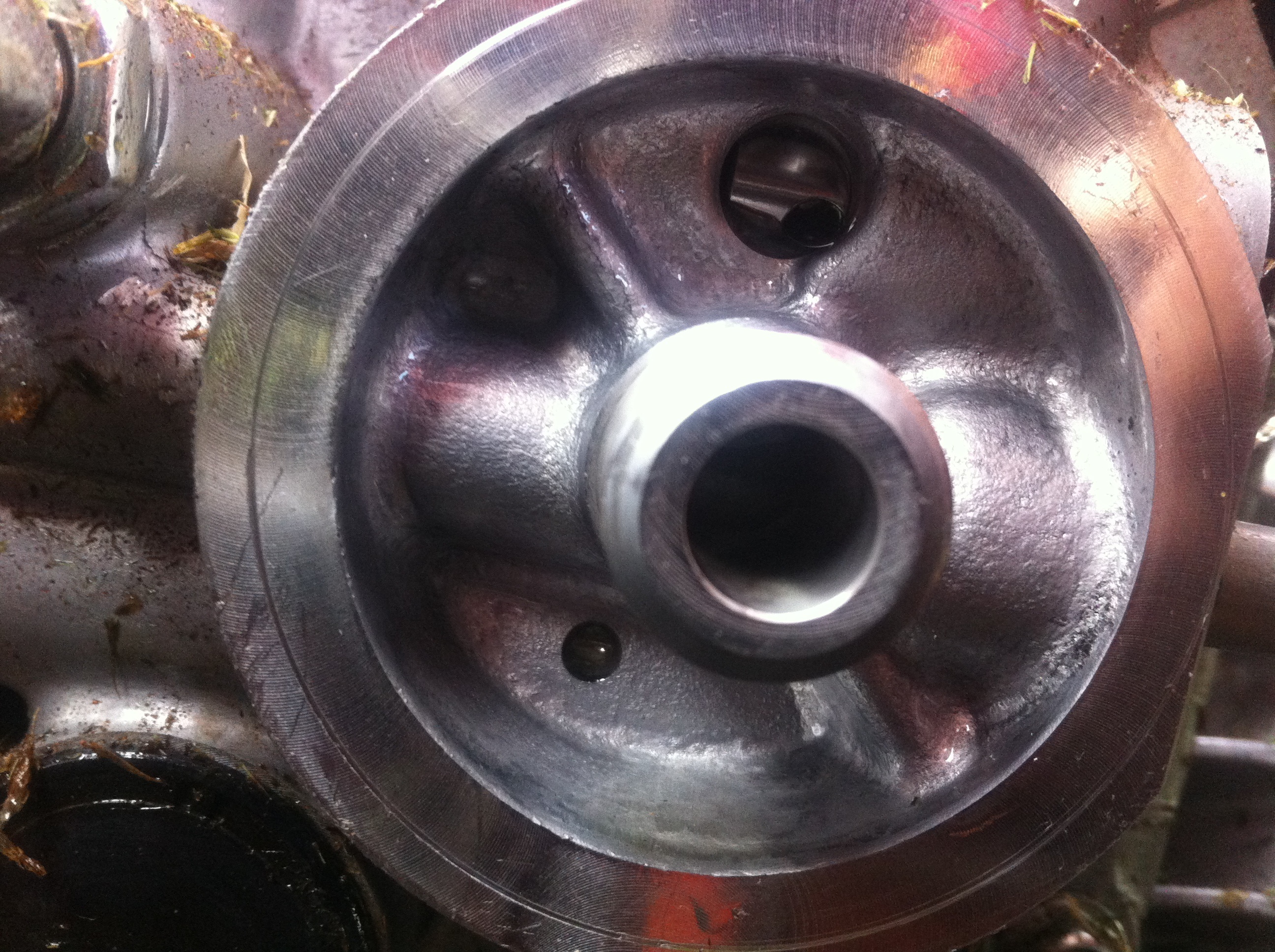

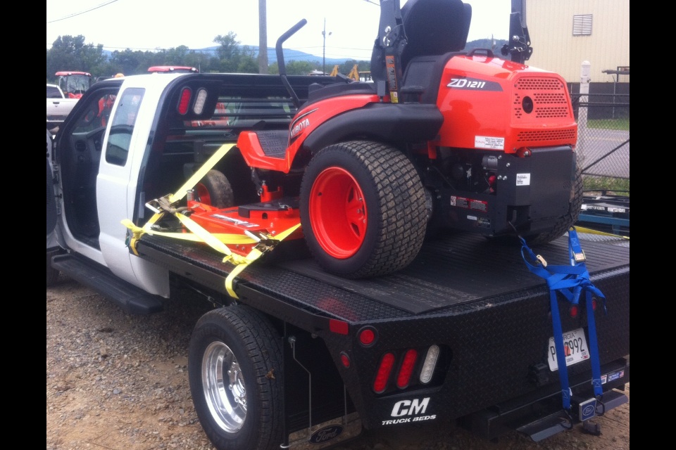

I just unloaded my new ZD1211RL-72R rear discharge mower tonight& it's pourin Hyd Fld
Mowed 30 mins & it's leaking 1/8" solid stream of Hyd fld from under Hyd Filter.
Filter was so loose I turned it with 3 fingers. I tightened it & it's still pouring.
I'll call dealer in am & remove filter for a look see.
Man I Love the mower & it's cut with the Rear Discharge.
I've been mowing with rear finishing mower behind a JD tractor since 2001 with RD.

Re: I just unloaded my new ZD1211RL-72R rear discharge mower tonight& it's pourin Hyd
I can feel this line in the sealing surface with my fingernail.
I hope it ain't a crack.
I'm headed to get a new filter but o ring on original one looked fine.
You zoom in on that pic and it looks like the whole raised top area has hairline cracks showing up around the port.
Or maybe I am just seeing too much. Check it out.
   / I just unloaded my new ZD1211RL-72R rear discharge mower tonight& it's pourin Hyd Fld
Those are swirl marks from the machining process.
New filter DIDN'T fix the leak.
I cleaned & watched with a mirror & flashlight while running.
The O ring on steel line right beside front Hyd Filter, was pinched & wasn't seated into recessed hole.
I replaced O ring & barely bent line to push it firmer into the hole on trans.
Bingo - I've mowed 1.5hrs w it & Absolutely Love it.
