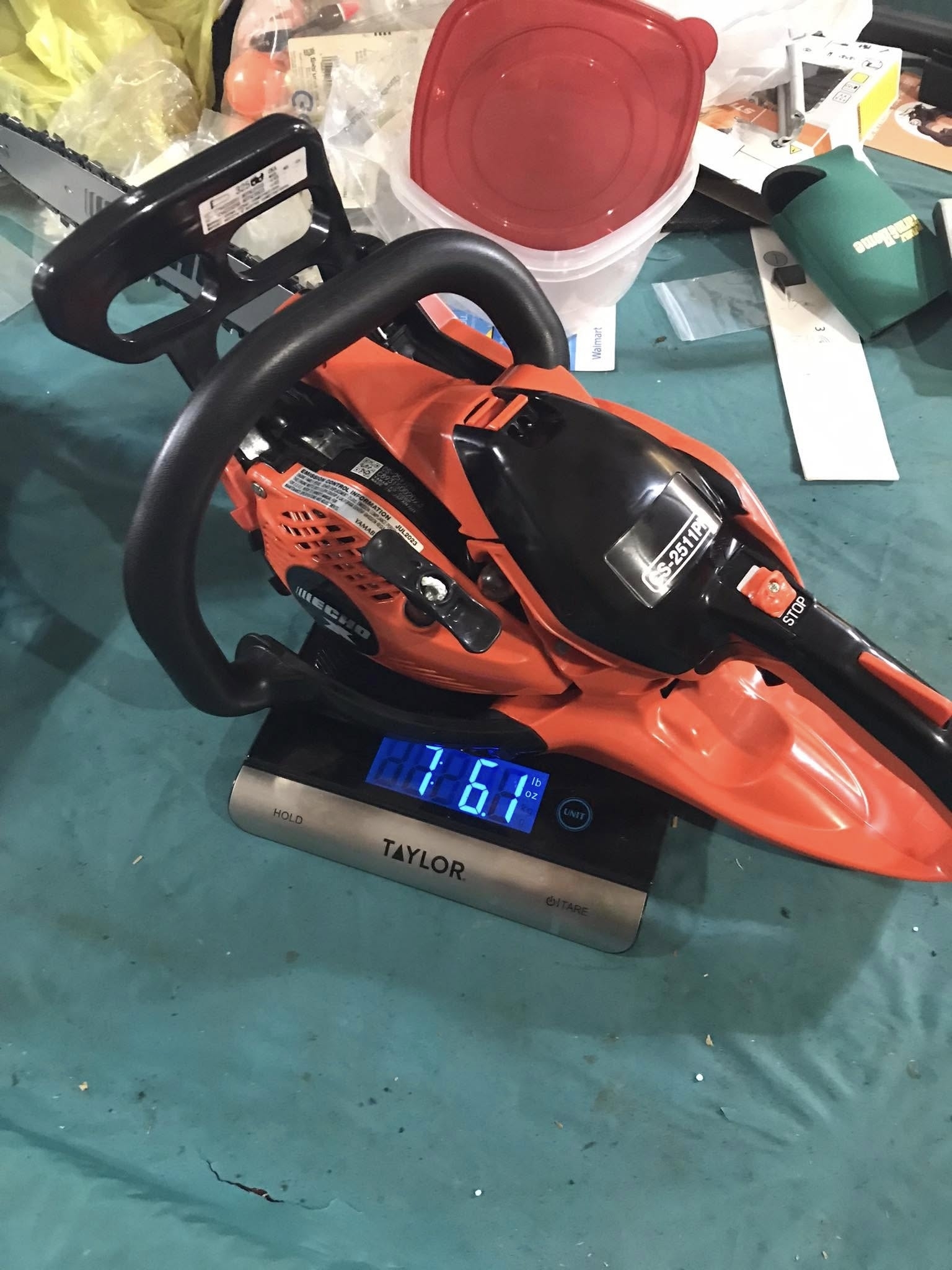

Dont ever grab a rear handle version. You will regret it. 😁 :ROFLMAO:
Makes 50cc light weight saws feel heavy.
As used filled up, 12" nano set up.

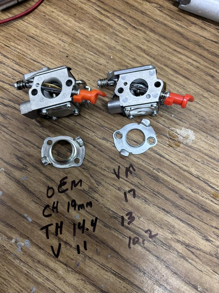

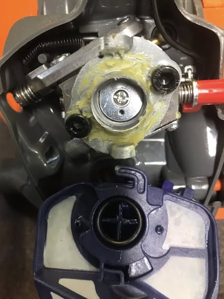

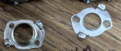

Clones are open port like stihl 200T is. But still great runners. Prob helps keep cost down that way. OEM is closed.
Carbs are smaller on clones with smaller air filter mount area and filter. Make sure they send you right air filters. I seen one clone company sending them out with wrong size oem filters neojunk I call that clone company. I tried buying from them once. Worst ever. About 10 years behind farmertec stuff.
I always grease around air filter fittings oem and clones on echo stuff.
Mix of oem and clone pics of folks in my group and me.
View attachment 3780999View attachment 3781000View attachment 3781001View attachment 3781002View attachment 3781003

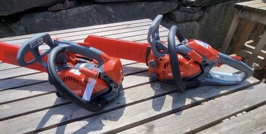

There is but only sold overseas right now.
V-modest in my group said they are going to do a rear handle version for us FS here in states. That means others will follow.
Possibility around this fall. Crossing my fingers for that.
Will buy 2 more. 1 for me and 1 for dad.
Here is the clone rear handle sold in Ireland I believe it was.

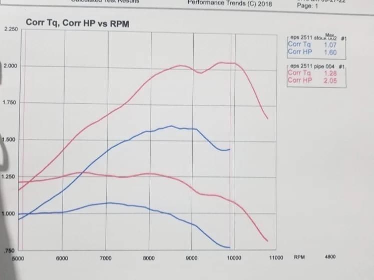

Egan pipe only thing it needed. 28% gains on OEM
That other CNC muffler from west coast cant touch that. Be like modding the oem muffler then.

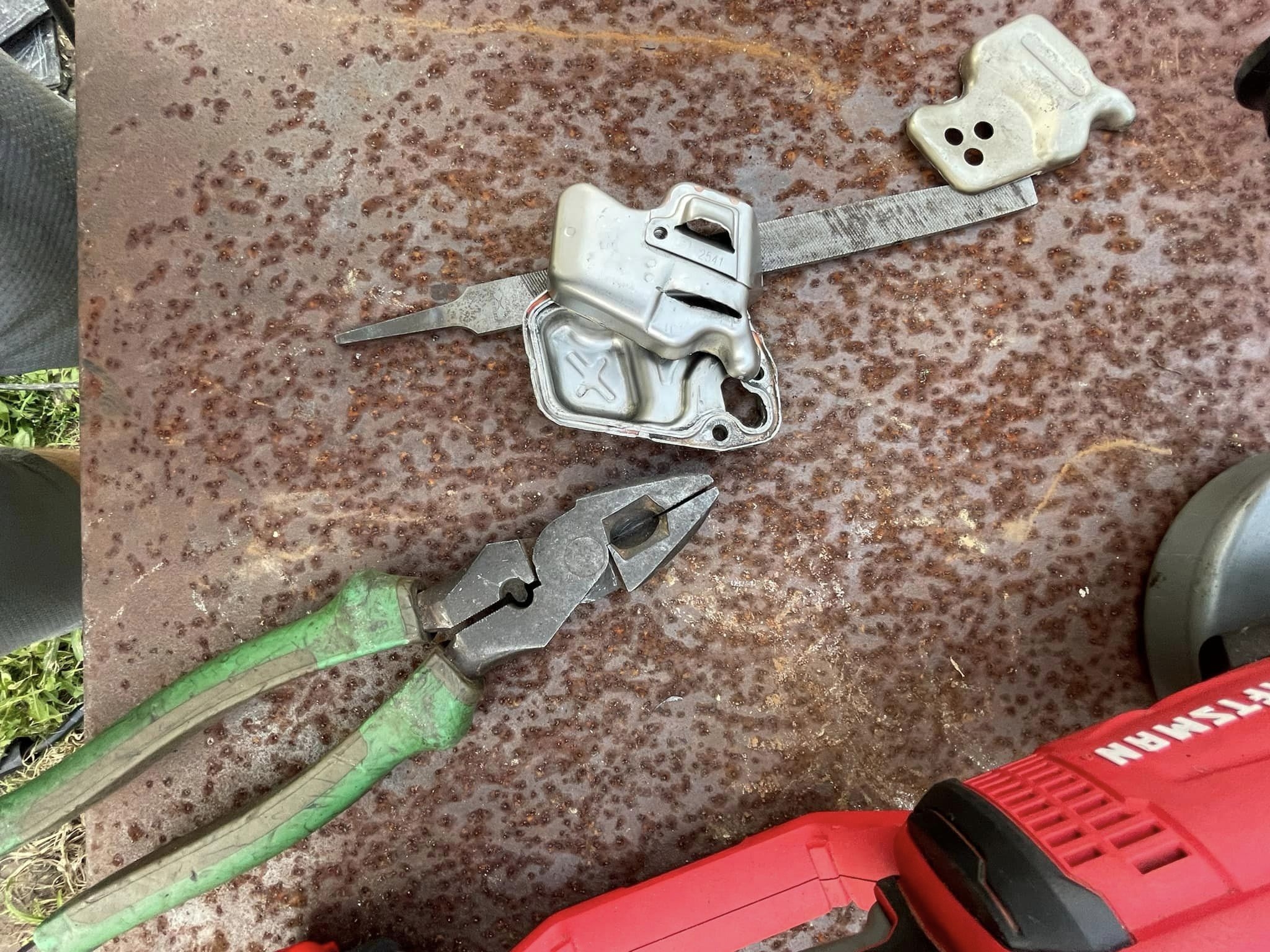

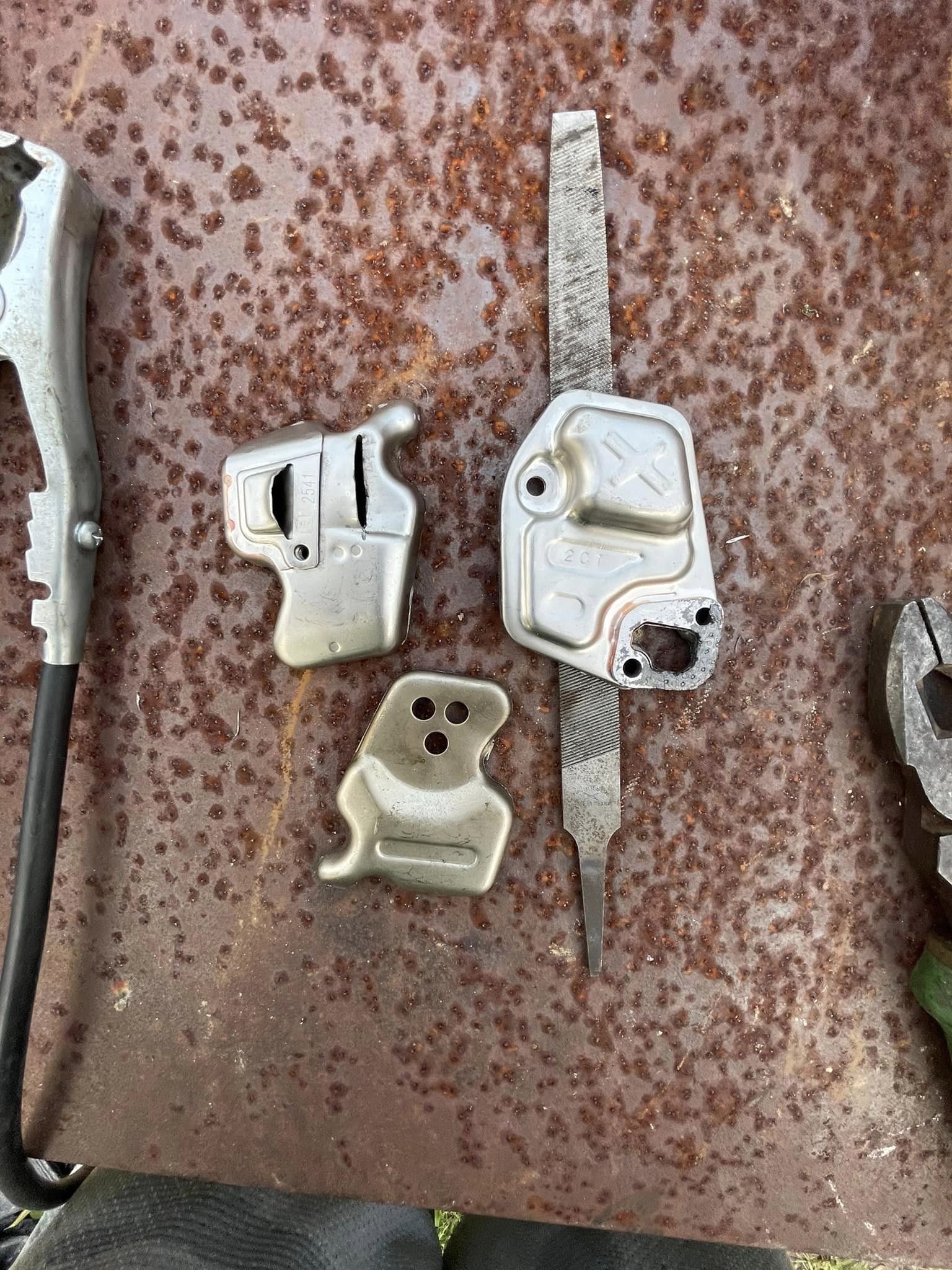

OEM mufflers are so stuffed up.
Locals muffler he did.
He added extra exit opened other and removed the baffle with 3 small holes in it.

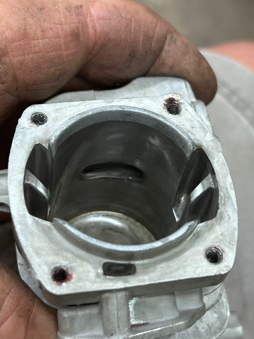

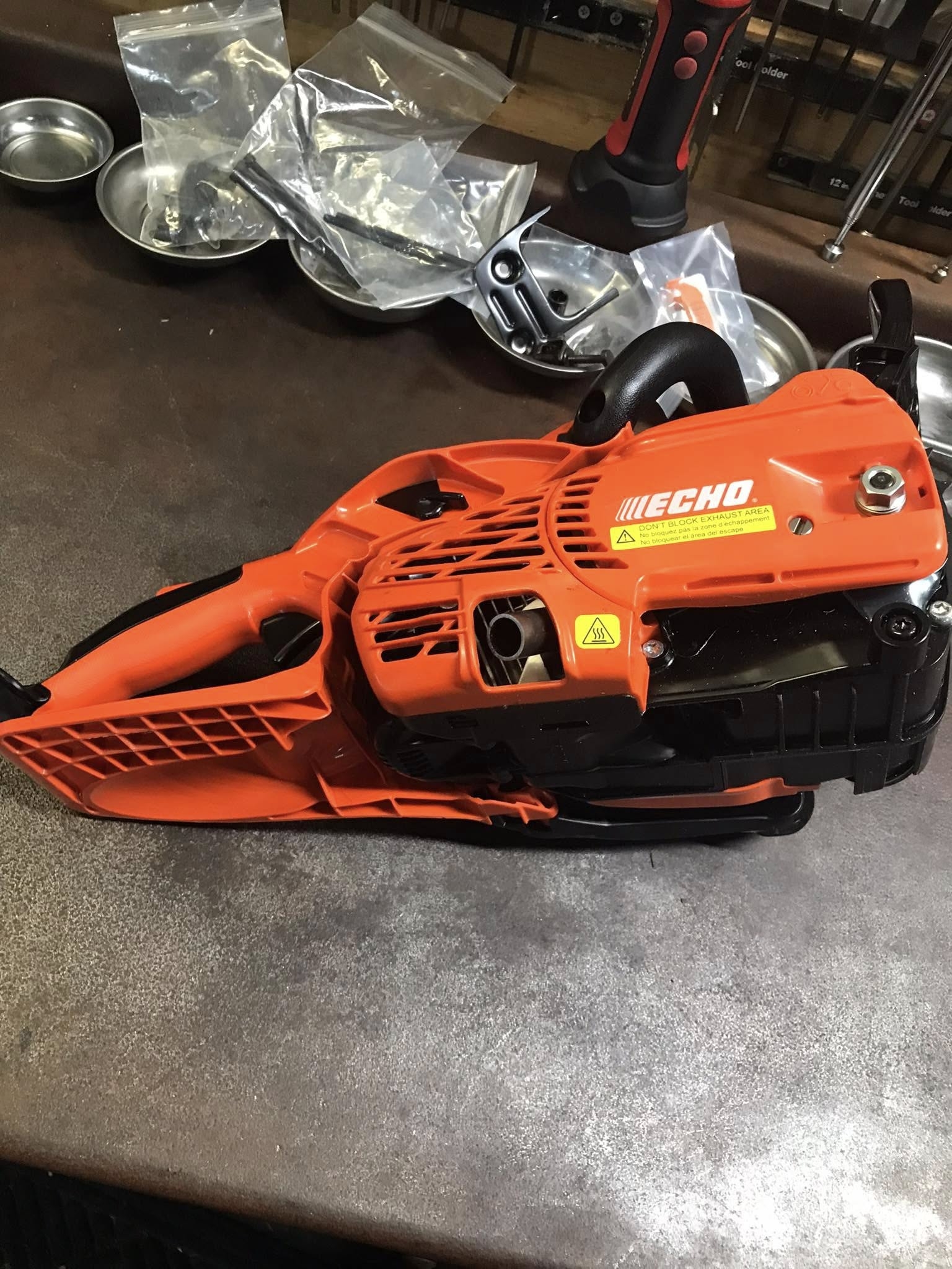

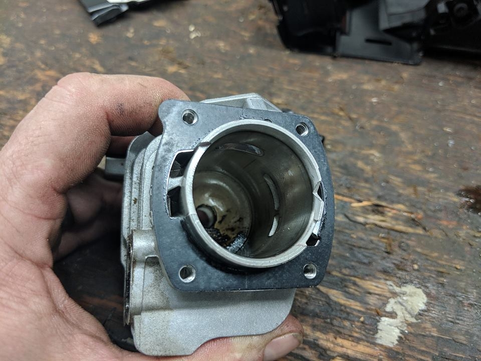

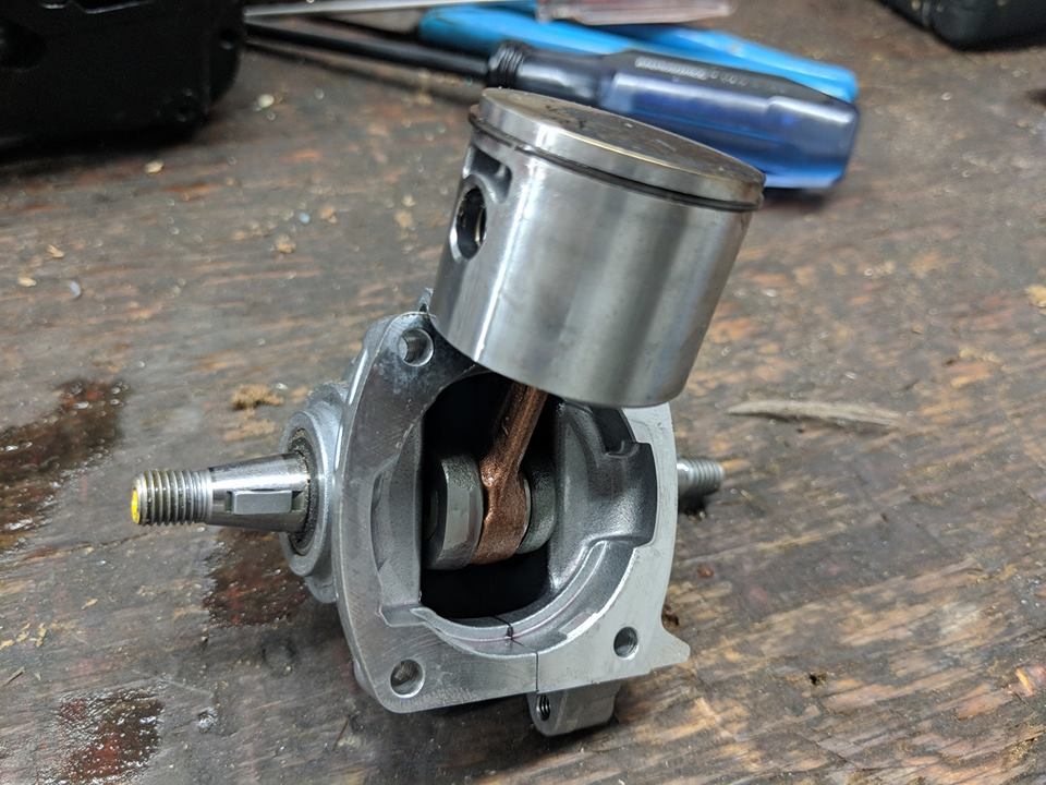

@JeepHead clone 2511 pulled down in my group for porting.
So you can see the open transfers like stihl 200T style.

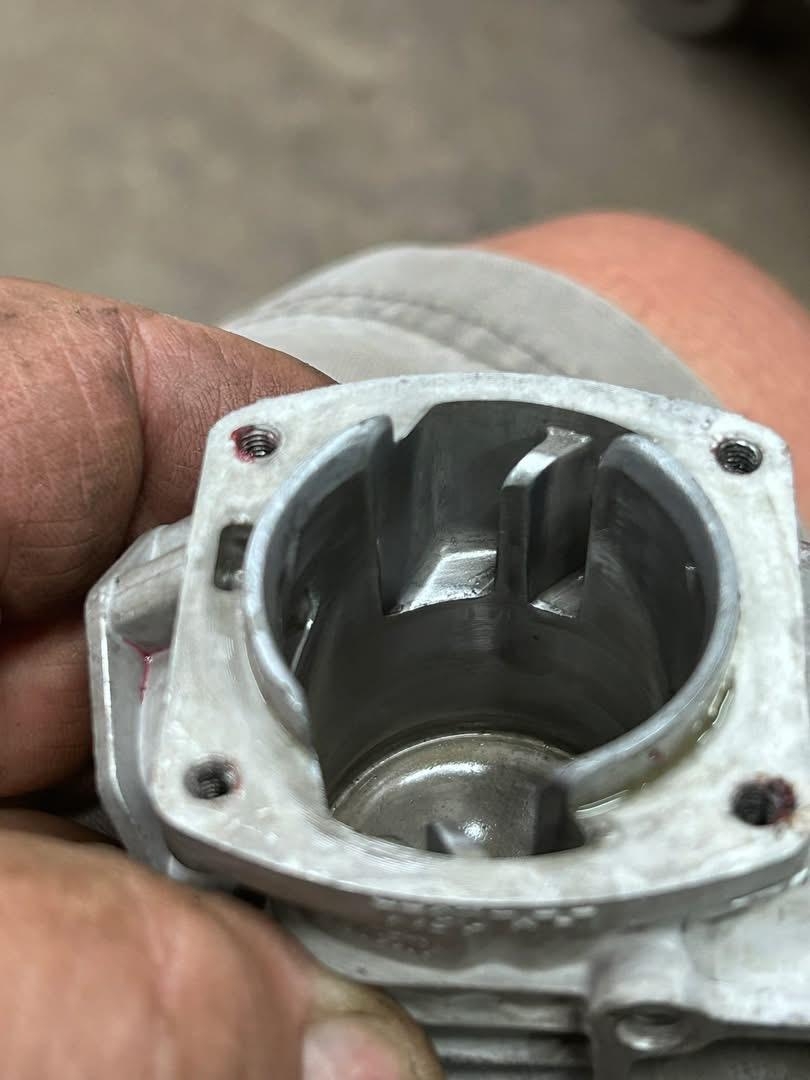

Stihl 200 oem cyl.
