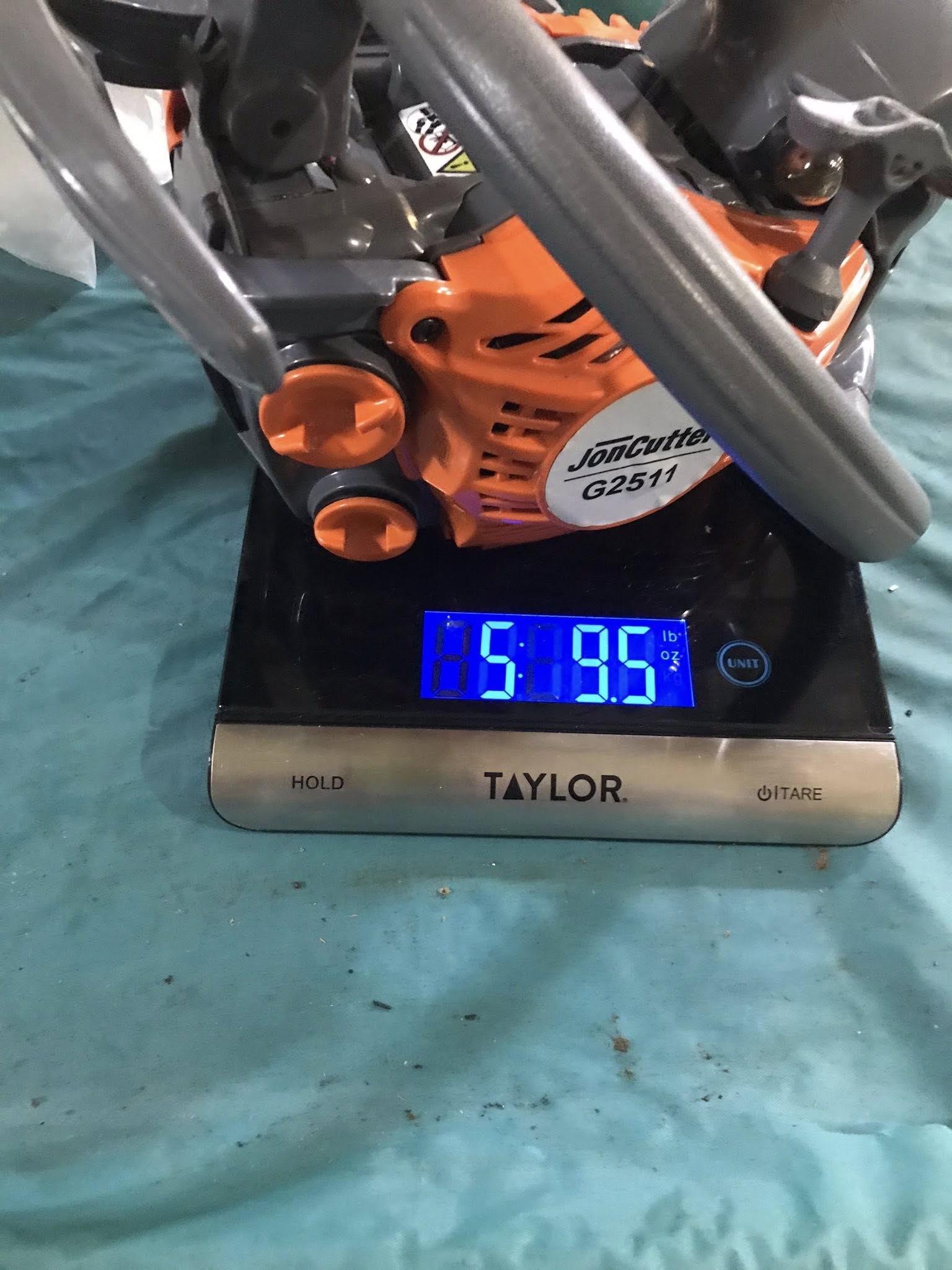

Only like 4oz more then oem. Part of that is extra bar stud 2 instead of 1 and extra bar nut. Prob a couple oz right there alone.
Bet clone muffler makes up rest being a better open muffler with pipe.

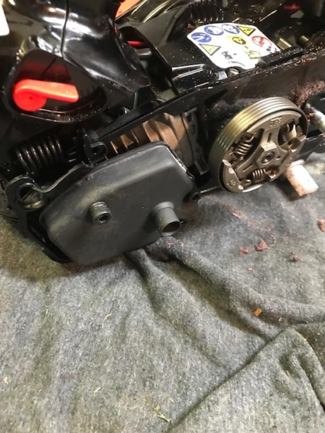

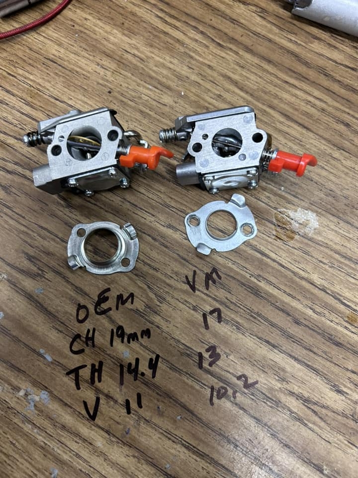

Clones are open port like stihl 200T is. But still great runners. Prob helps keep cost down that way. OEM is closed.
Carbs are smaller on clones with smaller air filter mount area and filter. Make sure they send you right air filters. I seen one clone company sending them out with wrong size oem filters neojunk I call that clone company. I tried buying from them once. Worst ever. About 10 years behind farmertec stuff.
I always grease around air filter fittings oem and clones on echo stuff.

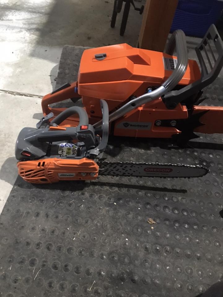

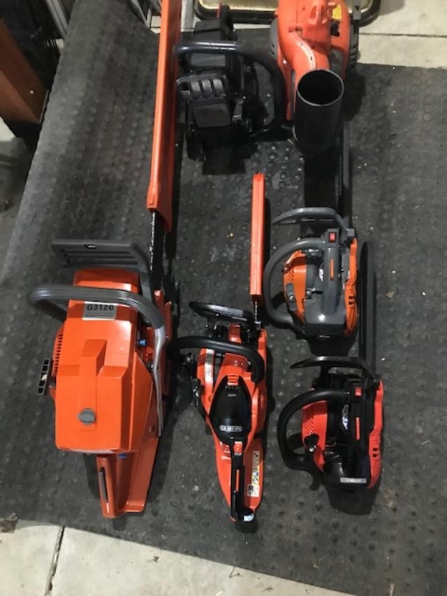

Mix of oem and clone pics of folks in my group and me.

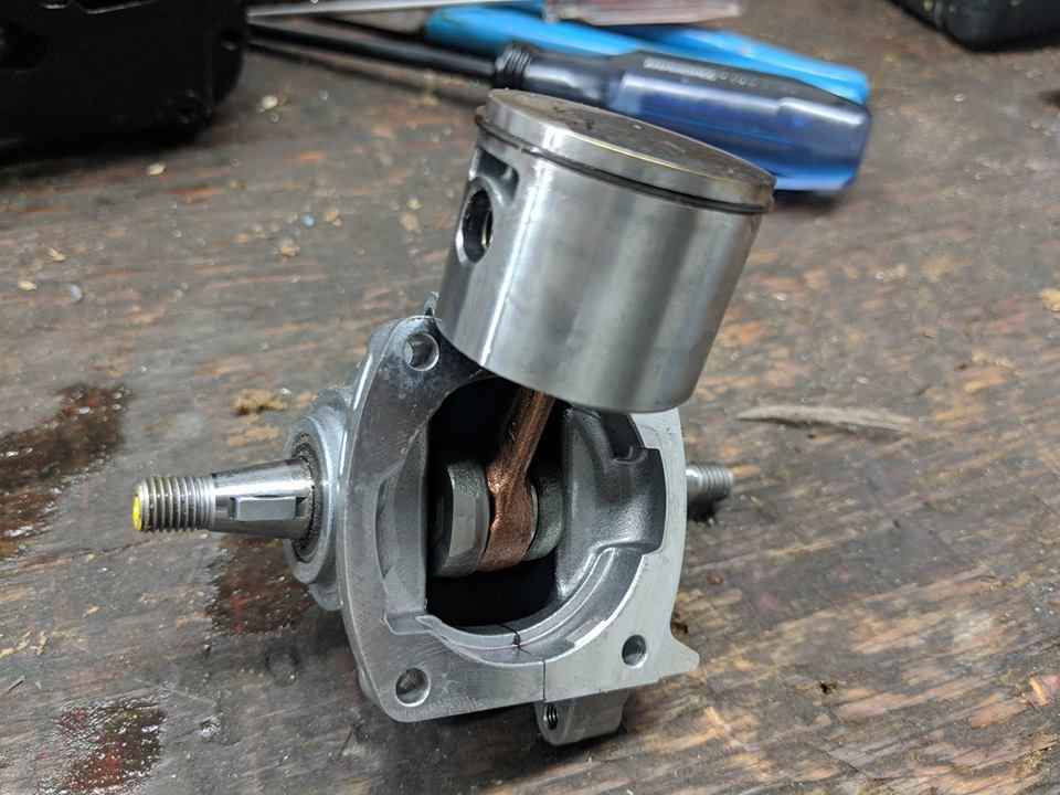

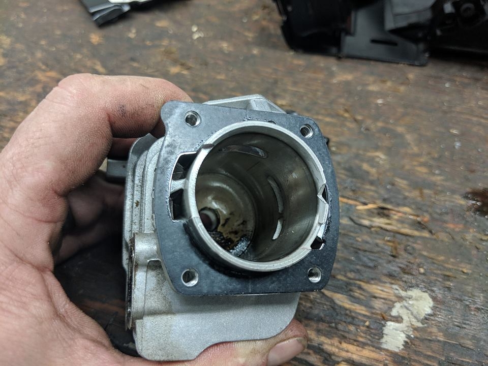

One guy south of me has 3 clones lined up getting ported.
