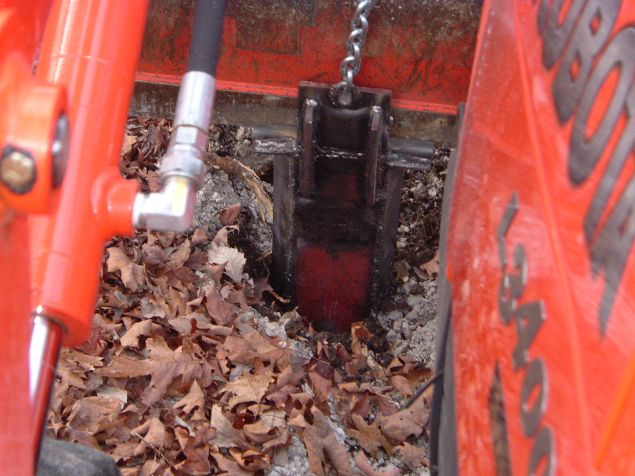

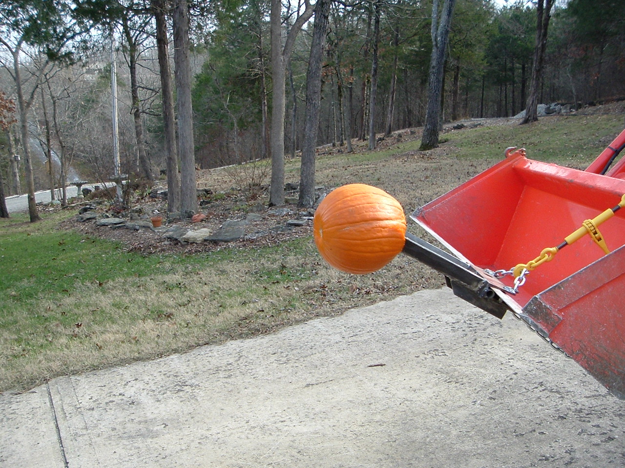

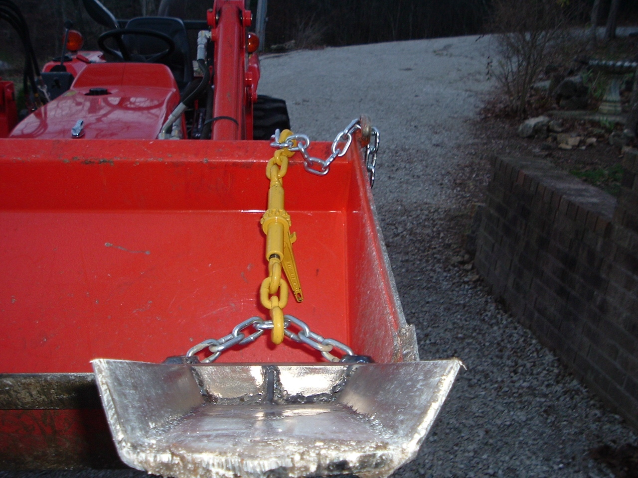

My little home made Shovel works fine for digging up small to medium sized rocks and general trenching/hole digging. I can make a lot of trench in a hurry with it hooked to my Hydrostatic equipped Kioti 35 horsepower tractor. I can also see it perfectly from the seat, and I don't have one of those "pesky" seat switches either. You can read about its design and construction here if you like.
