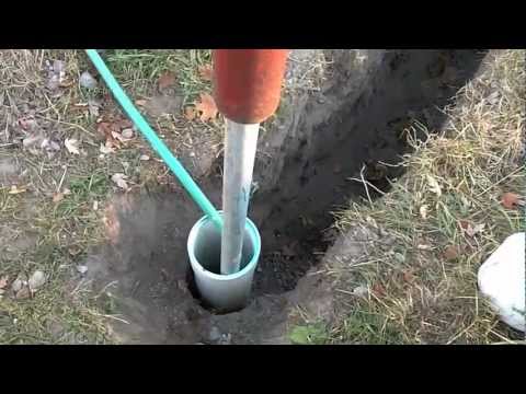

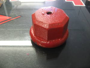

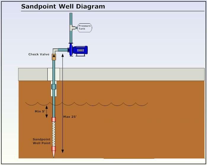

Many years ago I installed a Sand Point Well at our place in the mountains and we have been able to provide all the water we need for our camp. You can buy sand points at Amazon, Lowes and Home Depot (just to name a few places) I purchased a 11/2 diameter point and connecting pipes. They are available in different sizes and I have seen 2 points. You will also have to purchase a point pounding cap and pipe connecting joints. 1
I have mine down about ten feet and have added a check valve at the top of the pipe in the ground prior to running to the pump.
I used a 3 foot section of 11/2 plastic pipe running to the pump and this seems to maintain enough water for when the pump kicks on the water comes without any delay and it never lose the prime.
I guess you could use teflon tape for the joints to seal them, I used plumber's putty to seal my joints, easy to work with and will provide an air tight seal.
Here is one site with some information on installing a Sand Point:
Google Image Result for http://www.ncdhd.org/Images/drivenWell.jpg
