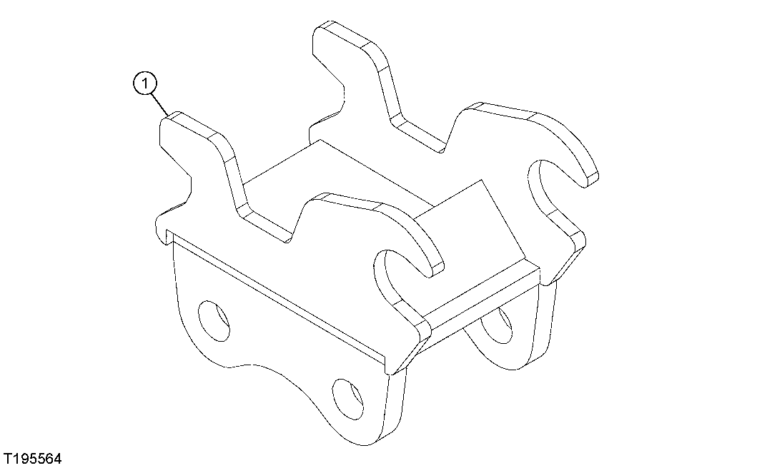

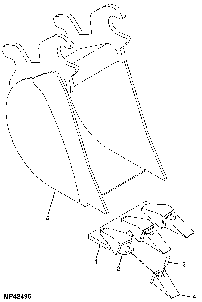

I would love to find the part number and price for the mount that would attach a PA15 Planetary Auger to the backhoe with a QA style bucket.
A drawing of the part would really be spectacular.

Check this out...I can't get a price on it (must be a "whole good") but the part number should be AT305753 (second picture attached)
Also, you could make a cardboard template from your bucket mounts (first picture attached) and have them plasma cut at a local shop-or anybody with a PC.

AT305753 1 IF ADAPTER, HH FOR CEX (NU) 81 $308.00
