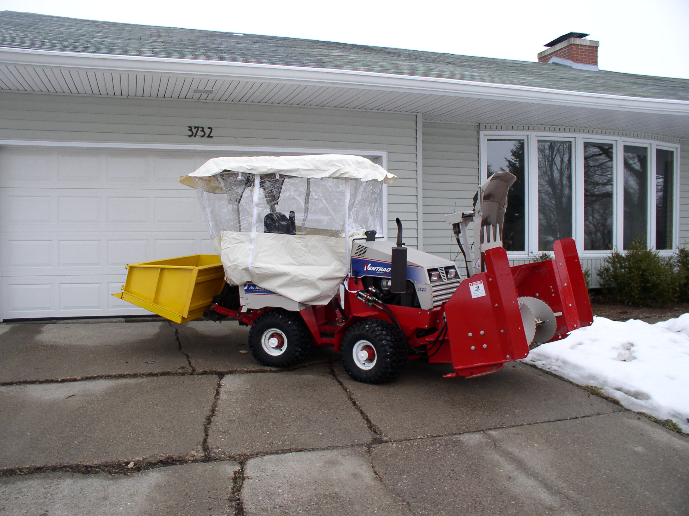

I use the golf cart cover based on the suggestion of another TBN post several years ago. The photo shows it on my Ventrac 4200. It just hangs over the canopy and is tied down at the corners. Cold air does come in from the open front at the bottom, but there is no snow blowing in your face at all. Assuming you already have a canopy, the cover costs less than $100. I got mine from Northern. Portable Generators, Pressure Washers, Heaters, Hand + Power Tools | Northern Tool + Equipment

There may be some differences between 2320 and 2520 as far as cabs go.
I believe Curtis sells one kit for both, but with some different parts or instructions. Someone recently posted a link to the Curtis instructions, which included both tractor models. I'll try to find the link later.
