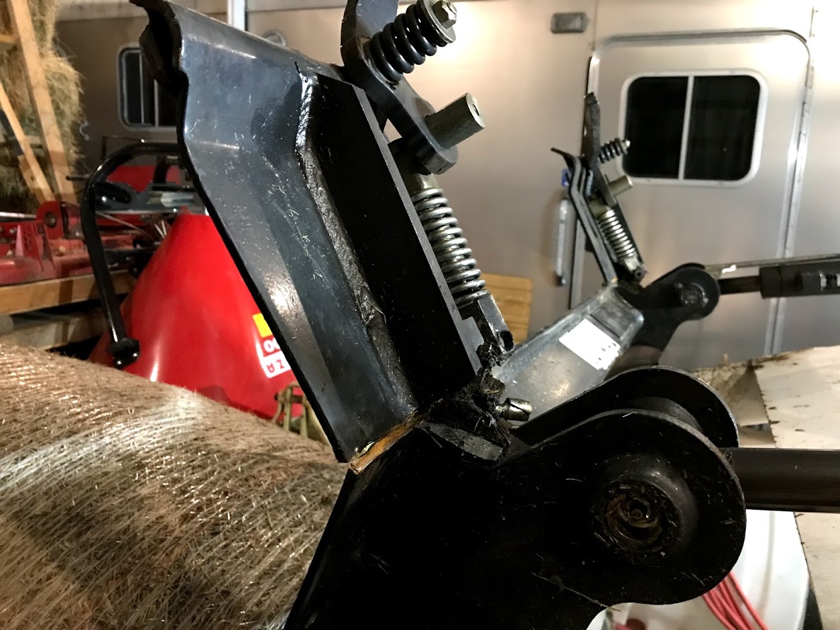

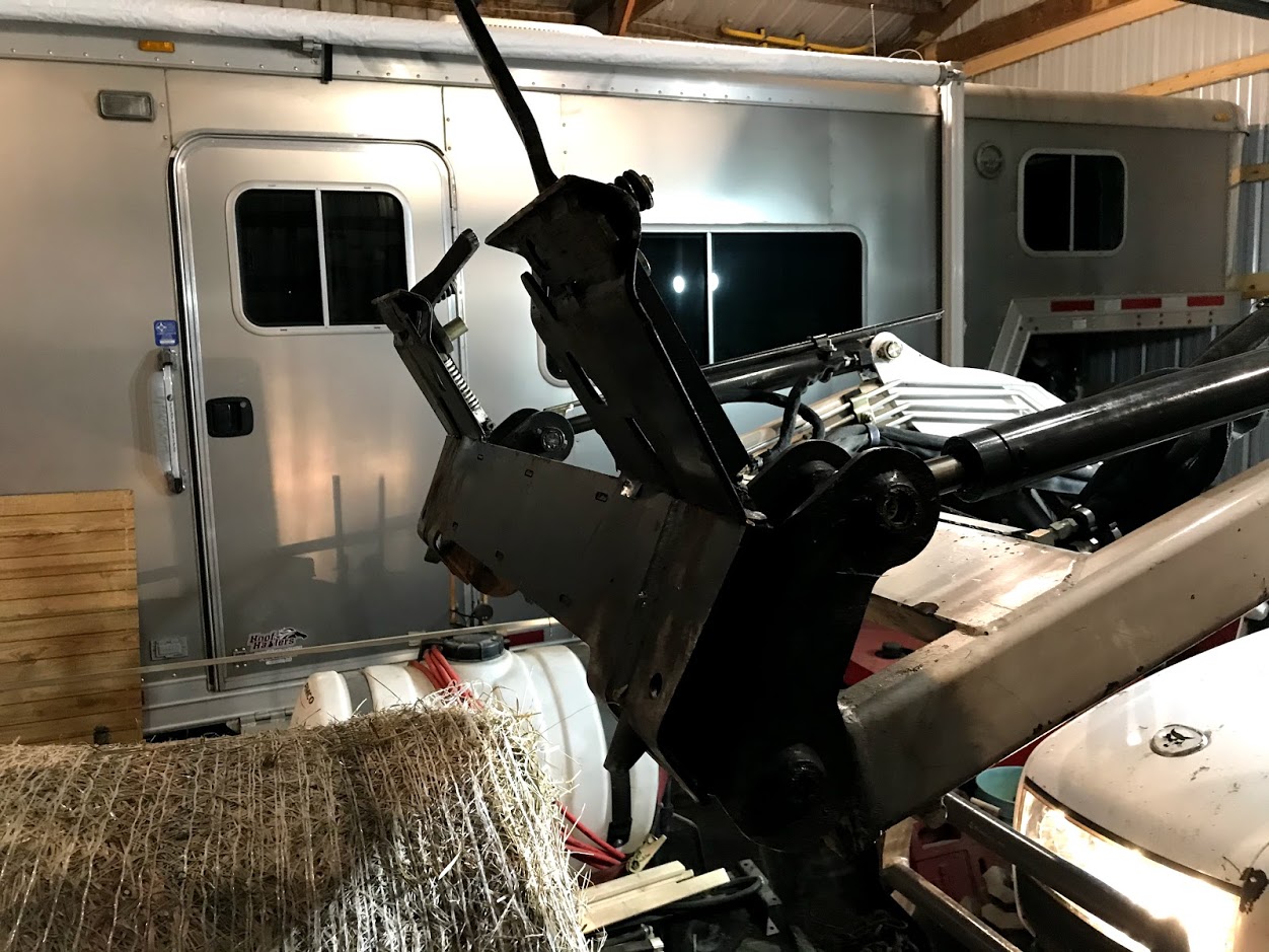

I went to drop the snow bucket and put on the bale spear and this is what I found. This picture was taken after my failed attempt to use it as it was to pick up a bale.
Note the off colored end to the loader arm - that's because a year ago I had one loader arm insert fall completely off and subsequently bent the other.
Not to mention that I broke the loader arm pin on the other side of the quick tach and it completely spread the flange and fell off that arm this past summer.

I may be missing something here. Did that plate bend just from curling/lifting a bale?
If yes, you need, at least, a better tractor.
That looks like a design flaw to me.
The loader should bypass before something like that happens.:eek:

No, The plate bent when pushing snow this past weekend. I didn't even realize and was able to finish the job. Last night I went to drop the snow bucket and the plate was bent.
In fairness to Bobcat I have abused this little tractor. My snow bucket is about 3 times to big - If the snow is wet like it was this weekend I can't always lift it when it's full. I have learned that If I'm driving the bypass for the FEL hydraulics is overridden and I can get more lift. So I can't say I've been good to the tractor. However, the number of failures that I've had with the FEL is a little ridiculous. The weakest link on this tractor is definitely the TL7 FEL.

It's not the brand. Loaders and/or Backhoes are usually made by another company under contract for a certain brand. For instance, Ansung makes loaders and backhoes for various brands.
The way the build that, was kinda prone to failure. That's too much stick out at the top without much support, so it was prone to a fatigue failure.
It can be bent back in place, weld the crack and I would strongly suggest add reinforcement from the top to the bottom with a piece or more, of thick flat stock.

I just got a quote back from Bobcat... $1765. I can do a LOT of welding for $1765!
   / I folded my Quick Tach plate #8
Yeah, I'd be beveling the plates and weld it. It looks like the rib on the backside broke at the edge of the weld too. I would also add a gusset from that back rib to where the top cylinder attaches too. How bad did the ssqa pin mechanism suffer?

That has to be one of the crappiest designed SSQA I have ever seen.
   / I folded my Quick Tach plate #10
I second that opinion. It has "failure" written all over it. For starters, both sides must be one strong integral unit.
I would go as far as saying that design could be dangerous.
