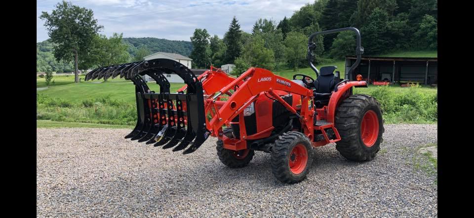

We have several grapples out there on Kubota L4x60 tractors!

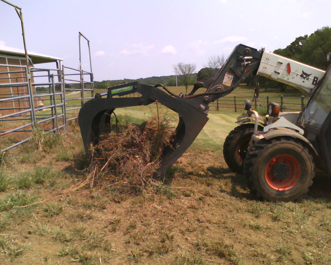

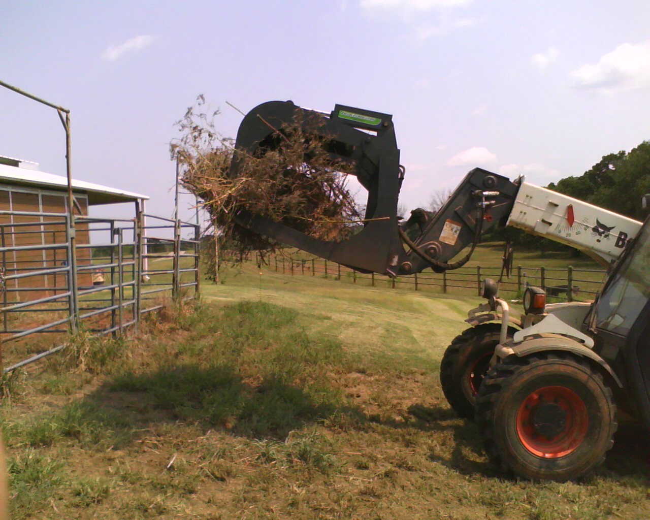

Mine is like Oosik. I still do lots of brush as well. Just clamp down over it instead of trying to scrape and scoop it like a bucket. It works just fine.
That method really works best even for the L shaped grapples like mine. Come down over the top of the brush pile with the grapple opened as wide as it will go and smash the brush so that it packs down and into the mouth of the grapple, then close the mouth of the grapple, lift and curl .
Yep, even works on small brush piles with my L bottom grapple:
