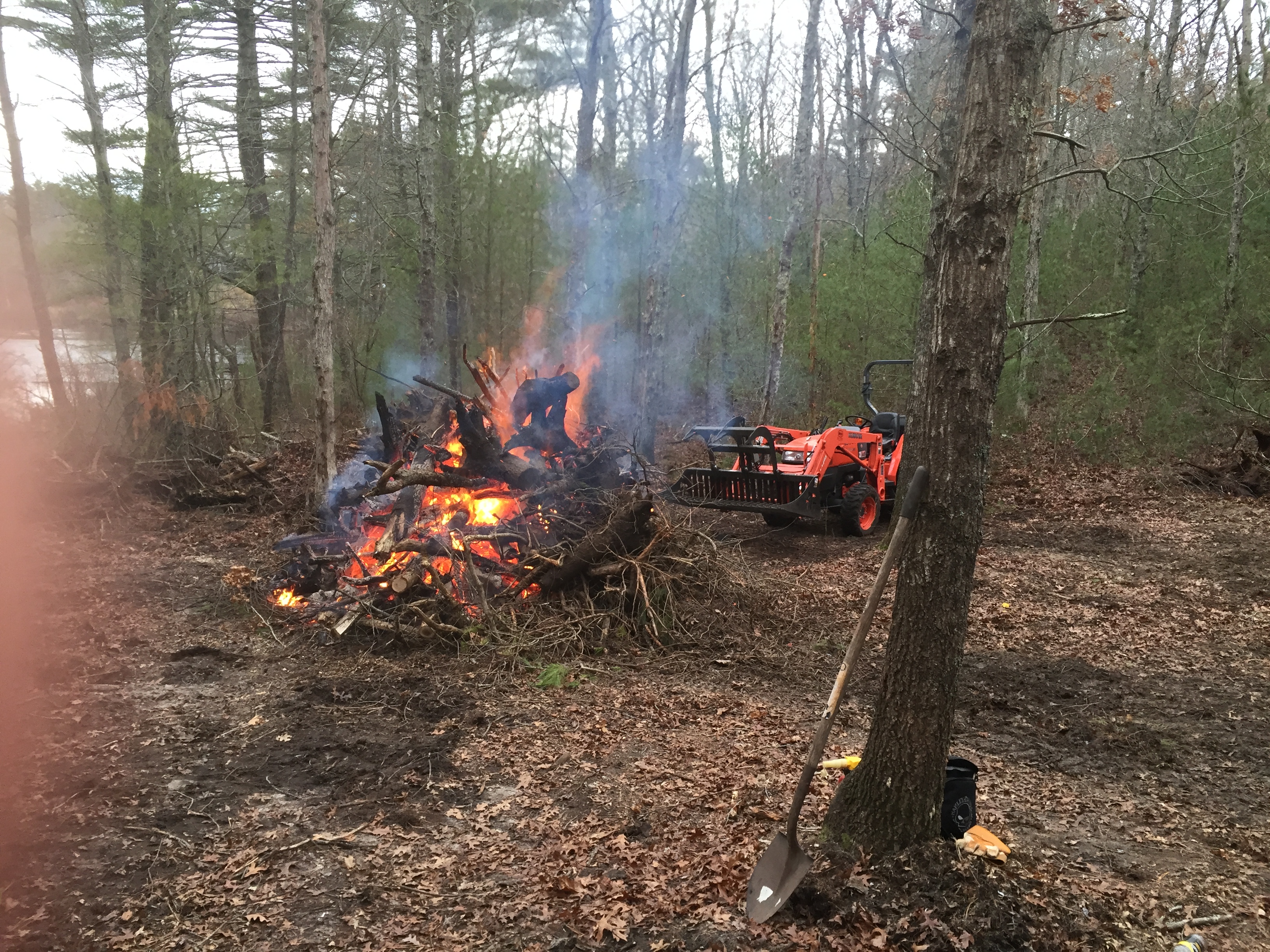

Your tractor has plenty of lifting power to use a heavy duty one , if that痴 your preference. I have a titan single lid with a rock bucket. It has not let me down yet. And it was relatively inexpensive as far as grapples go. I use it for moving piles of tree branches and the subsequent tree logs themselves to bring them to the yearly burn piles.

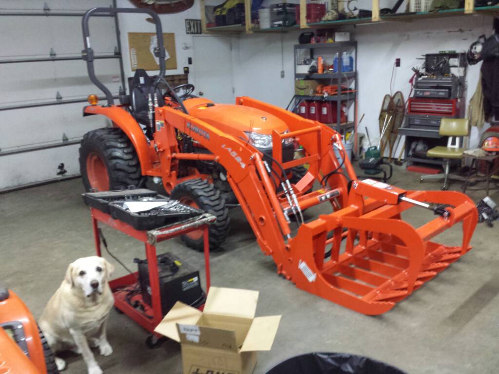

View attachment 587468 I choose a heavy duty rock & root grapple. Got no brush on my 80. See how the grill guard has the added expanded metal. Get a grapple - this added protection is a good idea.
Mine is like Oosik. I still do lots of brush as well. Just clamp down over it instead of trying to scrape and scoop it like a bucket. It works just fine.
