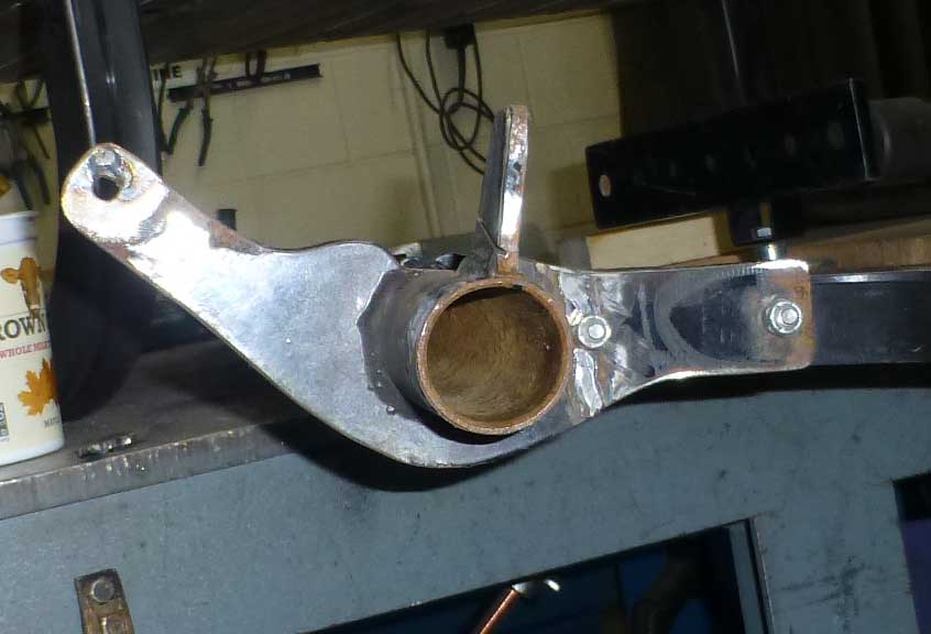

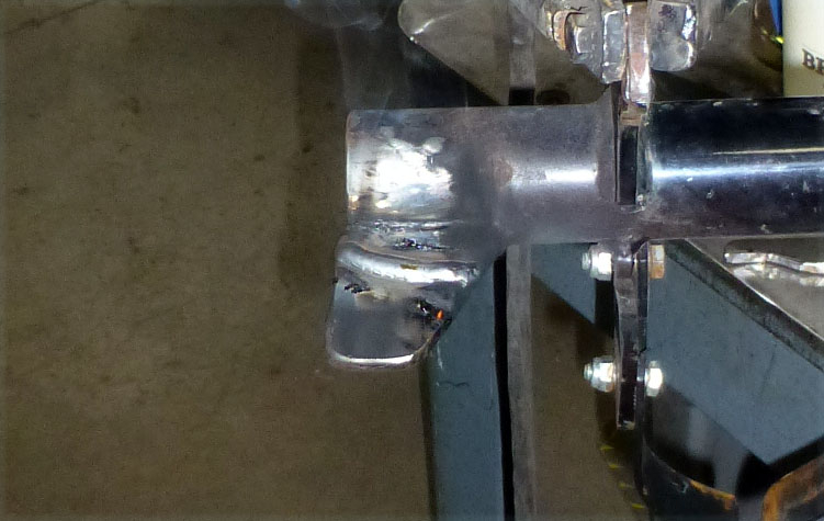

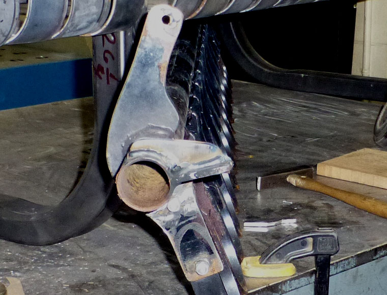

Light materials and heaver, lets say 10 gauge and thicker, are very much different animals to bend or straighten. In the top photo, you can see the cut I made in this 1/4" plate that was bent. The pipe it was welded to was thinner than this stop tab, so I was worried that the pipe might bend when I hammered that 1/4 " tab back. To made sure the tab did the bending, I put a little cut in it seen in the top pic. Then I ran a weld across it after it was straightened as seen in the middle photo. Then I added a backing plate to made sure it wouldn't bend again, seen in the lowest photo. No heating required. This is how I straighten 90% of the steel I'm working with these days. Hope you guys find this helpful. o_O
