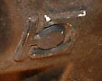

No rush on this, it could be a problem.
Do any of our design, engineering, or other knowledgeable person know if this symbol is representative of any particular manufacturer ??
I had to blow up a few times, but tried to leave it recognisable, it is located on the power plant of a PT.
Thanks for any effort. Bill.

Looks like the number 15 to me
/ I. D. Question #3
Not a # 15. If you look close, it looks sort of like a ball and socket with the ball attached to a plate. I assume it is a company's logo.
Ken
/ I. D. Question
Thanks again JJ, I hadn't realised how much it looked like the number 15.and
Thanks ken for suggesting it is possibly a company Logo, I was thinking along those lines, and that's why I asked if anyone had run into this Logo on their travels.

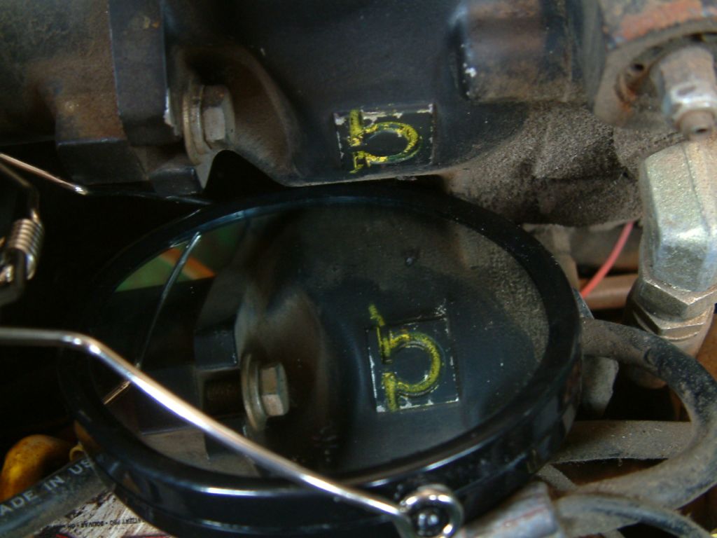

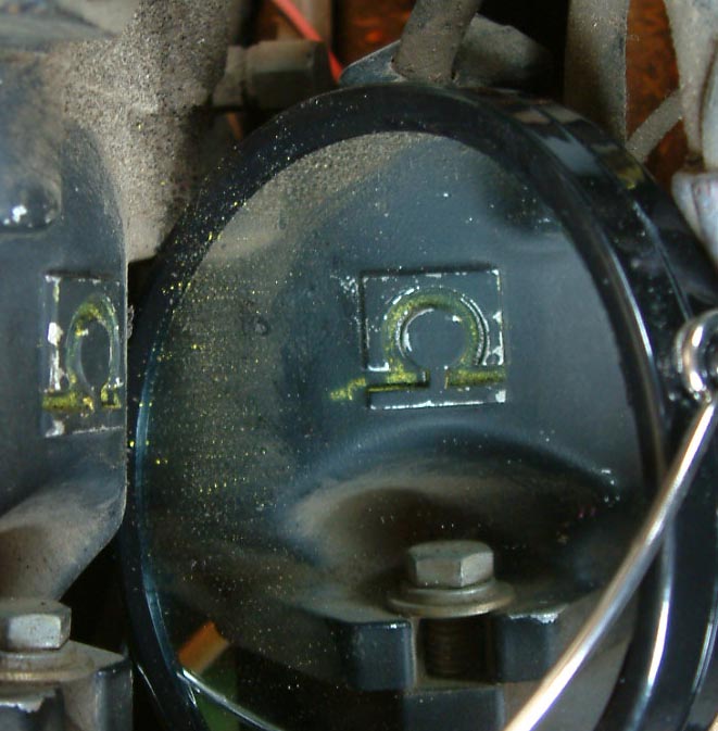

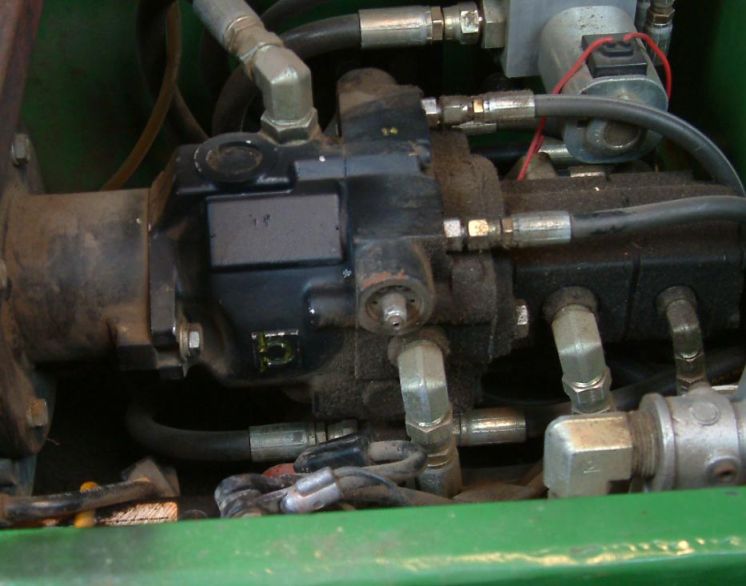

So let's start again, the attached pics show a little better understanding of the reason for my question.
The No 3 file shows that the logo is on the right hand side of the (Variable Volume Pump, part No P124, that is PT's nomenclature on the so called Wheel Motor Circuit diagram), there is an identical Logo same position on the left hand side.
Iwas able to geta better idea of the Logo in the No 2 file picture.
Bill

/ I. D. Question
Now that you know where it is located I hope there may be hope. So far I have not been able to find any V. V. Pumps under the possible title of Omega, I give it a shot every so often. Had the I D plate been left on the flat portion where the #14 was stamped I think it would have been a little easier.
So I'm still hoping that someone has an idea. I use the word Omega because after rotating the picture it appears to be fairly obvious. Thanks to those of you who stepped in to help. No1 file attached
Bill
/ I. D. Question #9
NJ Bill,
I've been doing a lot of research on the INTERNET compiling a list of the OEM's. suppling components and parts to PowerTrac. Here's one for the great PT pump mystery. As far I can tell the pumps are made in Italy. The USA distributor / dealer is in Ashland, VA., almost in powertracs backyard. (well give or take 250 miles :D)
Attached is your pump logo picture and the pictures I came up with.
Try this link Bondioli & Pavesi

/ I. D. Question #11
From what I can tell, PT has used tram pumps from a number of different manufacturers. Old threads indicate some are Eaton, and at least one model used a Sauer-Sundstrand pump. The Bondioli & Pavesi pump makes at least three known brands. There are probably others.
Google reveals there are a number of businesses specializing in hydrostatic transmission and pump repair. They list numerous pump manufacturers on their various web sites.

Which model PT are you talking about. The tram pump on my PT-1445 is an Eaton VSP. The steering and lift pump is a Haldex, and the PTO pump is a Cessna gear pump. My machine is an early 90's model.
