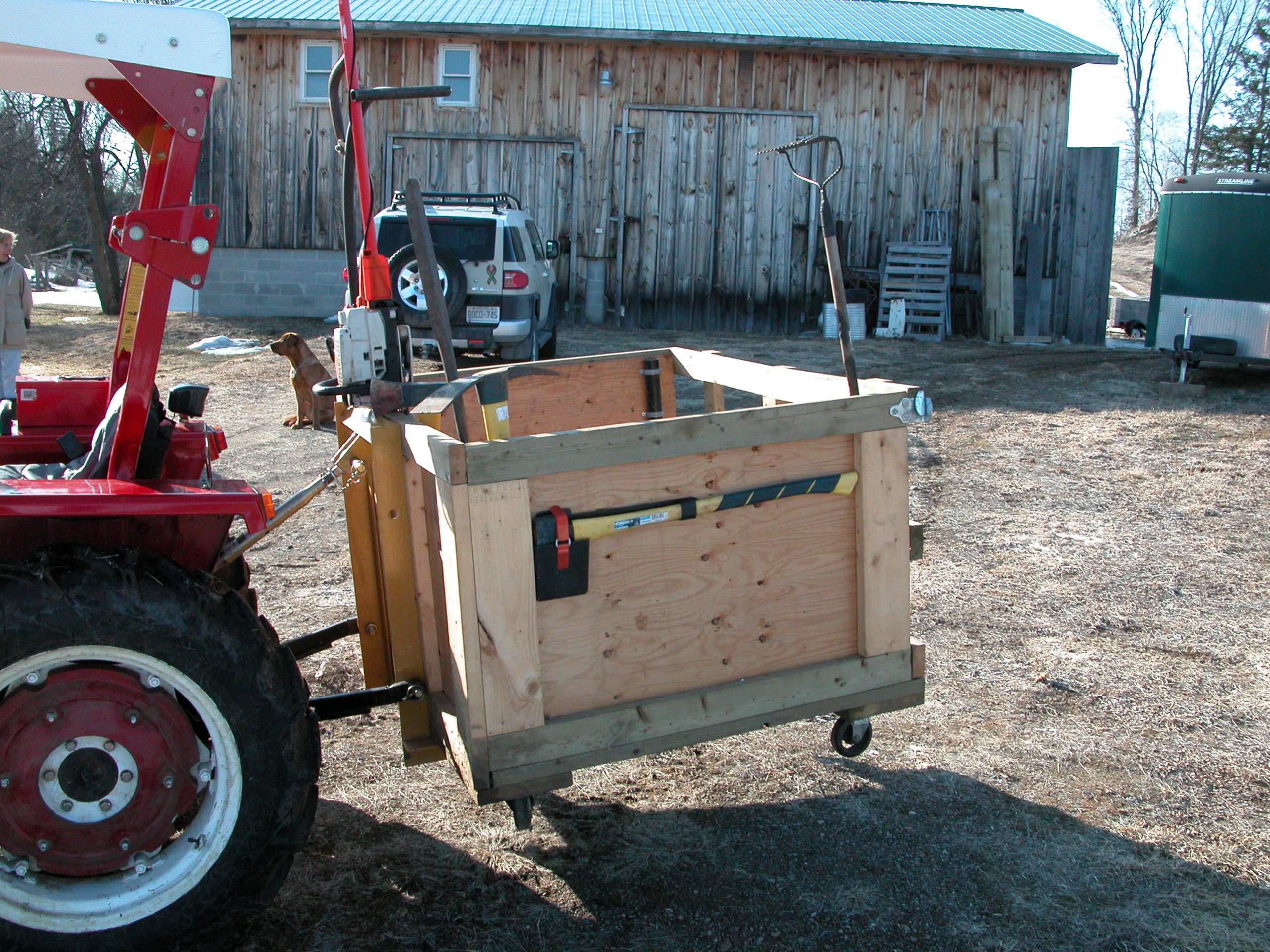

As posted previously, here a a couple of pics of the carryall that "evolved"
regards

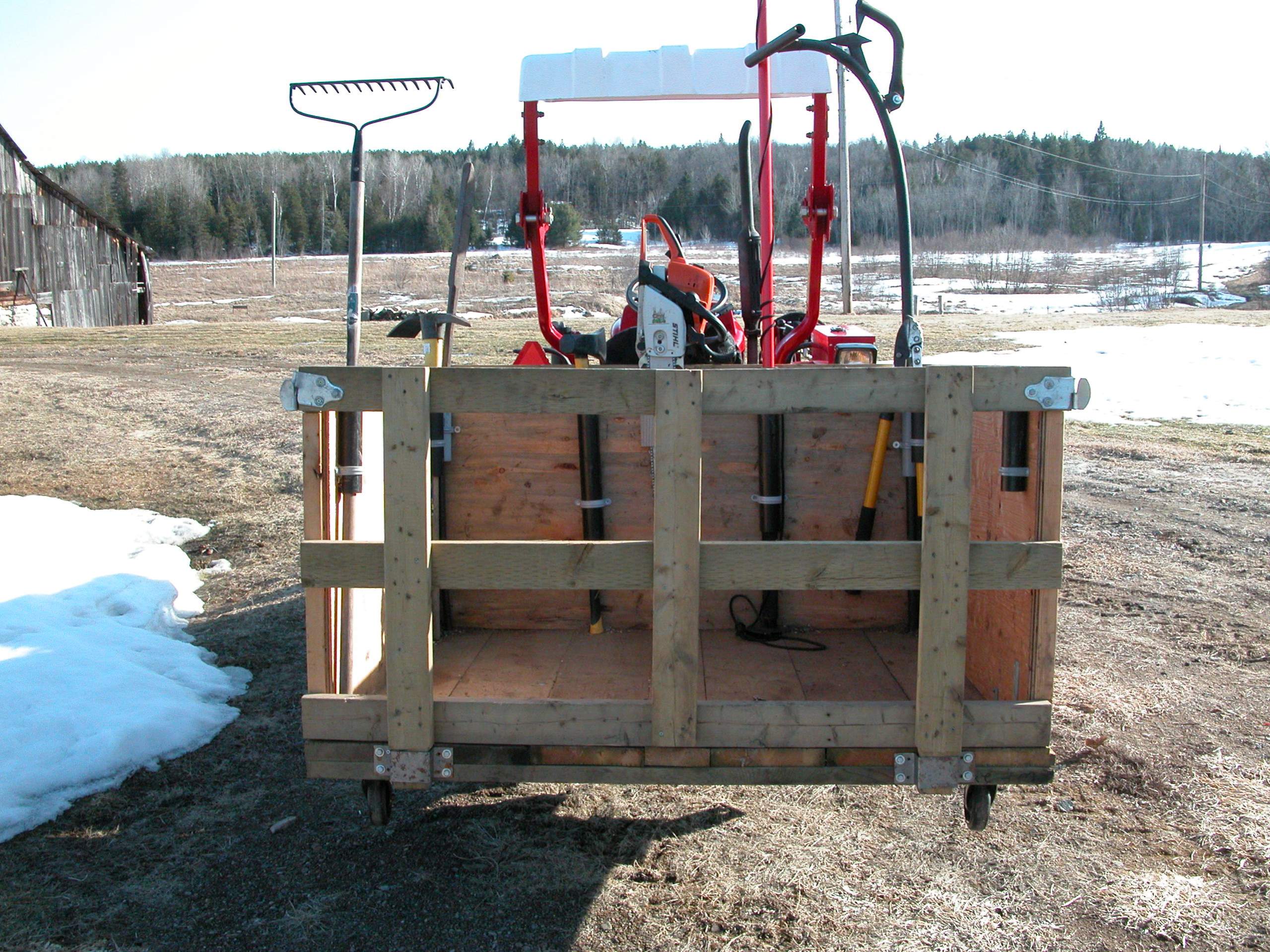

Thanks Scot and JB-- I will try to post some more pictures this weekend
Basically it is a 2"x 8" subframe, decked with 2"x 8" carriage bolted to the carryall frame. The casters are 4" cast iron rubber coated HF jobs. The walls are scrap whatever dimension with 1/2 in plywood centres with the front wall bolted to the carryall frame and the sidewalls anchored with metal L brackets at the front. The gate is just scrap 2" x 4" with rack holders and stake pockets. The tool holders are 1.5 or 2" abs or conduit fastened on with conduit straps. It is 4' x 5' so I can load 4' pieces of wood for later blocking into 16" firewood. I know - a picture is worth a thousand words so I will try and show more detail in the next ones
regards

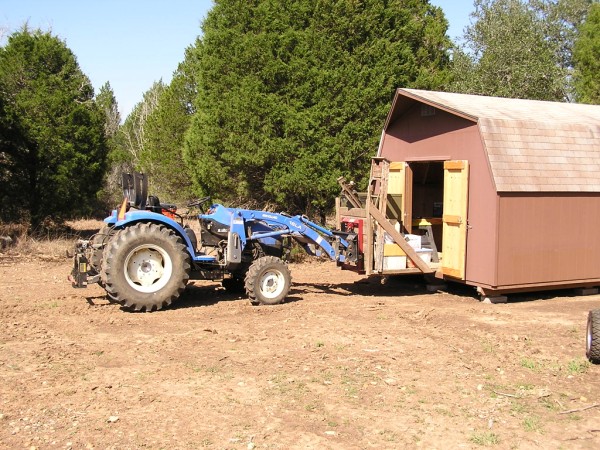

   / I bought the ubiquitous Carry-All #26
here's mine -- I use it primarily for moving things from the truck to the barn to the shed - and it works really well .....love my quick attaches...
