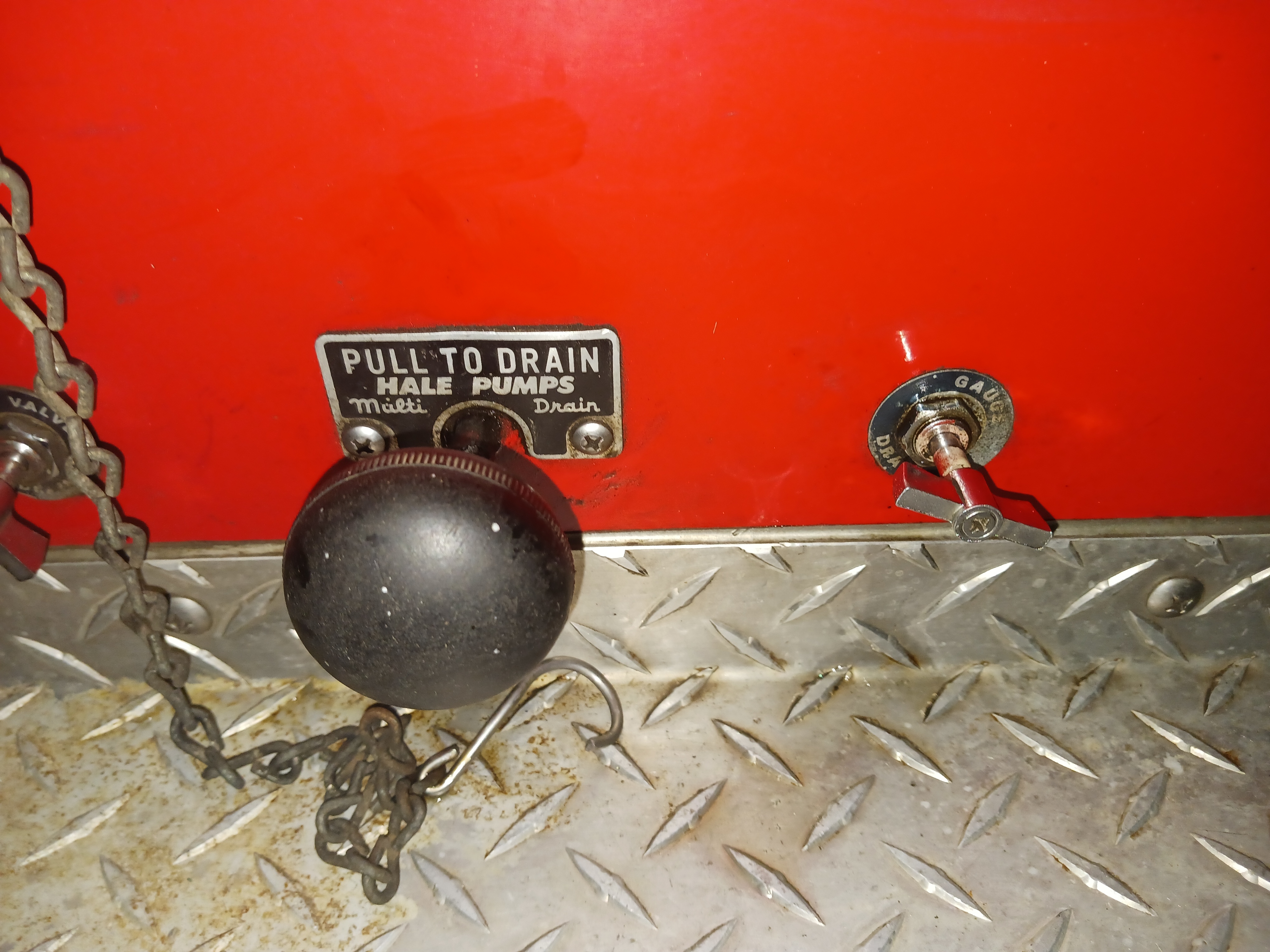

So thanks a lot everyone!! I'll try and get into everyone's responses here with a few questions and answers.
Yes, unfortunately it won't be in a heated building this winter as I tried all summer to get someone here to build and all I got was promises and no-shows.
So we pumped tank off, then when I got home I opened these two valves...one says pumps multi-drain and the other is the gauge drain. Lots of water came out both.
Is there anything else I'm missing? Should I leave any other valves open or pull plugs out of anything, or blow all the gauges out?

I would be happy to help out with any questions you may have.
To start off, do NOT run the pump for an extended period without water actually flowing (either out of a discharge, or recirculating to the tank). It will burn up the pump.
That is a sweet looking engine!
So when the fire chief and I pumped the tank off, he told me to open both these two valves I circled BEFORE I engage the PTO.
I know how to engage the PTO and use "Drive" on the transmission once engaged.
Anything else?

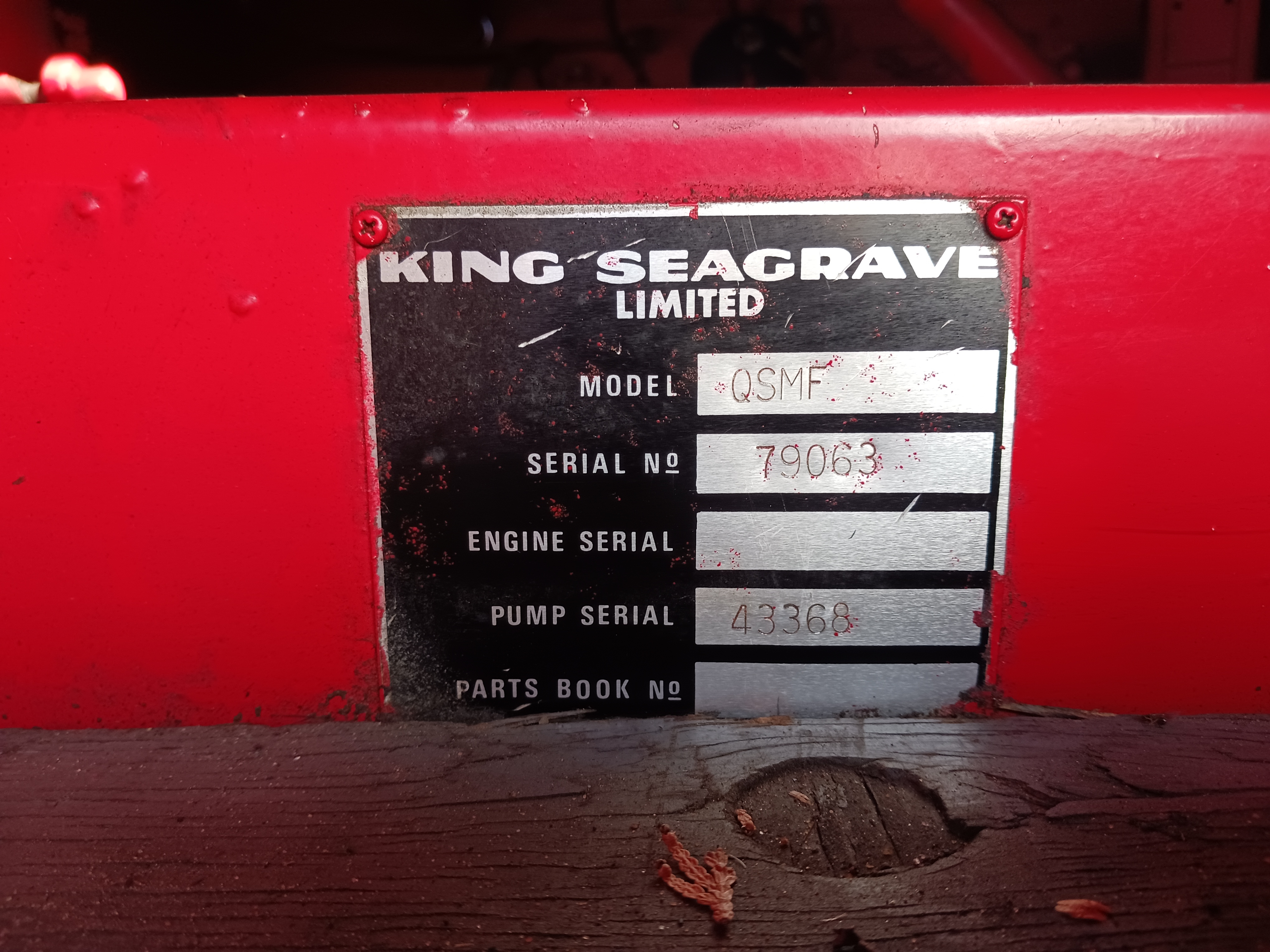

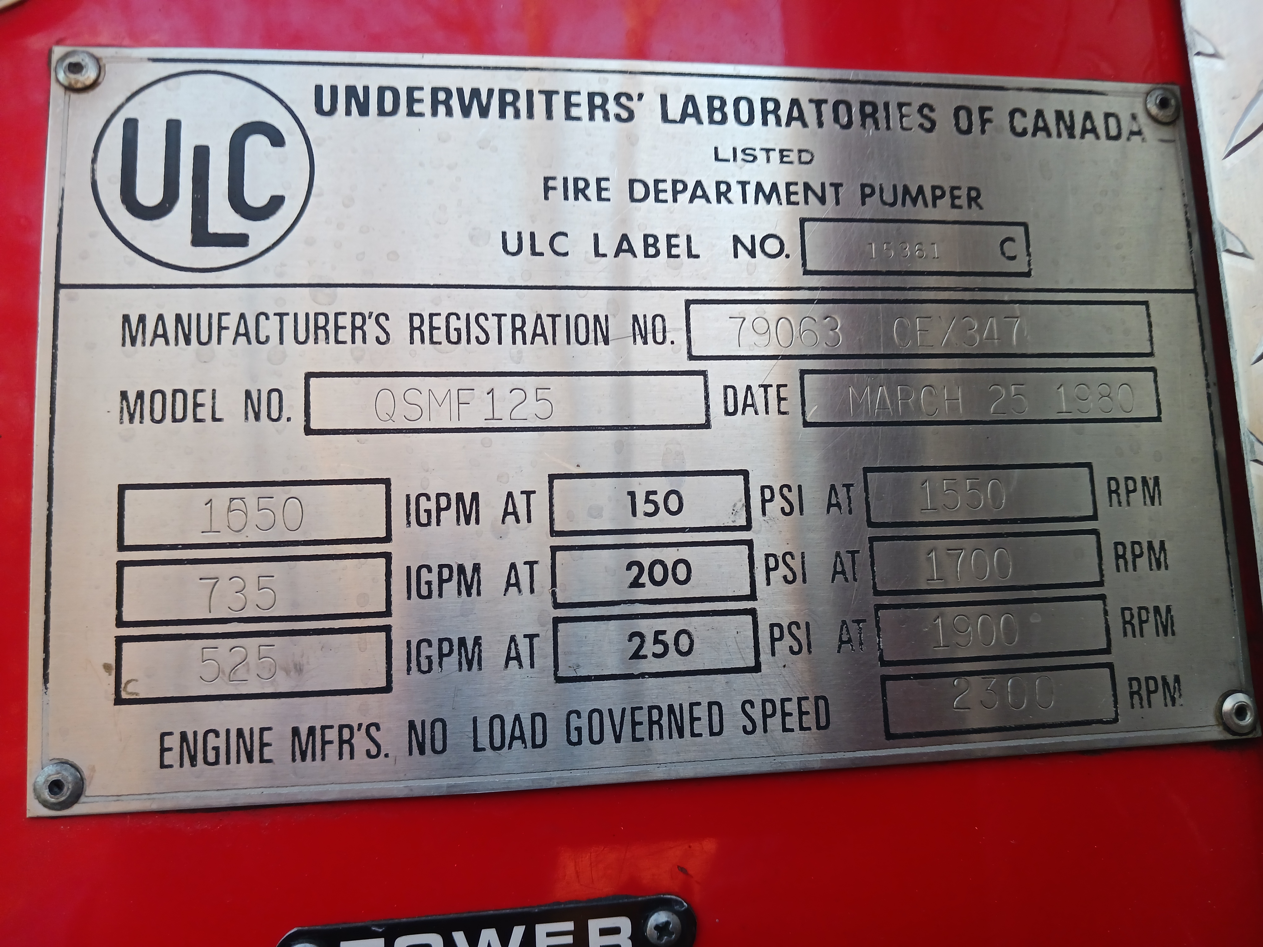

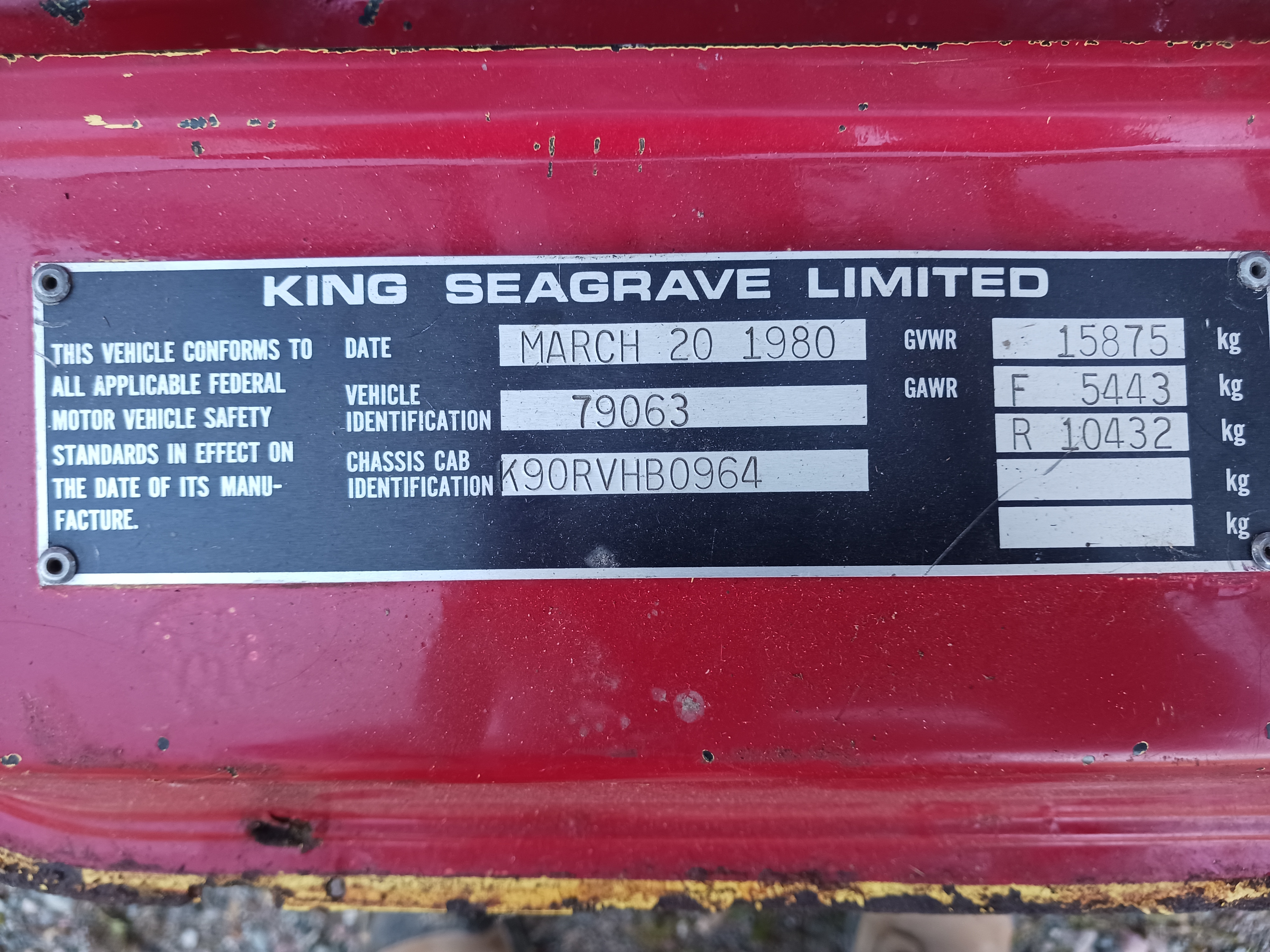

Here is all the tags I could find so far.
