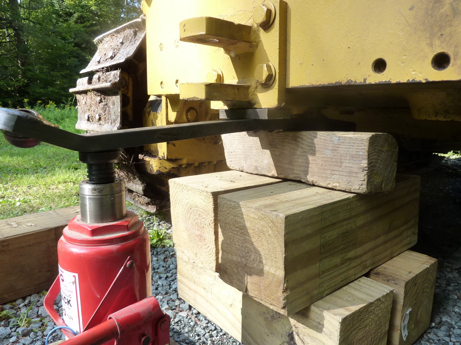

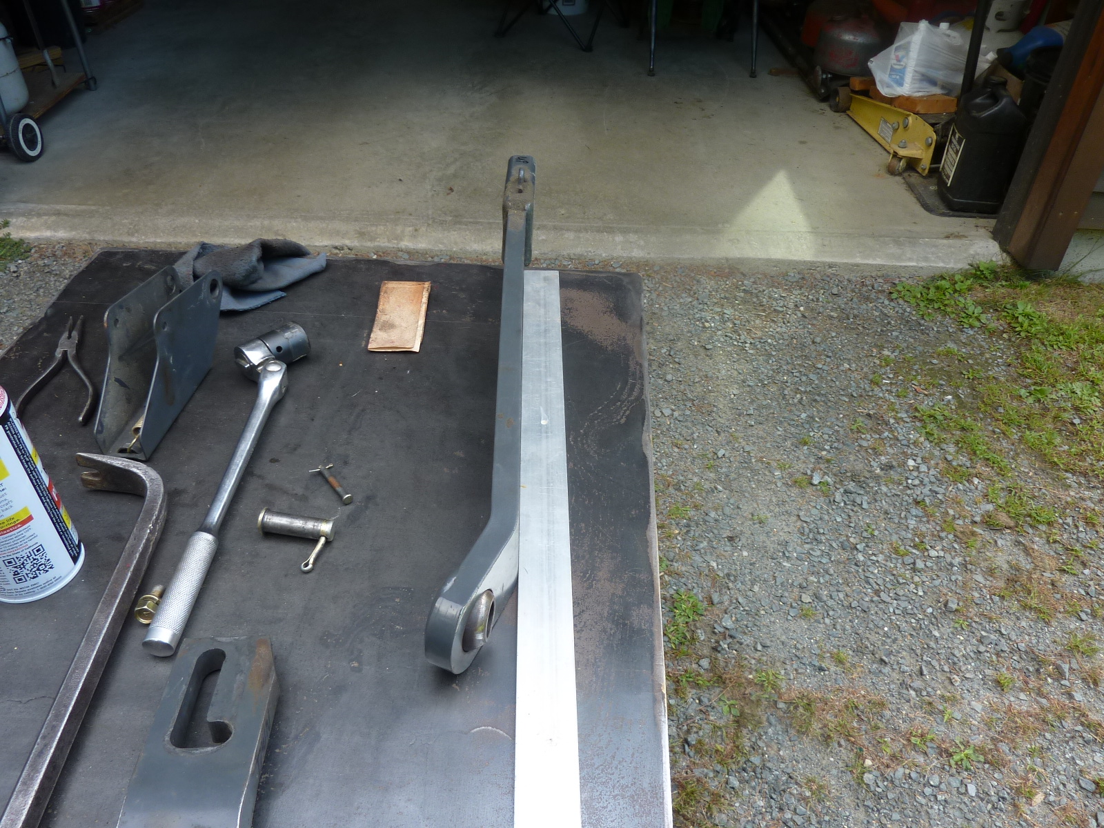

I bent my pull arm on my ford 1720 3-point hitch. Not much about 1 1/2 inch in to the center. It's still flat, just takes a turn to the left. I had a 3-point back hoe on it that I had just got, and I must have put some side pressure on it or something. But when I took it off after the first time I used it, I saw that I bent my right side pull arm on the 3 point. Now I'm building an underframe for the hoe, so it won't happen again. But I still want to straighten the 3-point arm. How should I bend it back? That steel is realy hard and I'm wondering if I should press it back to straight cold or if it would work better if I heat it up. If I heat it up will I have to re- temper the steel? If so, how would I do the tempering? I'm looking for some input and opinions on this.

I bent my 3pt lift arm a few inches from straight. I used a log splitter with something covering the sharp edge. Then I used a 5" angle iron I had laying around to use as a backstop to push against. Could have used a 4' 8x8 timber. Worked like a charm.

Bend it cold.

I bent one arm on my 1920.
Just pressed it out straight .... cold.
Bought a new one just to be sure (they are not expensive).

Just find something heavy and get a 20 or so jack ton jack. That's what I did any hoo.

Find somebody with a shop press.

Ya, I'm getting the idea that I should bend it back cold. I can do that. I have a twenty ton shop press and a log splitter. And now that I'v done some research, I'm building a sub frame to mount the hoe to it and then attach it to my tractor. I'm also cutting the bucket narrower too. Thanks to everyone that replied.
